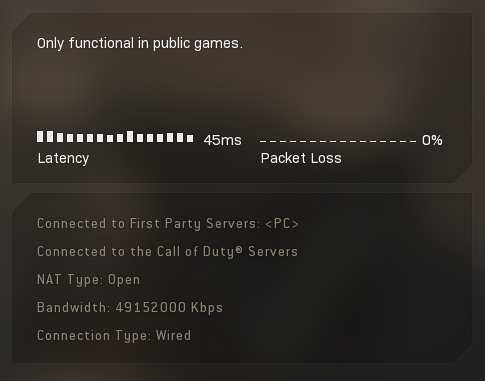

BrownStar Posted February 26, 2022 Author Posted February 26, 2022 This is not a picture of mine only because I’m not at home but trying to clarify. Imagine that sequence being around 19-21ms instead of the 45ms shown in this picture and then 5-7 of those bars raise and lower (21ms, 75, 150, 300, 150, 75, back to 21ms). Sometime it even shoots up in the 500-600ms range and it’s constant about every 4-5 seconds A2737EE1-9041-4011-BC5E-5FE3D07F664B.webp
