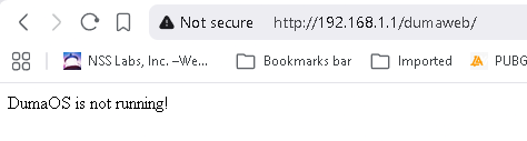

LordZiyad Posted December 9, 2023 Posted December 9, 2023 XR 500 stuck in this loop- what steps do I need to take to resolve?
Administrators Netduma Fraser Posted December 9, 2023 Author Administrators Posted December 9, 2023 46 minutes ago, LordZiyad said: XR 500 stuck in this loop- what steps do I need to take to resolve? What firmware version are you on? Did you do the reboot as it suggested? If so did you close the tab and wait 4 minutes before accessing? If not please try that
LordZiyad Posted December 9, 2023 Posted December 9, 2023 I waited the prescribed time and didn’t come up. Did a factory reset and now get a message “ Duma Os not running”.
Administrators Netduma Fraser Posted December 9, 2023 Author Administrators Posted December 9, 2023 27 minutes ago, LordZiyad said: I waited the prescribed time and didn’t come up. Did a factory reset and now get a message “ Duma Os not running”. You'll definitely need a reboot for that. Otherwise, access routerlogin.net/adv_index.htm and re-install the firmware version you're on, close the tab, wait 4 minutes then access. What firmware version are you on?

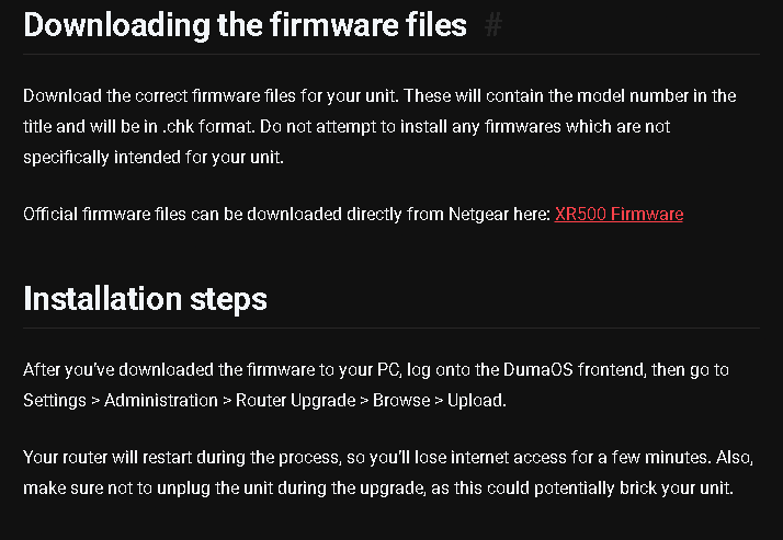

LordZiyad Posted December 10, 2023 Posted December 10, 2023 It loaded for me last night and It currently states this version below. So now i go ahead and follow the steps from the youtube vid?
Administrators Netduma Fraser Posted December 10, 2023 Author Administrators Posted December 10, 2023 4 hours ago, LordZiyad said: It loaded for me last night and It currently states this version below. So now i go ahead and follow the steps from the youtube vid? Follow the steps from the first post in the link above and that'll get you updated to the beta
