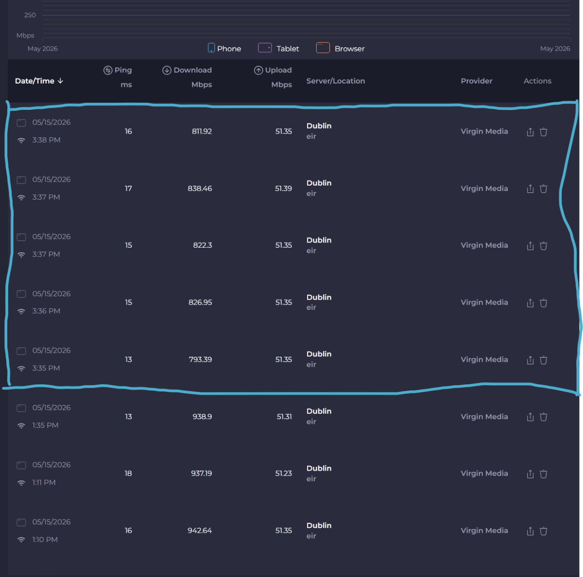

Just wanted to inquire for some insight. I've recently needed to revert to the prior firmware version 1.0.2.82 from 1.0.2.86. It was depressing my performance significantly. I've made the same configuration on the prior fw. I get 1gbps and on the latest firmware I was getting depressed to 500mbps.
Upon reversion, I am not getting fully what ISP router provides. 932-950mbps on ISP router via ethernet & maximally 820 via XR1000. I wonder if there's a particular advise you might be able provide? I'm happy to advise on any settings I have currently. With the understanding from the router speed analyster over 800 will present innacurately but shouldn't a speedtest be unaffected by this?

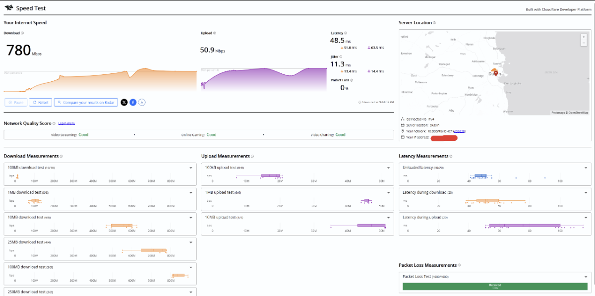

I just wanted to offer some additonal evidence for my issue:

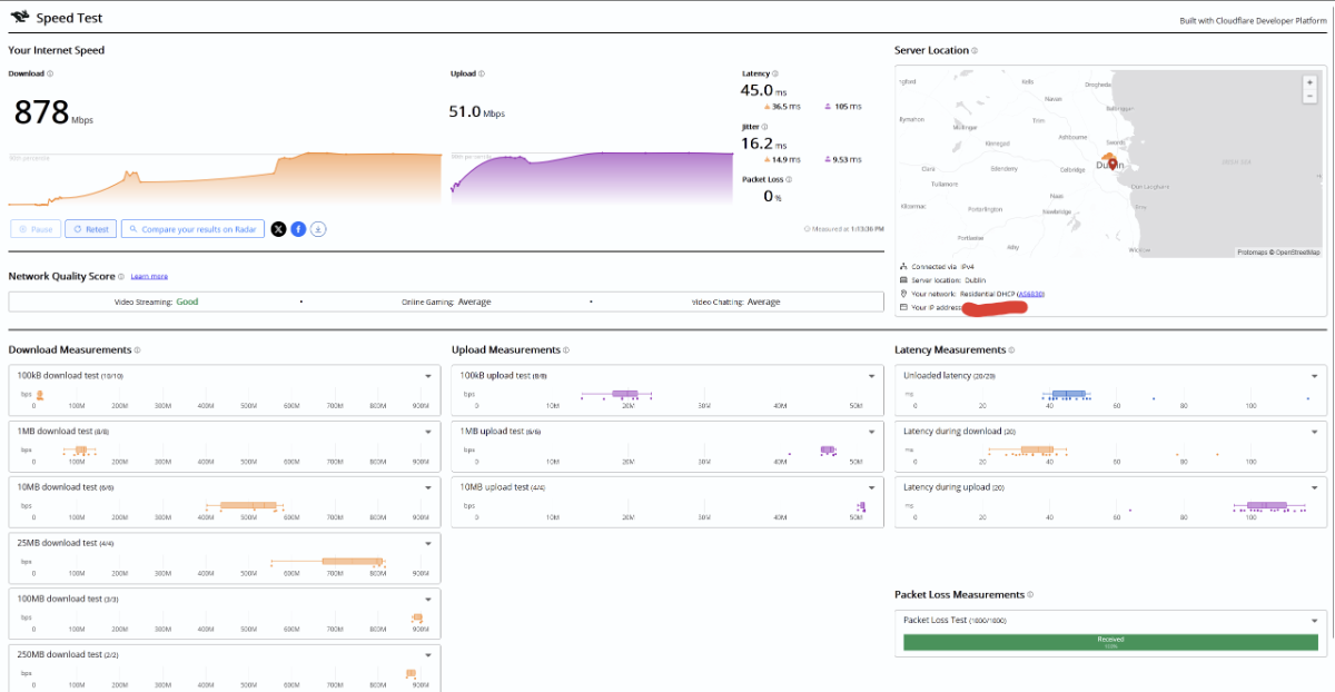

Here's a speedtest from speed.cloudflare:

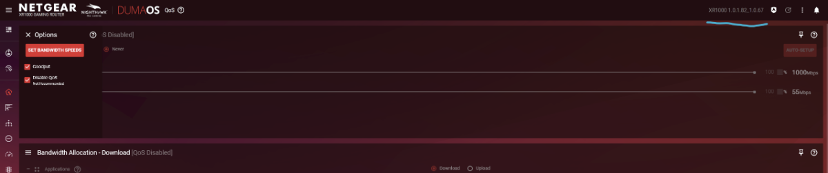

Since the factory rest & viewing other articles on the forum I've since set nat filtering to open & configured my DNS (1.1.1.1 & 1.0.0.1) so here's some screenshots from DumaOS:
I have QoS disabled for now so nothing extraneous would be limiting performance, I guess. Appreciate guidance on this matter. I've seen naterings of a beta firmware. I wonder if this would assist my issues without having to roll back.

You'll note that here I have improved overall speed at 633 but RTT latencies don't seem ideal & it's still depressed in comparison to 1.0.2.82.

Disable QoS in the Congestion Control menu :menu fully and then re-test the speed.

You need to click the :menu icon top left of the Congestion Control panel and there is an option that disables QoS fully

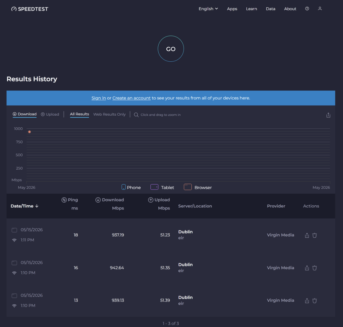

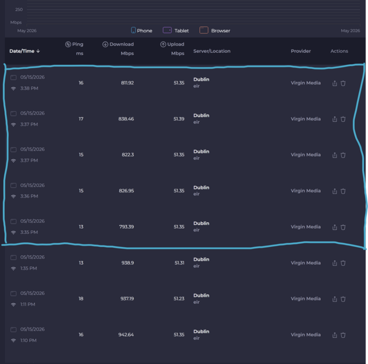

I just wanted to add here to see if there's any final recommendation or path forward. I've reverted again to the prior .82 firmware & configured the same as previous with QoS fully disabled & get the following results:
I guess it's not so much to confound more but just to ask is there any route forward for QoS being enabled? I bought this router for these features specifically but right now there doesn't seem to be much reason to use the XR in place of the ISP router, solely. I'm not sure how much of a heightened risk I may be at for the lack of security patching. Thanks again Fraser for all the recommendations/advise up until now.
  • Administrators
Posted

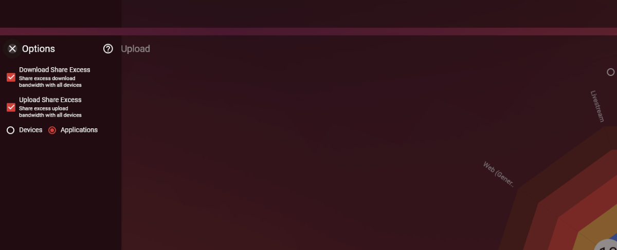

Okay so speedtest.net results look like they're where they should be so that's good. Now re-enable QoS, keep Congestion Control at 100% & Never. Reset bandwidth allocation - click the button anyway even if its equal. Ensure share excess is enabled for Bandwidth Allocation in its menu :menu (it is by default). Ensure you don't have any manual rules added to Traffic Prioritization. Then do speedtest.net again, what speeds do you get?

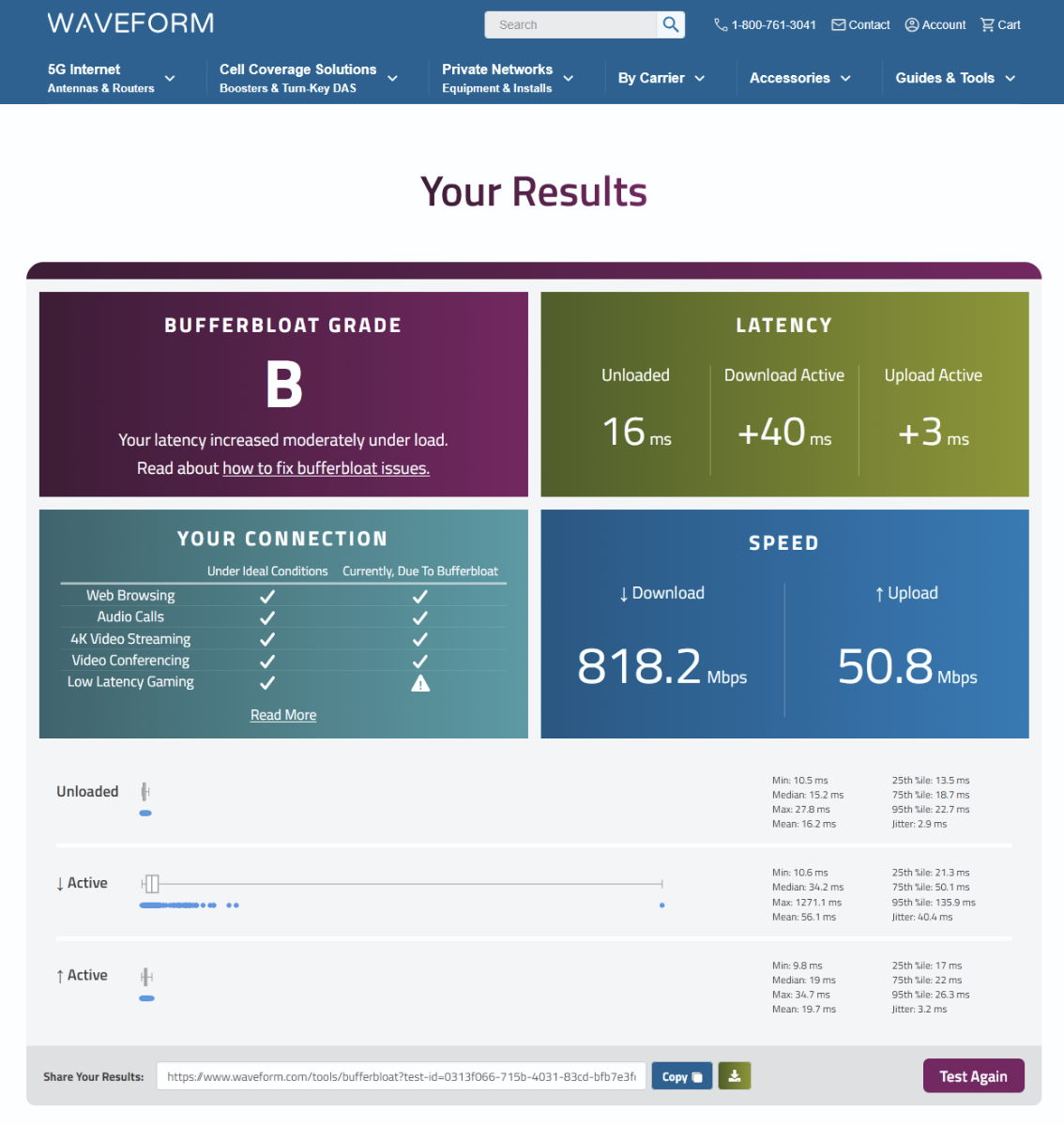

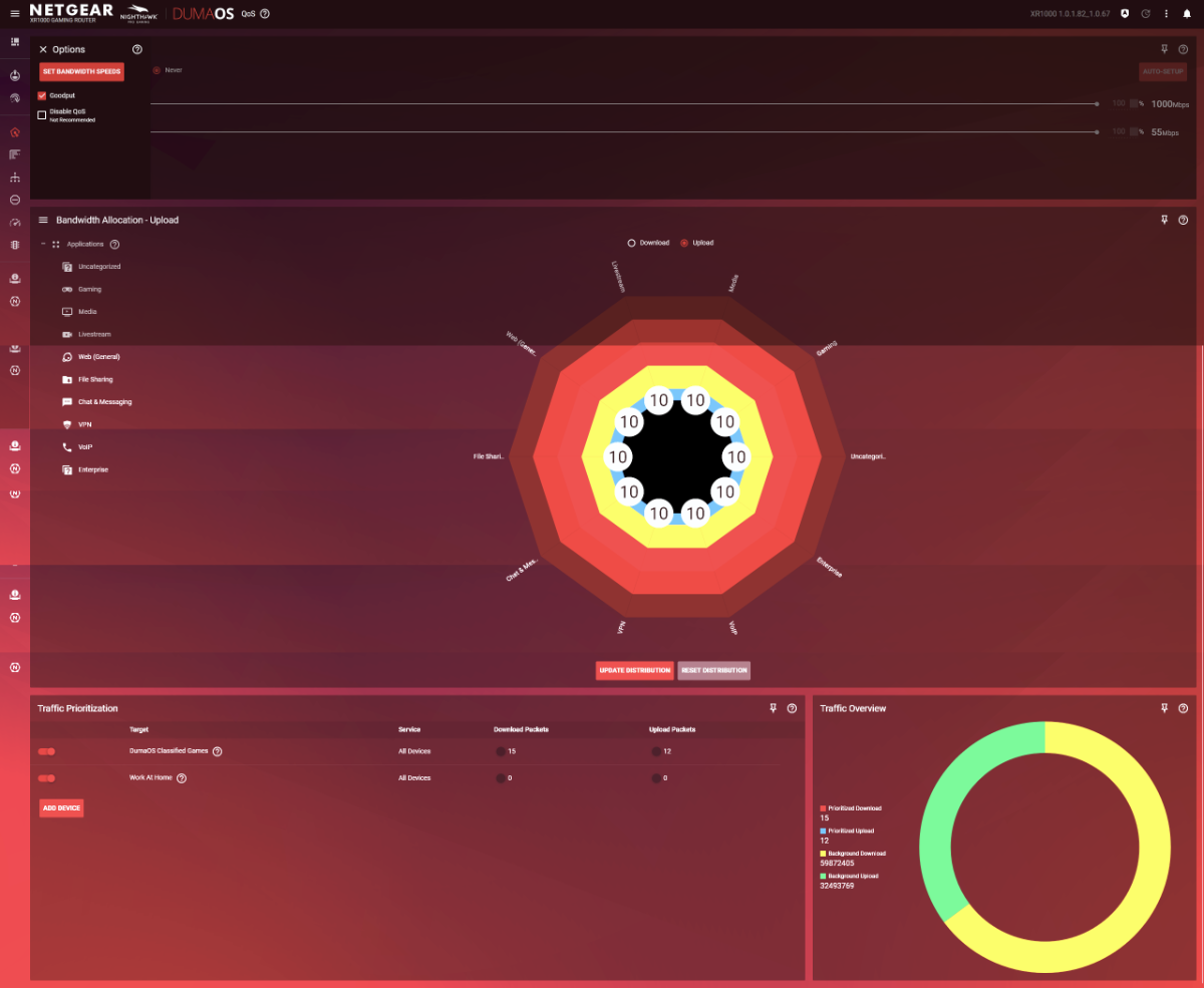

Switched QoS back on, reset distributions for download && upload. Only traffic prio is defaults as pictured (snagit artifacts with HDR capture):
Defiitely the best result with QoS on so far from speedtest.net:
Waveform Bufferbloat loaded ping has doubled though:
So still depressed slightly. Seems somewhat contradictory. I'm not sure what results are best to rely on.

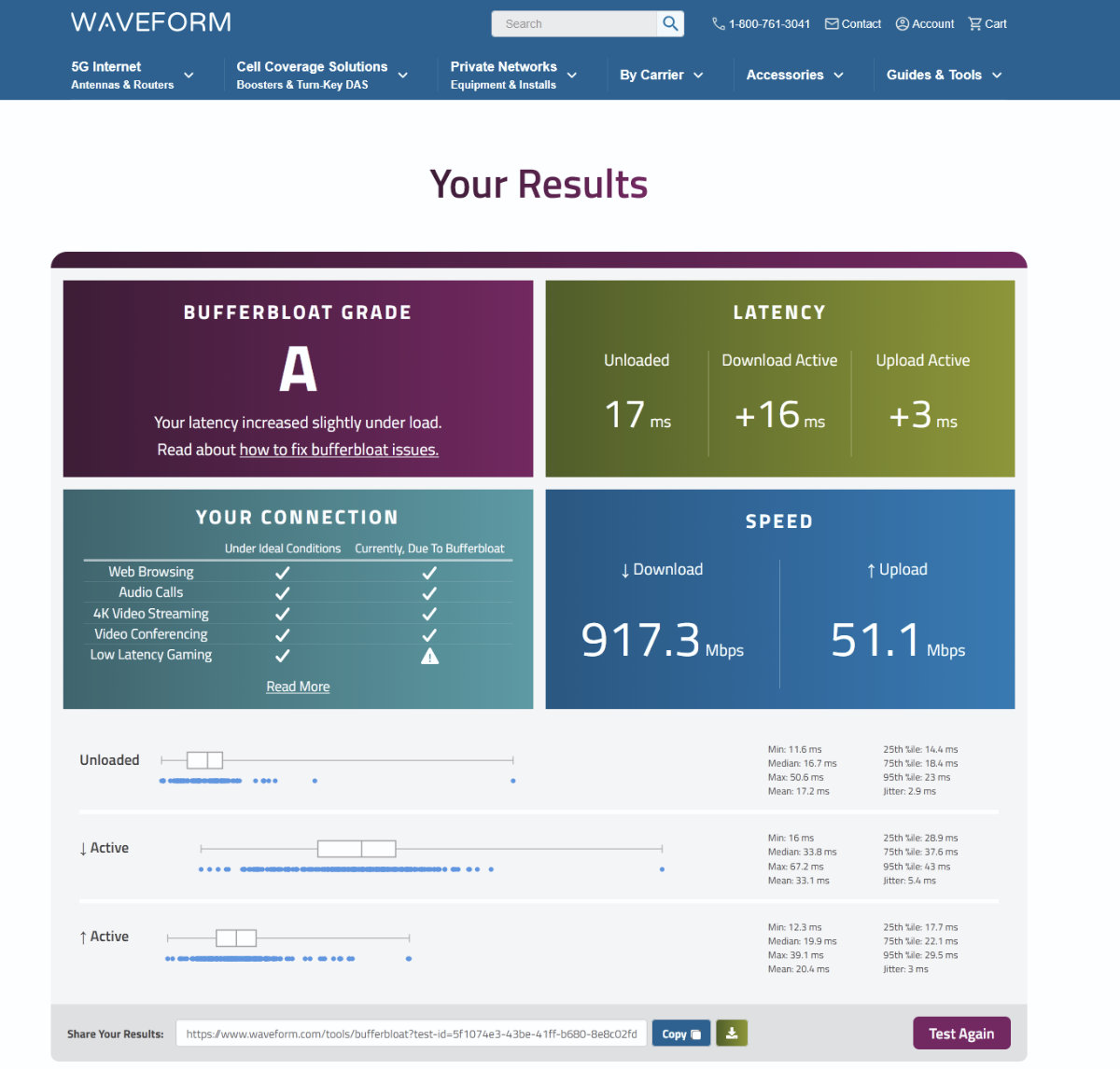

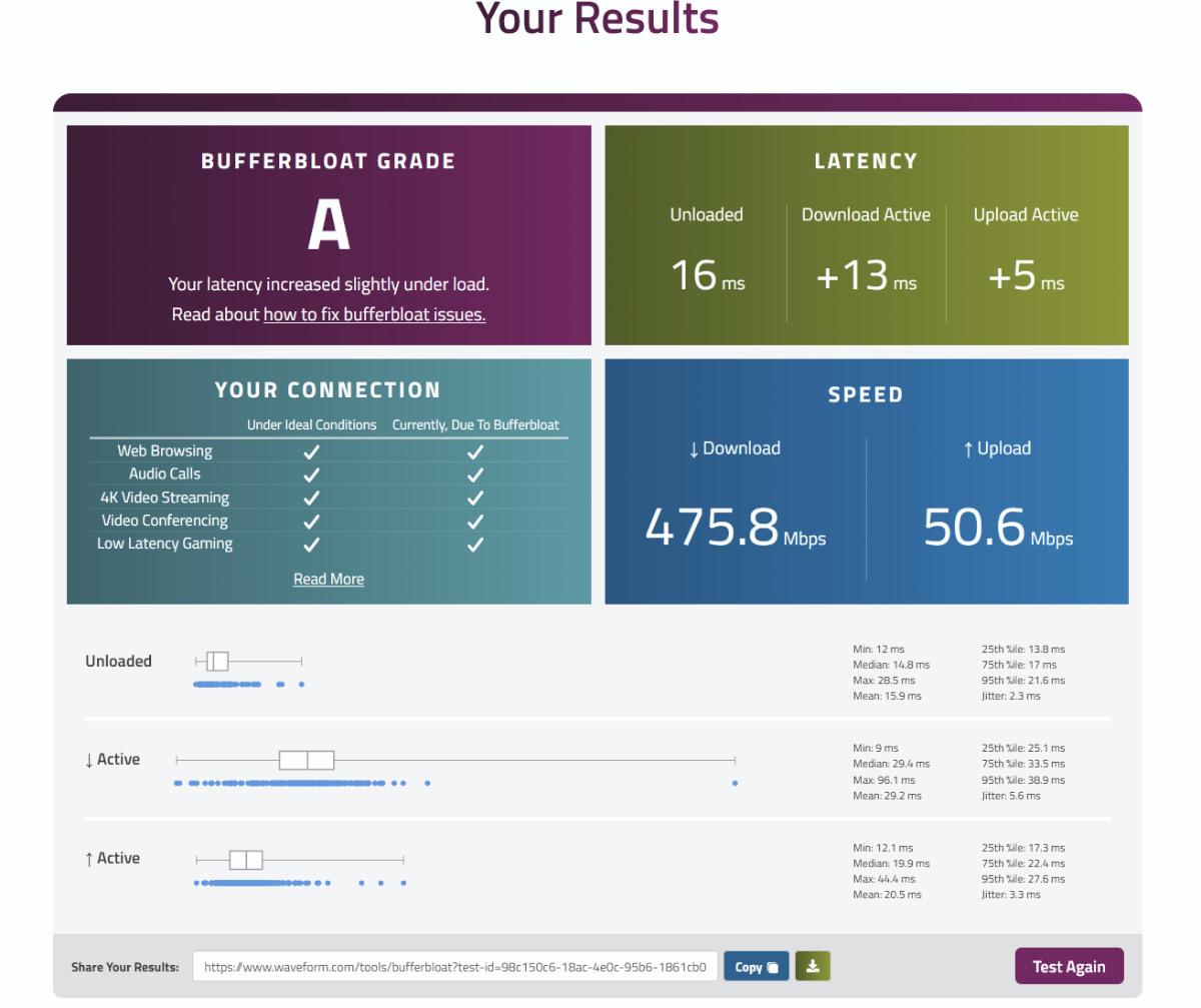

In the end. Ultimately, I was able to set a 50% download limit for congestion control  achieved good scores for bufferboat consistently:
This is a great outcome, assuming when auto-enable is engaged I have the best of both worlds, minus the ~100mbps extra I was able to achieve with Qos completely disabled.
It seems couunter intuitive to me that 50% would fair better than higher values i.e., 60 - 70%. That introduced 10 - 15ms to the active download latency. Though perhaps you've explained that through your last comment already & just an indication that CC is doing it's job now.

Posted
If you've just tried in 10% increments from 100% try in 10% increments from 95% as you might find a higher value that works better but ultimately every connection is different and so there isn't a definitive guide to what percentage works best. Some people like to really heavily throttle to 10% for example. People do tend to heavily focus on the results of that test as a mark of how good their connection is but I'd suggest going with what you feel when playing, if 50% gets good test scores but it's miserable to play on then it's not worth it.
Alternatively this is what I'd suggest doing if you have the time to really experiment: Follow this guide https://support.netduma.com/frequently-asked-questions/legacyfaqs/test-your-ping/ while downloading & start with 95% for Congestion Control (set to Always), check results, decrease by 10%, check, decrease by 10% etc, until you get to a value that is pretty good & then try 5% either side of that value to see if it can be improved. Download & Upload on Congestion Control don't have to be the same value & you may have a better experience with differing values.
