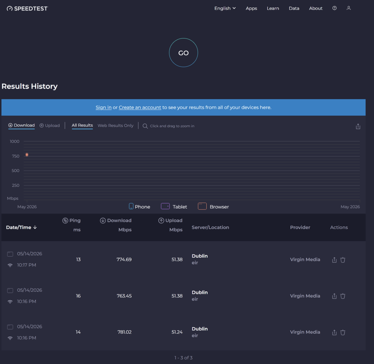

Alright that's fair. In the end. Ultimately, I was able to set a 50% download limit for congestion control achieved good scores for bufferboat consistently: This is a great outcome, assuming when auto-enable is engaged I have the best of both worlds, minus the ~100mbps extra I was able to achieve with Qos completely disabled. It seems couunter intuitive to me that 50% would fair better than higher values i.e., 60 - 70%. That introduced 10 - 15ms to the active download latency. Though perhaps you've explained that through your last comment already & just an indication that CC is doing it's job now.- 22 replies

Switched QoS back on, reset distributions for download && upload. Only traffic prio is defaults as pictured (snagit artifacts with HDR capture): Defiitely the best result with QoS on so far from speedtest.net: Waveform Bufferbloat loaded ping has doubled though: So still depressed slightly. Seems somewhat contradictory. I'm not sure what results are best to rely on.- 22 replies

Armour wasn't enabled. I just wanted to add here to see if there's any final recommendation or path forward. I've reverted again to the prior .82 firmware & configured the same as previous with QoS fully disabled & get the following results: I guess it's not so much to confound more but just to ask is there any route forward for QoS being enabled? I bought this router for these features specifically but right now there doesn't seem to be much reason to use the XR in place of the ISP router, solely. I'm not sure how much of a heightened risk I may be at for the lack of security patching. Thanks again Fraser for all the recommendations/advise up until now.- 22 replies
