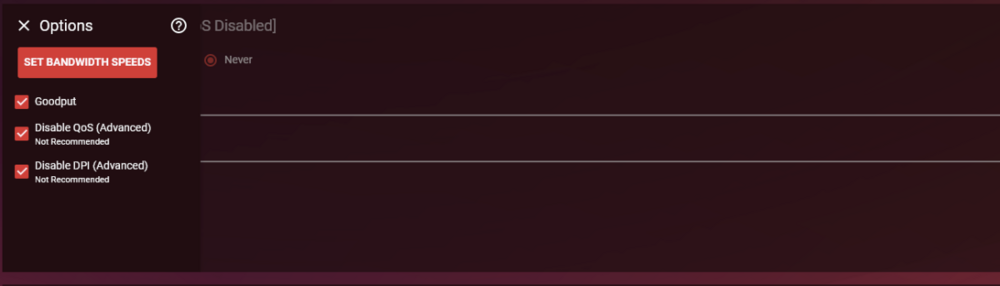

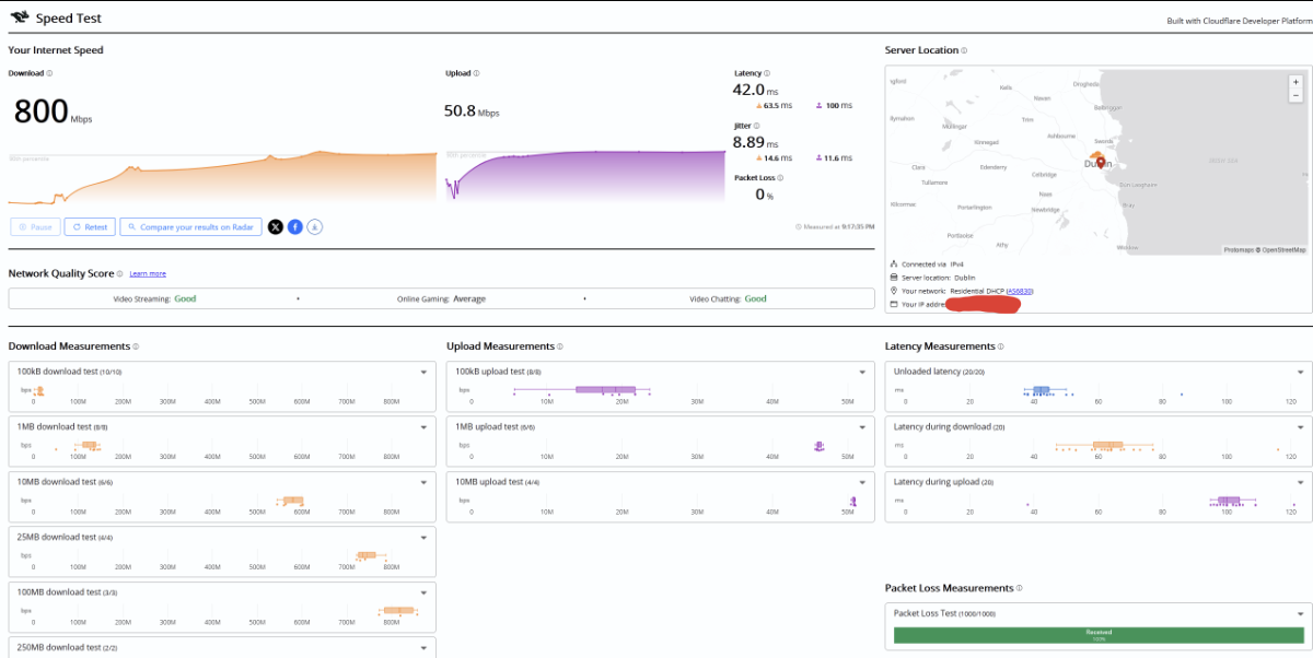

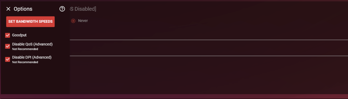

Hi again, I just wanted to offer some additonal evidence for my issue: Here's a speedtest from speed.cloudflare: Since the factory rest & viewing other articles on the forum I've since set nat filtering to open & configured my DNS (1.1.1.1 & 1.0.0.1) so here's some screenshots from DumaOS: I have QoS disabled for now so nothing extraneous would be limiting performance, I guess. Appreciate guidance on this matter. I've seen naterings of a beta firmware. I wonder if this would assist my issues without having to roll back.- 22 replies
