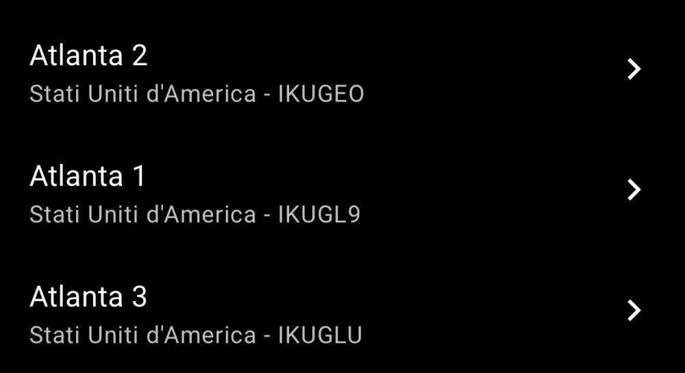

Bul Posted April 24 Author Posted April 24 I updated the router, everything worked normally, simple reboot: wait a few minutes to enter the router, various errors (from the PC it does not let me enter, the errors were given to me by the phone app)

Bul Posted April 24 Author Posted April 24 current situation, reset, start configuration and then the router goes crazy
Administrators Netduma Fraser Posted April 24 Administrators Posted April 24 Can you provide a full screen uncropped screenshot please? That will help me determine why its happening
Bul Posted April 25 Author Posted April 25 I have an internet connection, I can't log in to the app, the browser says "Duma is not running!" I've been stuck like this for a day, I restarted, reset and nothing. the image is the one above, you can't see anything else, I can't get in at all, the update you recommended to me blew up my router

Bul Posted May 18 Author Posted May 18 I can no longer log into the router from the PC, I logged in from the phone, I reinstalled the firmware, then I logged in from the PC, did the initial things and then nothing, I have these screens, infinite loadings and I can't even log in from the phone anymore. Can you log in via SSH? What should I do?

Bul Posted July 1 Author Posted July 1 You probably don't remember my situation. I invite you to look at the images above for a moment. I see all the accesses like this. I reset the router, do ipconfig on shell and try to log in. It often makes me reset all the initial parameters, but when I get to the final settings where it sends me to dumaOS, it freezes and loads endlessly. How do I resolve this situation? I shouldn't have listened to the update, all this mess happened when you told me to update.
Bul Posted July 1 Author Posted July 1 I managed to enter images through the link you mentioned adv_index.htm, I reinstalled the firmware but the ones I sent you above still appear, duma is not running
