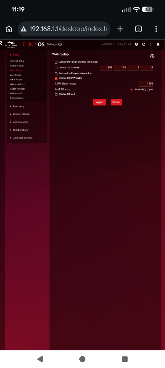

Administrators Netduma Fraser Posted March 28 Administrators Posted March 28 You only need to set a static IP for the console once, you can also just set NAT to Open in WAN settings or put the console in the DMZ, no need to port forward. Yeah I wouldn't bother with the Auto Setup for Congestion Control, it's not very accurate, much better to fine tune it manually yourself, don't just stick with one percentage as it may not be the best for your connection, that being said, with the way you had it setup it was never triggering as your Traffic Prioritization wasn't getting triggered so either set to Always or ensure your game is actually getting prioritized when playing. Not sure what you mean by "Subnet mask for LAN is correct but not wireless setup, even though the primary and secondary DNS servers are showing up correctly. "

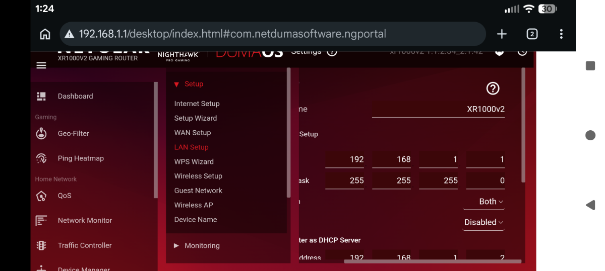

Administrators Netduma Fraser Posted March 29 Administrators Posted March 29 Where are you checking the LAN subnet mask as LAN Setup sets that for wired and wireless devices. You don't need to use Bandwidth Allocation you can just keep it on the defaults as 1) Share excess is enabled so it will get whatever it needs anyway and 2) Gaming barely uses any bandwidth so setting it that high wouldn't force it to use more but yes it still would be limited by that 70% BUT Traffic Prioritization supersedes Congestion Control so the game wouldn't be limited to 70% but other background processes on the console would. Maybe you do have a faulty router if the ports are giving wildly different or no results as there aren't any settings that would affect ports
mygamertagsucks Posted March 30 Author Posted March 30 14 hours ago, Netduma Fraser said: Where are you checking the LAN subnet mask as LAN Setup sets that for wired and wireless devices. You don't need to use Bandwidth Allocation you can just keep it on the defaults as 1) Share excess is enabled so it will get whatever it needs anyway and 2) Gaming barely uses any bandwidth so setting it that high wouldn't force it to use more but yes it still would be limited by that 70% BUT Traffic Prioritization supersedes Congestion Control so the game wouldn't be limited to 70% but other background processes on the console would. Maybe you do have a faulty router if the ports are giving wildly different or no results as there aren't any settings that would affect ports I'm a dumbass. Sorry. I think amidst all of this, I saw the W, and assumed it was the screenshot I took of the wireless setup. I'm sorry for that. Let me grab the pictures again real quick, and make sure I upload the correct ones this time. I have, admittedly, grown so frustrated with this that I literally cannot see straight when I'm looking at small thumbnails on my phone. Back in one second, hopefully. Also, thank you for a better explanation as to how the congestion control works. I knew that giving my PS5 all of that bandwidth was a dumb idea, and did it anyhow. Sucks when I'm trying to learn things on the fly, bc the stuff that was relevant when I took networking does not seem to apply to anything that I'm doing now. But hey, at least I have all these fun cable stripping tools, and crimpers and old dialup modems laying around. One last thing before I post the correct pictures; I was going through every little setting on the DumaOS interface, and clicking on every single question mark that explained what everything is, and how it works, etc. I noticed that when I checked in on AdBlocker, it was enabled, so my AdBlocker should have been working. Yet, I noticed that my phone, and my mother's phone, were letting some queries through, which I understand. But, my phone was getting multiple tracking and "ads" bubbles. When I clicked on the list of what was being tracked or advertised, it was a running list, in real time, from "googletagmanager", "googleadmanager", and one other Google thing. So, I took my phone offline, rebooted the router (habit), plugged my PlayStation in and played one match. I don't know if this is a placebo effect, or if taking my phone offline really made that much of a difference, but my connection was steady, but bullet reg, and the sync seemed off with the server. I would shoot one bullet into someone, in core gamemodes, and it would kill them, but show that I landed 4 or 5 shots. For the record, crossplay was set to "on/console only". Could this really have made the difference it felt like it did?

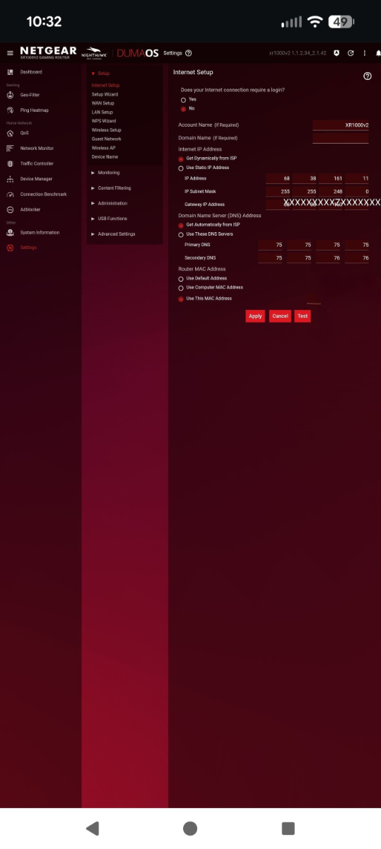

mygamertagsucks Posted March 30 Author Posted March 30 @Netduma Fraserhere are the pics, arriving late to the party as usual. Not sure which order these will end up posting. But, there will be the LAN pic showing the subnet mask, even tho it is showing the router as my local IP address.The Internet Setup Picture shows that the subnet mask is 255.255.248.0
Administrators Netduma Fraser Posted March 30 Administrators Posted March 30 Please be kinder to yourself, you're not being dumb at all! In regards to the Adblocker and not playing with your phone connected, it's unlikely to make a big difference unless the phone is using significant bandwidth or bombarding the router with requests. It might be worth looking into the Network Monitor when your phone is on to see how much it's using and also on Adblocker to see how many requests it's making. You can manually add domains to block on Adblocker if the default list isn't doing enough. Ah I understand about the subnet mask now thanks, that's all fine you can ignore that. Set NAT filtering to Open in WAN Settings - even if you have an Open NAT already, the option specifically relaxes the firewall so could alleviate any issues caused by that.
