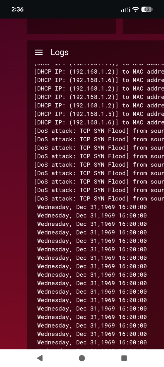

mygamertagsucks Posted March 18 Author Posted March 18 Sorry for the blurry nature of the photo, but my usb-C to USB disk isn't on me at the moment. This was just troubleshooting the SB6183 straight to the computer. So, would this, then, indicate a Comcast issue? Everytime I call them about an issue like this, they ALWAYS, and that is not an exaggeration, use the following phrase that burns me to my core because A. I know it's total BS, and B. It is one of the few phrases that I can actually understand, as there is clearly a language barrier. One last thing about Comcast; they never seem to be able to provide a paper trail as to when support has had to be called, and the eventual outcome of said issue. And even tho I write all of this stuff out on paper, they don't want to hear it. I can start the call by telling them, "I'm only calling you because I've power cycled the network, checked all connections and wiring, so I need to know what shows up on your end." Maybe I'm just a jerk, but that seems like the type of stuff you wouldn't then turn around and say, "see that connector on the back of your modem? Have you made sure it is plugged in?" Dang it. I hate dealing with these ppl but here goes. *Edited to Add the Following Question: would this explain the subnet masks showing up improperly on dumaos, as well we ipconfig /all, yet, when the Internet was working, it always showed up properly on the devices on the network?

mygamertagsucks Posted March 21 Author Posted March 21 @Netduma Fraser @DARKNESS Any idea what this is all about? Specifically, the date. I don't care about the syn/ack DoS from Comcast anymore.
Administrators Netduma Fraser Posted March 21 Administrators Posted March 21 If the router is showing an incorrect date that can have some very weird effects on things you wouldn't expect - change the timezone/dst to ensure you're seeing the correct time in System Information, then reboot it from the interface and see if it's performing better.

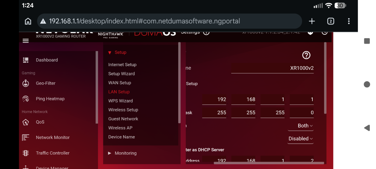

Administrators Netduma Fraser Posted March 23 Administrators Posted March 23 Could you provide a video going through the different pages of the router or sequential screenshots please of how you have things setup? I think in this case it will help narrow down some things. What I'm particularly interested in is: Geo-Filter Congestion Control/QoS Device Manager System Information Settings > Internet Setup Settings > WAN Setup Settings > LAN Setup
mygamertagsucks Posted March 26 Author Posted March 26 8jh @Netduma FraserI can absolutely do that, but it will be after 4pm my time (Eastern Daylight Time) because we have an in-store meeting tomorrow at our local Xfinity office because we have dealt with this for three weeks. I have called them 5 times, each time getting reassured that they would send someone to check our node. Finally, after three weeks, I got a call saying a technician has found and repaired an issue on their end and to press 1 to confirm the fix worked , 2 to keep our appointment. We chose #2. I did run pingplotter straight from the modem, and I'll post those when I get inside. But. I have no problems going thru and showing you my step by step approach. Hell, I kind of welcomed someone asking me to do this.
mygamertagsucks Posted March 26 Author Posted March 26 On 3/23/2026 at 11:11 AM, Netduma Fraser said: Could you provide a video going through the different pages of the router or sequential screenshots please of how you have things setup? I think in this case it will help narrow down some things. What I'm particularly interested in is: Geo-Filter Congestion Control/QoS Device Manager System Information Settings > Internet Setup Settings > WAN Setup Settings > LAN Setup @Netduma FraserOn second hand, I can do this beforehand and will do this in one second.
