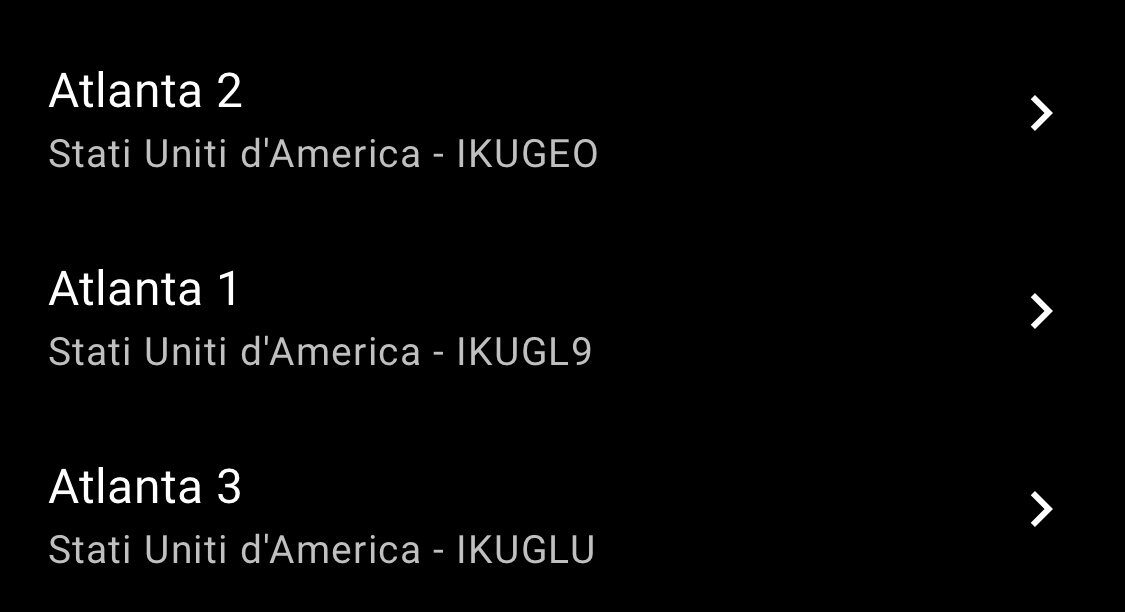

Administrators Netduma Fraser Posted July 7, 2025 Administrators Posted July 7, 2025 1 hour ago, Bul said: in america my ping starts at around 110, and goes up to 150-160 and finds it, today after 3-4 hours it got stuck at 60 and I couldn't play anymore ( game 120-130) Is this with or without the VPN now? What if you just use the VPN without the Geo-Filter?
Bul Posted July 7, 2025 Author Posted July 7, 2025 if I only use the VPN it doesn't find them, it goes up to 200 and doesn't find the games, I'm using the geofilter without the VPN, in console mode then manual
Administrators Netduma Fraser Posted July 7, 2025 Administrators Posted July 7, 2025 35 minutes ago, Bul said: if I only use the VPN it doesn't find them, it goes up to 200 and doesn't find the games, I'm using the geofilter without the VPN, in console mode then manual I think they're just cracking down on people forcing servers really far away and having a high ping so I don't think there is much you can do really, from the Geo-Filter perspective it's doing everything it can

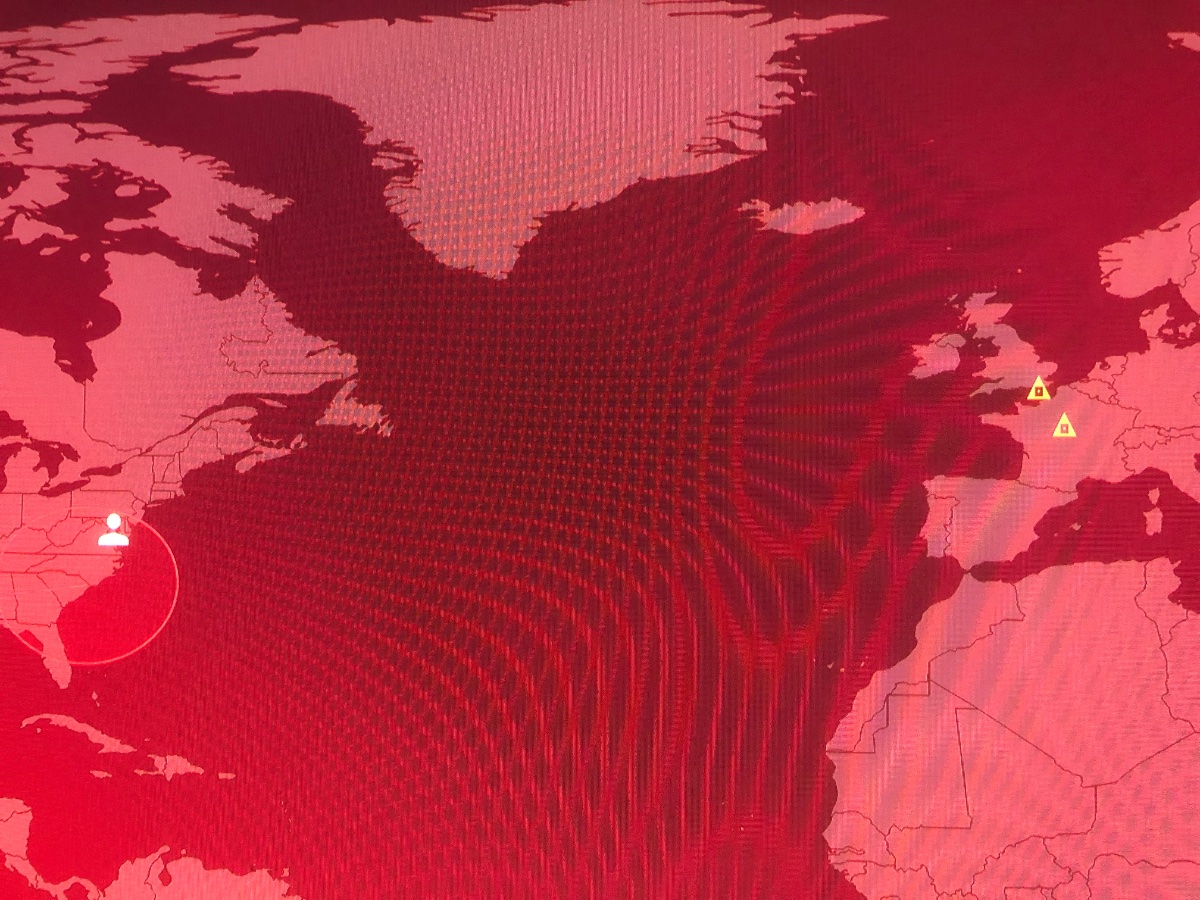

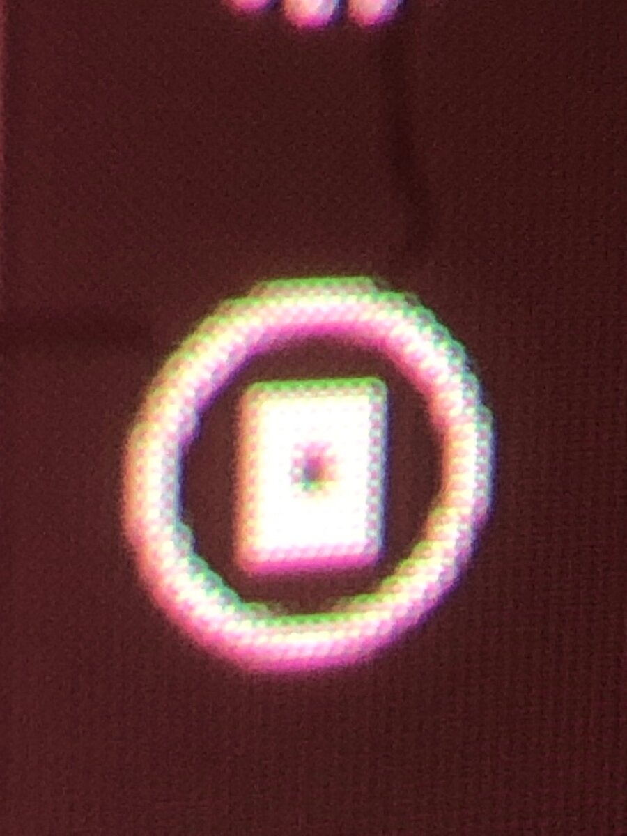

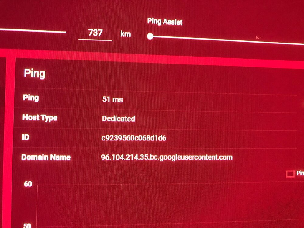

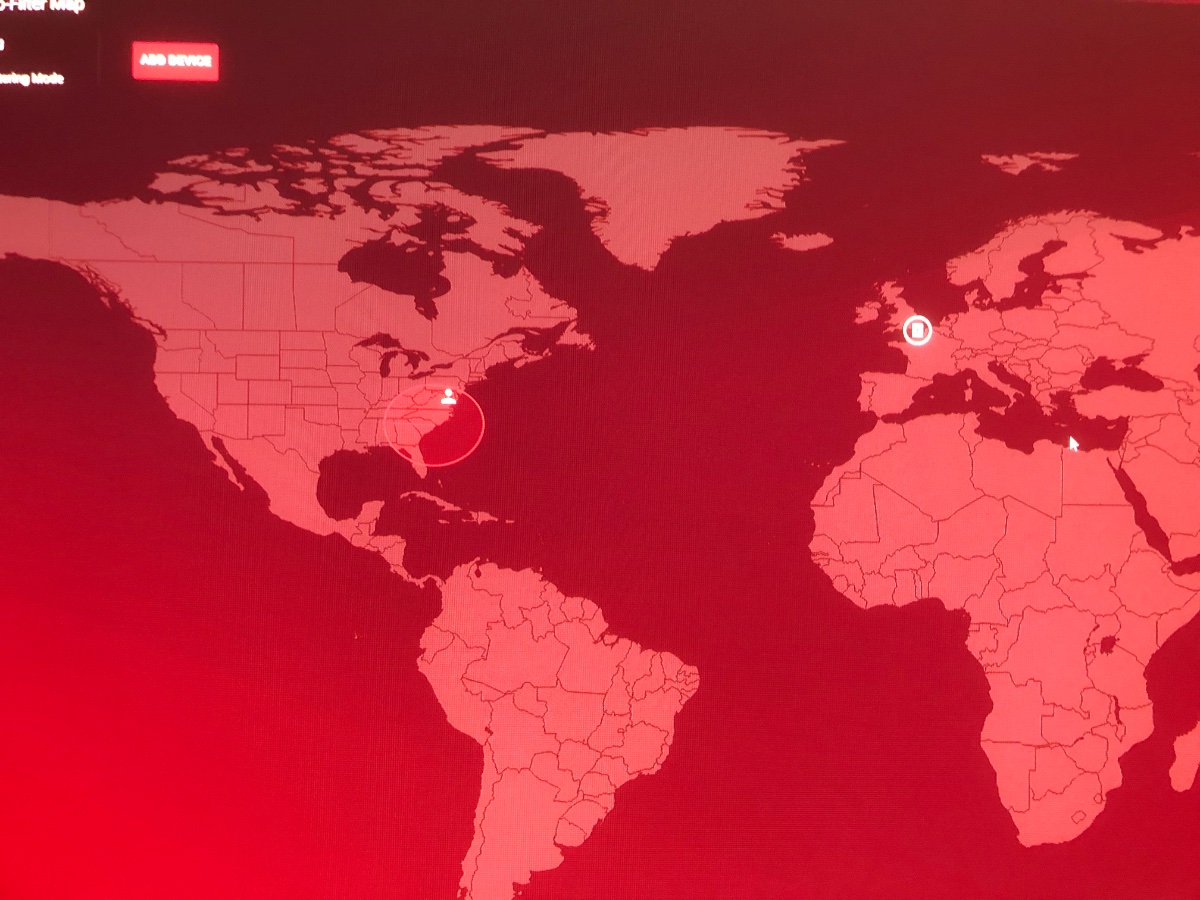

Bul Posted July 21, 2025 Author Posted July 21, 2025 I tried to search for games exclusively in one country, and shortly after it keeps finding games outside the selected area (in England) I found these servers, surely more will come out -d323915cc072d1d6 -722324efc011d1d6 -d223fec9c071d1d6 -93233803c032d1d6 -ab125d28af4a7d82 -d723af7ac076d1d6 -b023ecb7c04fd1d6 -ae23a671c04dd1d6 -
Administrators Netduma Fraser Posted July 21, 2025 Administrators Posted July 21, 2025 5 minutes ago, Bul said: I tried to search for games exclusively in one country, and shortly after it keeps finding games outside the selected area (in England) I found these servers, surely more will come out -d323915cc072d1d6 -722324efc011d1d6 -d223fec9c071d1d6 -93233803c032d1d6 -ab125d28af4a7d82 -d723af7ac076d1d6 -b023ecb7c04fd1d6 -ae23a671c04dd1d6 - Did they appear with white circles around them? Otherwise it's not the servers being whitelisted that is the issue
Administrators Netduma Fraser Posted July 21, 2025 Administrators Posted July 21, 2025 14 minutes ago, Bul said: Yes ,he appeared at this Where specifically around the UK are you seeing it? Can you provide a screenshot?
