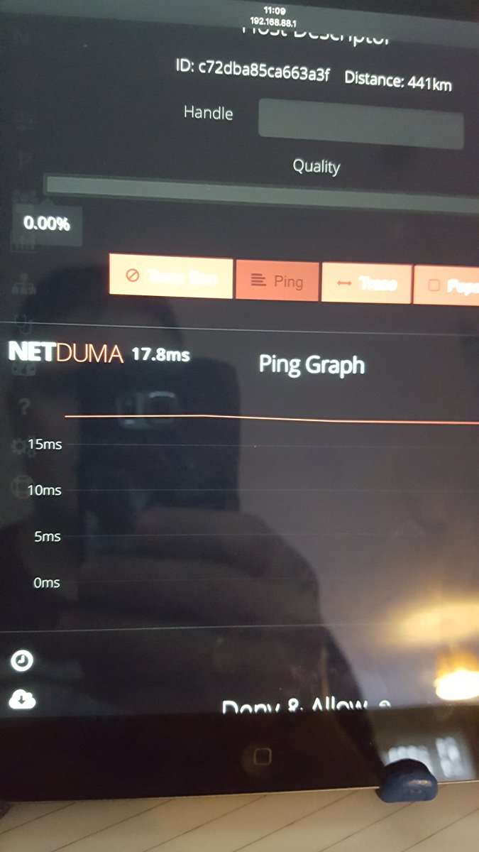

Mikes Posted January 17, 2017 Posted January 17, 2017 Usually my ping is around 20 but is spiking up to 60/80 while in game .. also my in game nat type was open for iw and bo3 and has now turned to moderate .. I got the duma a few weeks ago and have really noticed the difference in game .. but this last few days it's not been great
Mikes Posted January 17, 2017 Author Posted January 17, 2017 I have the screenshots requested but it's saying file too big
Administrators Netduma Fraser Posted January 17, 2017 Administrators Posted January 17, 2017 On behalf of Mikes:
Administrators Netduma Fraser Posted January 17, 2017 Administrators Posted January 17, 2017 Your ping looks great from the screenshots you've provided. Especially considering your base ping shown by internet diagnostics. I would reset device prioritisation. However, you shouldn't have any local congestion so sounds like it could be the servers you're connecting to. Move your home location into Europe and block out the ones you usually get and see if it plays any better. If your NAT has changed and you haven't done anything then your Duma's WAN IP has likely changed. Update the DMZ in your ISP hub with the new one.

ColonicBoom Posted January 17, 2017 Posted January 17, 2017 my in game nat type was open for iw and bo3 and has now turned to moderate On the Xbox, IW uses a different/additional port to BO3. BO3 used the usual ports AND 3074, IW uses 3076. Set the following and you will have an open NAT for both. Your ping looks fine by the way, nice and flat to the dedi. The server may just have been playing up, you may have got some flakey lobbies, or you might have just hit a load of better players. I had a great ping to the dedi (7ms) the other day but I couldn't hit a barndoor with a dustbin lid.
