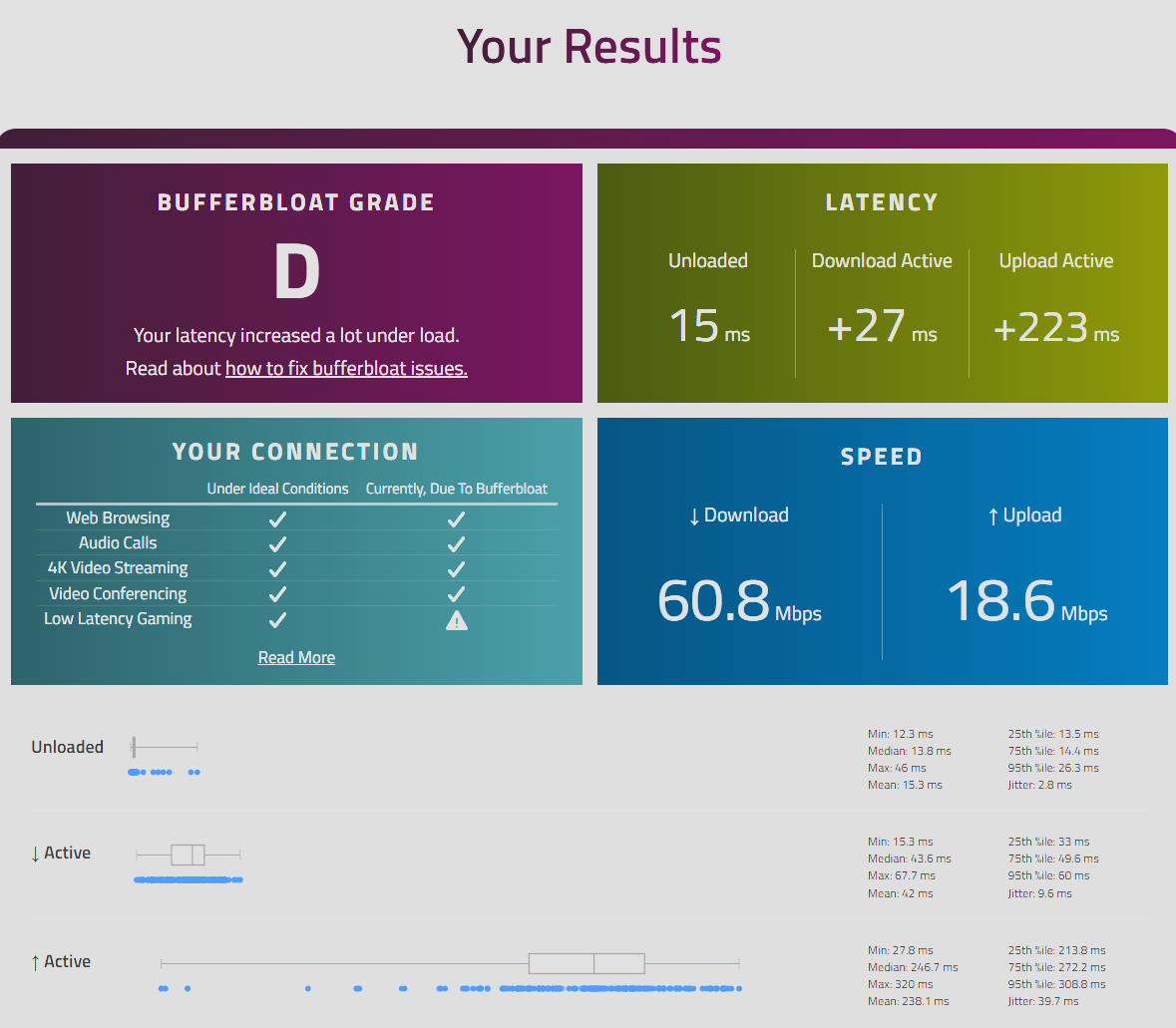

NetDumaR2User Posted 3 hours ago Author Posted 3 hours ago Thank you. I haven't tried gaming yet so not experienced any spikes. I used auto-setup on the QOS and enabled it as Always. It put download to 62% and upload to 100% I ran a Bufferbloat test and it came back grade D. I adjusted the download and upload to 60% each and got the same results on the test. Previously when using the PPPoE settings with the Draytek and same QOS settings I got grade A on the bufferbloat test (when the R2 was stable initially). Any ideas why it would have reduced to D, and if this means QOS isn't working correctly?

Administrators Netduma Fraser Posted 3 hours ago Administrators Posted 3 hours ago As the physical setup has changed the same settings for QoS may not work as well so you'll just need to fine tune it more - don't rely on auto setup just adjust it manually - we usually suggest starting at 70% then adjust by 10% up or down (it doesn't always have to be lower) until you get to a value that's pretty good then try 5% either side of that value to see if it can be improved further. Download & Upload also don't need to be on the same percentage, you may have different percentages where they each give the best results. It is important you have set the speeds you pay for/expect into the router though so it's using that as the basis, otherwise if you've left it with the speeds the in built speed test came back with for example then you may have them set too low and then you're then making it even lower than needed with the percentages. NetDumaR2User and Krush 1 1
