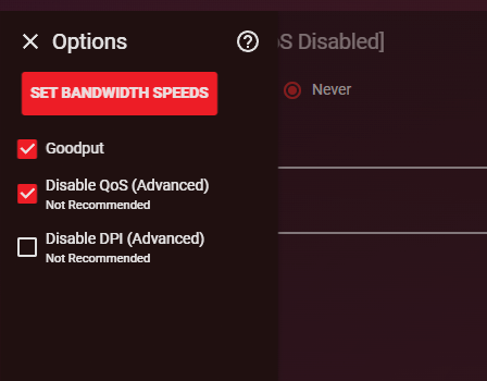

Administrators Netduma Fraser Posted May 1 Administrators Posted May 1 Is it happening when doing specific traffic each time? As a test completely disable QoS from the Congestion Control menu and see if it continues please
NetDumaR2User Posted May 1 Author Posted May 1 This time the only thing I did differently was connect a iphone to the wifi and then start doing an icloud backup. I then lost wifi on all devices. I've changed QOS from on to never. I'll let you know if I run into any errors.
Administrators Netduma Fraser Posted May 1 Administrators Posted May 1 1 minute ago, NetDumaR2User said: This time the only thing I did differently was connect a iphone to the wifi and then start doing an icloud backup. I then lost wifi on all devices. I've changed QOS from on to never. I'll let you know if I run into any errors. Disable it from the menu so it's fully disabled
NetDumaR2User Posted May 1 Author Posted May 1 OK I've put it like this. Let me know if I need to change anything else. If not I'll just let you know if I experience any issues. Thanks!
Administrators Netduma Fraser Posted May 1 Administrators Posted May 1 That's good! Go ahead and disable DPI as well just in case though I don't think it'll be that. Do keep us posted!

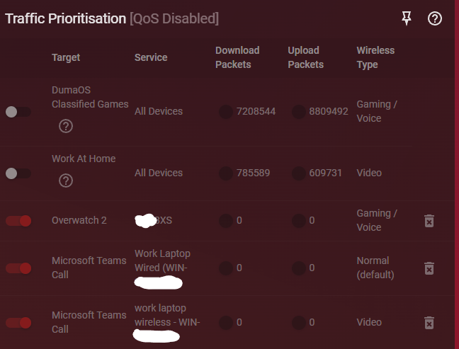

Administrators Netduma Fraser Posted May 3 Administrators Posted May 3 You shouldn't be getting slow internet with QoS enabled - is this set in the previous way you had it? Are you using Traffic Prioritization? Have you got Adblocker disabled on the router? Is the second switch the same as the first and definitely not a hub?
NetDumaR2User Posted May 3 Author Posted May 3 Both of the switches are identical. Yes Qos is set the previous way I had it. I have adblocker enabled. I paused it on the laptop and kept it running on the PC and both had no/slow internet when QOS was also enabled. As soon as QOS was disabled the internet ran smoothly again (just the lag spikes when gaming). I was using Traffic Prioritisation for the top two default ones, I tried disabling them and setting up my own ones but that didn't change the problem at all.
