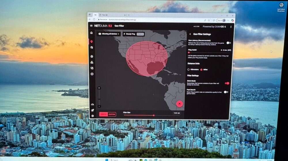

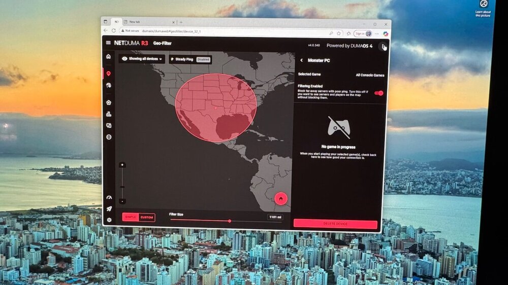

FurtherStill Posted November 24, 2025 Posted November 24, 2025 There are multiple issues I am seeing with connections to BF6 1. Oklahoma always showing as the server (this appears to have been fixed) 2. Dallas and Atlanta servers not connectible (Not sure if this is a duma issue or EA issue) 3. Servers allowed to connect outside of the selected region with strict mode enabled and ping assist off. (I always connect to a server in VA or CA). As the server starts to connect it shows up as a yellow triangle like its being blocked but then it allows it. My PC is also setup as a console MikeArroyo_87 1

FurtherStill Posted November 25, 2025 Posted November 25, 2025 Ok I disabled geo-latency and kept my Texas filter. Battlefield is unable to connect to anything, I see all the other servers trying to connect but it ultimately fails. Its looking like the dallas and atlanta servers are not active. But now I have a question. What is the purpose of strict mode if having geo-latency bypasses it? MikeArroyo_87 1

Administrators Netduma Fraser Posted November 25, 2025 Administrators Posted November 25, 2025 14 hours ago, FurtherStill said: Ok I disabled geo-latency and kept my Texas filter. Battlefield is unable to connect to anything, I see all the other servers trying to connect but it ultimately fails. Its looking like the dallas and atlanta servers are not active. But now I have a question. What is the purpose of strict mode if having geo-latency bypasses it? 12 hours ago, MikeArroyo_87 said: This is exactly the problem I’ve been encountering. Are you able to filter other servers than those two? Really there is no current purpose for strict mode, it was implemented a long time ago to combat an issue with Destiny matchmaking, basically for every other game it should be enabled and was moved so people don't really change it but we've kept the option in case anyone does still need it. Geo-Latency tries to filter by ping instead and this can in some cases lead to games outside your radius being connected to.

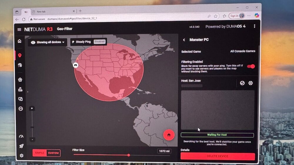

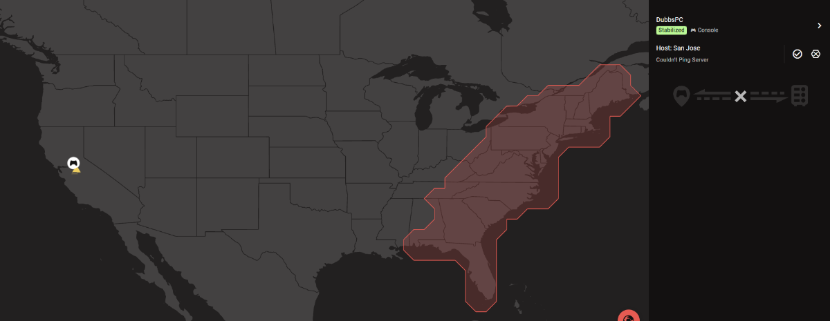

terry_b Posted December 19, 2025 Posted December 19, 2025 I am consistently being connected to West Coast servers despite having everything setup to filter for East Coast ONLY. Even setting the SanJose server to deny just connects me to another one next game. I'm not sure why it's not even attempting to connect to the usual east coast server, but even that one shows a LOT of ping issues - usually 20ms, but lately it's been 80-90 with spikes into the hundreds, I'm desperately waiting for the new fiber install in my town, but in the meantime I'm stuck with Spectrum. Is this a ISP issue?
Administrators Netduma Fraser Posted December 19, 2025 Administrators Posted December 19, 2025 29 minutes ago, terry_b said: I am consistently being connected to West Coast servers despite having everything setup to filter for East Coast ONLY. Even setting the SanJose server to deny just connects me to another one next game. I'm not sure why it's not even attempting to connect to the usual east coast server, but even that one shows a LOT of ping issues - usually 20ms, but lately it's been 80-90 with spikes into the hundreds, I'm desperately waiting for the new fiber install in my town, but in the meantime I'm stuck with Spectrum. Is this a ISP issue? Disable Geo-Latency, restart the PC and try again, it should work then
terry_b Posted December 19, 2025 Posted December 19, 2025 Well that gets me back on the east coats but the game still plays terrible every other game - which at this point I'm chalking up to obvious game server issues.
