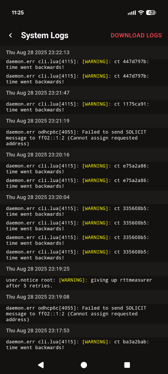

Spdsk8race Posted August 29 Posted August 29 I don't know if there could be a lot of congestion with a 1gbps fiber line, but every time these network issues happen I see these time went backwards errors
Administrators Netduma Fraser Posted August 29 Administrators Posted August 29 It won't be that, it's just log spam. Any download will saturate a connection, even 1Gbps, check network usage at the time to see if there is anything using a lot of bandwidth
