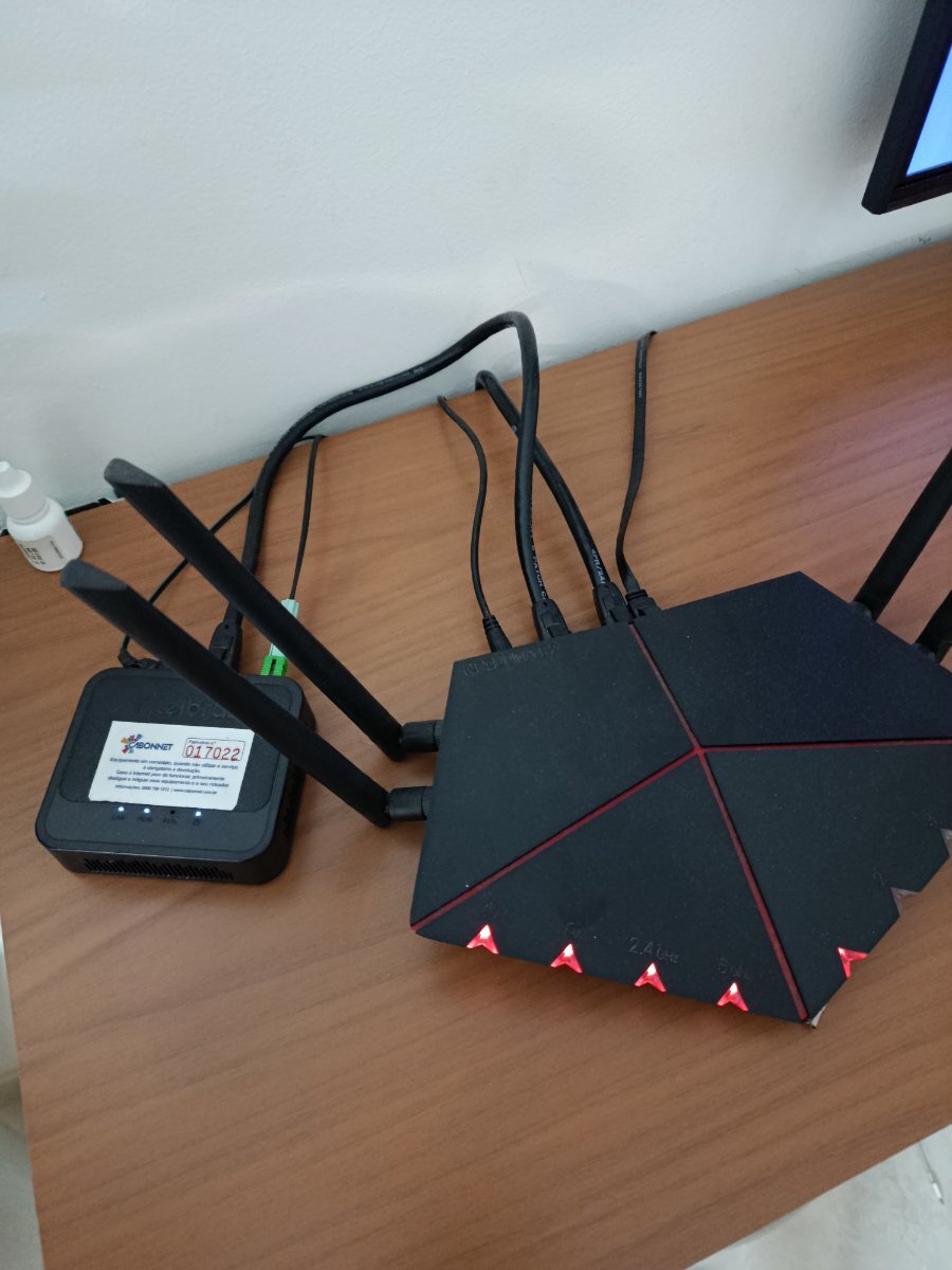

Paulo_81 Posted July 21, 2025 Author Posted July 21, 2025 1 hour ago, Netduma Fraser said: Onde você está testando as velocidades? O R2 está na DMZ do seu modem/roteador ISP? TODOS os dispositivos estão conectados ao R2? Se você realmente não conseguir mais do que 300 e tudo estiver feito e configurado corretamente, então eu sugeriria definir como 300. As in the photo, it is connected to the ONU in PPPoE, PC with fixed IP on R2, as it is a PC I disabled UPNP and did manual port forwarding, the tests are performed on speedtest oakla! I am on the stable version .280!
Administrators Netduma Fraser Posted July 21, 2025 Administrators Posted July 21, 2025 13 hours ago, Paulo_81 said: As in the photo, it is connected to the ONU in PPPoE, PC with fixed IP on R2, as it is a PC I disabled UPNP and did manual port forwarding, the tests are performed on speedtest oakla! I am on the stable version .280! The speed reduction is due to PPPoE then. If you can't use another modem/router to handle PPPoE so you can get higher speeds on the R2 then set to 300.
Paulo_81 Posted July 21, 2025 Author Posted July 21, 2025 1 hour ago, Netduma Fraser said: A redução de velocidade se deve ao PPPoE. Se você não puder usar outro modem/roteador para lidar com PPPoE e obter velocidades mais altas no R2, defina como 300. I disabled both security filters, the speeds went to 530MB, very close to the contracted speed! Netduma Fraser 1
