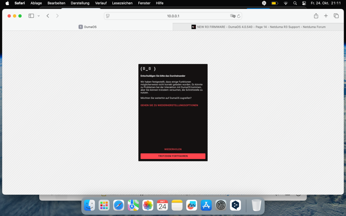

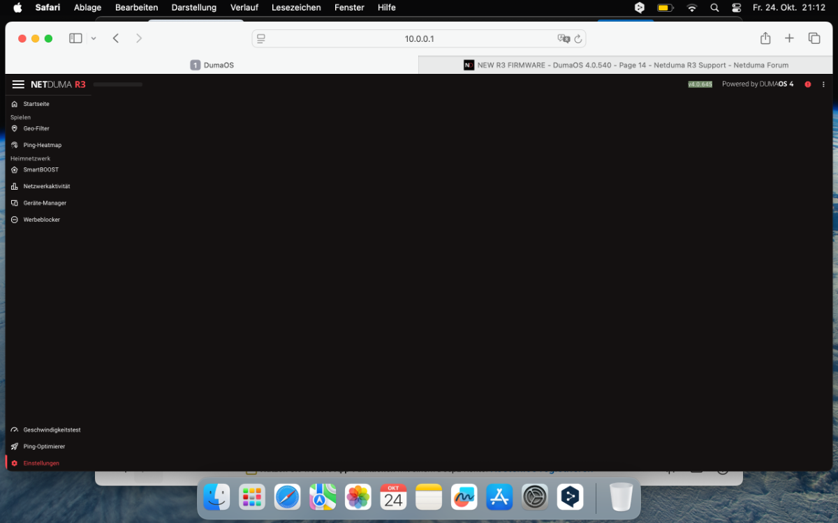

VeniVidiVici Posted October 24 Posted October 24 I've restarted my router five times already and it keeps telling me that some functions aren't working. I press ‘Continue anyway’ and it loads, but I can't do anything. It's been like this since I installed the v4.0.645 update.
Administrators Netduma Fraser Posted October 24 Administrators Posted October 24 19 minutes ago, VeniVidiVici said: I've restarted my router five times already and it keeps telling me that some functions aren't working. I press ‘Continue anyway’ and it loads, but I can't do anything. It's been like this since I installed the v4.0.645 update. Safari forces HTTPS so try a different browser please, check if that browser forces HTTPS and if so disable it for the interface. If it still occurs could you change the LAN IP of the router back to default and see if that works better please?
