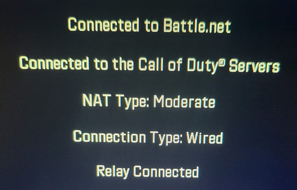

David824 Posted March 23, 2024 Posted March 23, 2024 So I got my R3 today and I did the update to the .41 and have everything set up like I should...but whats the deal with the UPNP not reading any ports on my PS5 for call of duty? I'm getting a moderate in every COD game I try. The only port the R3 reads in the interface (I believe thats what it is) for the PS5 which is 9303....will that ever get fixed or getting fix? right now I still have UPNP still running but have 3074 port going in port forwarding.

Administrators Netduma Fraser Posted March 23, 2024 Administrators Posted March 23, 2024 You should still get an Open NAT, if you hard reboot the console, or you can port forward but yes in the next version we have made improvements to UPnP
David824 Posted March 23, 2024 Author Posted March 23, 2024 3 hours ago, Netduma Fraser said: You should still get an Open NAT, if you hard reboot the console, or you can port forward but yes in the next version we have made improvements to UPnP if I'm using just UPNP.....on the UPNP list on the interface its only showing 9303 port open which I think it for the PS% but thats it...I go into cod cold war...moderate net...I go into MW3 I moderate I have reboot the router and the PS5 a few times...and still get it...I havent done a hard reboot on the PS5.....I know of a hard reset which would wipe all my games off...how do you do a hard reboot compared to a normal reboot?

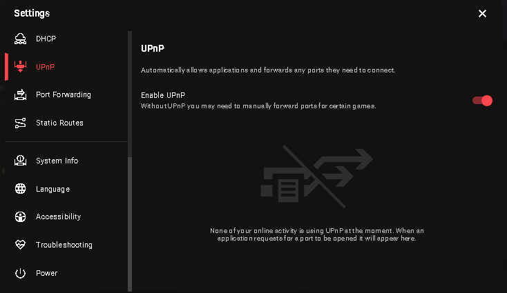

CODZ Posted October 26, 2025 Posted October 26, 2025 so i notice that my upnp hasn't been working...for awhile now since after the latest firmware update I've tried turning it off and on, resetting the router and nothing 🤦🏾♂️ also wps is still not working for me
Administrators Netduma Fraser Posted October 26, 2025 Administrators Posted October 26, 2025 20 minutes ago, CODZ said: so i notice that my upnp hasn't been working...for awhile now since after the latest firmware update I've tried turning it off and on, resetting the router and nothing 🤦🏾♂️ also wps is still not working for me UPnP will open ports when a program/device needs one to be opened, are you having any issues with NAT? We'll keep working on improving WPS

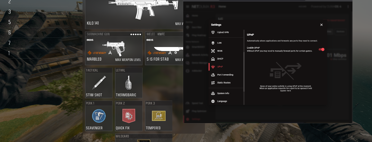

CODZ Posted October 26, 2025 Posted October 26, 2025 Yes I know but it's not working now...whenever I play warzone I use to see the indicator letting me know it was working but since after the update it's not been working
Administrators Netduma Fraser Posted October 26, 2025 Administrators Posted October 26, 2025 7 hours ago, CODZ said: Yes I know but it's not working now...whenever I play warzone I use to see the indicator letting me know it was working but since after the update it's not been working If you have an Open NAT regardless then either those ports don't need to be opened or they have been opened but it's not showing for whatever reason and we can look into that. I've also given your Early Access to try https://forum.netduma.com/forum/151-netduma-r3-early-access/
CODZ Posted October 27, 2025 Posted October 27, 2025 Well I hope updating the firmware with this (https://forum.netduma.com/forum/151-netduma-r3-early-access/) fixes my issue
CODZ Posted October 27, 2025 Posted October 27, 2025 after updating to firmware 4.0.645...it is still not working unfortunately as you said "they have been opened but it's not showing" it might just be not showing. hope this can be fix in the future
Administrators Netduma Fraser Posted October 27, 2025 Administrators Posted October 27, 2025 6 hours ago, CODZ said: after updating to firmware 4.0.645...it is still not working unfortunately as you said "they have been opened but it's not showing" it might just be not showing. hope this can be fix in the future Close the game and game client e.g. Steam (including from the System Tray), disable the Geo-Filter then launch the game again, does it show Open?
