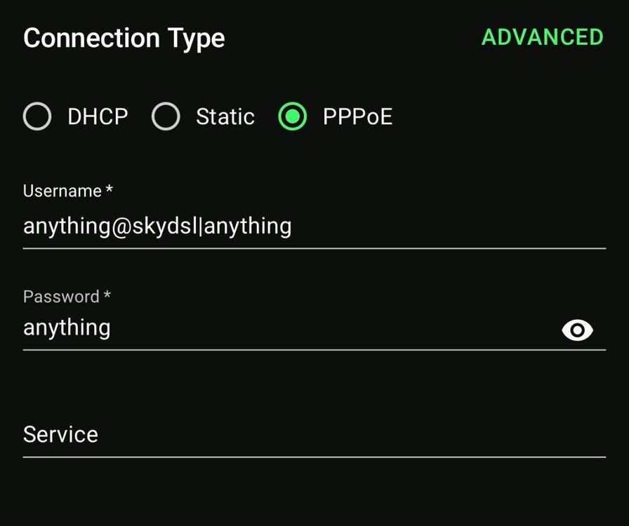

Check456 Posted October 9, 2025 Posted October 9, 2025 SOLUTION / SOLVED I have sky and have fixed it 1. Go to settings 2. Go to WAN 3. In WAN select PPPoE 4. In the username section put: anything@skydsl|anything 5. In the password section put: anything 6. The last line should just say service 7. picture included
Administrators Netduma Fraser Posted October 9, 2025 Administrators Posted October 9, 2025 2 hours ago, Check456 said: SOLUTION / SOLVED I have sky and have fixed it 1. Go to settings 2. Go to WAN 3. In WAN select PPPoE 4. In the username section put: anything@skydsl|anything 5. In the password section put: anything 6. The last line should just say service 7. picture included Thanks for providing a solution! Check456 1
