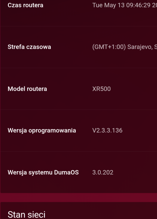

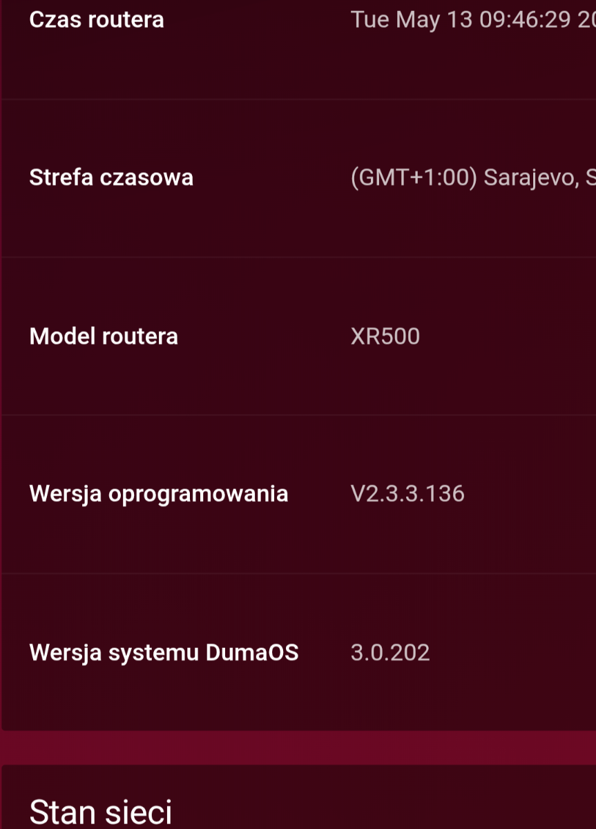

HiTmAn47 Posted May 13 Share Posted May 13 After updating to V2.3.3.136 DumaOs returns to version 3.0.202 is there any solution for this? Link to comment Share on other sites More sharing options...
Administrators Netduma Fraser Posted May 13 Administrators Share Posted May 13 7 minutes ago, HiTmAn47 said: After updating to V2.3.3.136 DumaOs returns to version 3.0.202 is there any solution for this? Upgrade back to the version from this topic bberger 1 Link to comment Share on other sites More sharing options...
