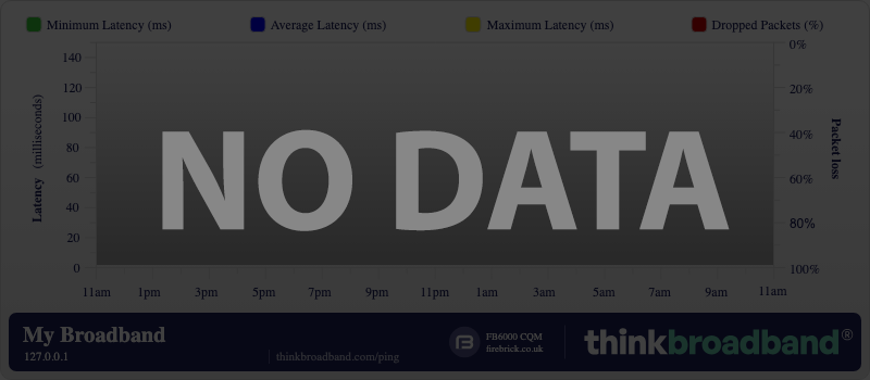

Mario Vale Posted April 20, 2017 Author Posted April 20, 2017 I purchased the DrayTek Vigor 130 and I've been testing my connection with it since Saturday. So far it has yet to fail with an error code and the ping monitor graph I have has been impeccable. I guess the modem in the Nighthawk is way better than the cheap Netgear modem I bought to use with the Netduma. I will keep testing for a bit, but based on my current results I don't think I will see an error code again (unless it is Bungie's fault like earlier tonight).
