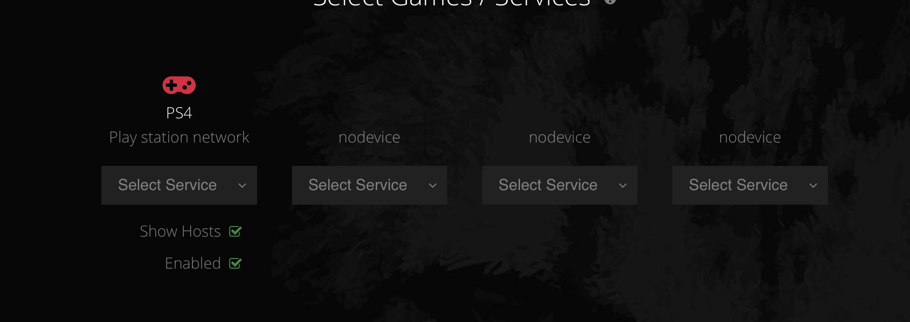

aleagray Posted December 23, 2016 Posted December 23, 2016 i cant seem to conbect to host in the set range, i put my home to usa, but it keeps connecting to german dedicated servers(i live in germany) i have strict mode on, everything is fine. I also did the recommended things on the forum, reset, restart, everything. It doesnt matter where i put my home location to. It searches but connects to german servers. When i temp ban the dedicated server, it will still connect to it( i am mainly playing, cod games, bo3, mwr and infinite warfare. Please heeelp See the attached pics for my stats
ColonicBoom Posted December 23, 2016 Posted December 23, 2016 i cant seem to conbect to host in the set range, i put my home to usa, but it keeps connecting to german dedicated servers(i live in germany) i have strict mode on, everything is fine. I also did the recommended things on the forum, reset, restart, everything. It doesnt matter where i put my home location to. It searches but connects to german servers. When i temp ban the dedicated server, it will still connect to it( i am mainly playing, cod games, bo3, mwr and infinite warfare. Please heeelp See the attached pics for my stats Did you forget to attach some other pics? No matter. You're using Ping Assist, yes? Turn off your console. Set your home on USA. Set ping assist to zero. Enable 'Strict'. Give it a few minutes for the 'anti-cheat' to accept the change (it will not notify you but a few minutes is enough). Reboot your Netduma from 'miscellaneous settings'. Turn on console. ...et voila. When you Temp Ban a server, you are banning one of many at the same location. It may appear that you are connecting to the same one but it will not be the same one. At least for the duration of the ban - 5 mins (long enough to get a different server).
Administrators Netduma Fraser Posted December 23, 2016 Administrators Posted December 23, 2016 Hey, welcome to the forum! The above suggestion should get you sorted, thats how I force foreign servers when testing.
aleagray Posted December 28, 2016 Author Posted December 28, 2016 Did you forget to attach some other pics? No matter. You're using Ping Assist, yes? Turn off your console. Set your home on USA. Set ping assist to zero. Enable 'Strict'. Give it a few minutes for the 'anti-cheat' to accept the change (it will not notify you but a few minutes is enough). Reboot your Netduma from 'miscellaneous settings'. Turn on console. ...et voila. When you Temp Ban a server, you are banning one of many at the same location. It may appear that you are connecting to the same one but it will not be the same one. At least for the duration of the ban - 5 mins (long enough to get a different server). omg thank you so much !!!!!!
