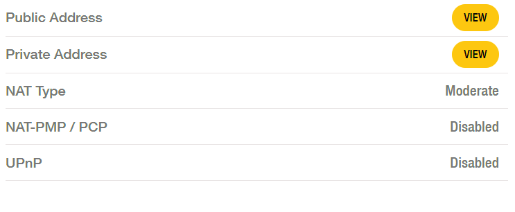

ifell Posted April 26 Posted April 26 I am trying to achieve an Open NAT in GTA Online (PC) to host lobbies for achievements. Despite a perfect setup, the game consistently reports Moderate NAT. Netduma R3 Firmware: v4.0.540 Connection: Direct NBN Fiber (FTTP) to NTD (No ISP modem/Bridge mode issues) Ports: All Rockstar-required ports (6672, 61455-61458 UDP, etc.) are manually forwarded. UPnP is disabled to avoid conflicts. I cannot find a toggle for 'NAT Filtering: Open' or 'Endpoint Independent Mapping' in the DumaOS 4 interface. It appears the R3 is performing Symmetric or Address-Restricted NAT by default, which is preventing me from being the primary session host.
Administrators Netduma Fraser Posted April 26 Administrators Posted April 26 You can enable UPnP, although you're correct it would avoid conflicts by keeping it disabled its quite unlikely to happen and I've never seen it cause any issues with both enabled and it may help you in this scenario. With that and the required ports it's unlikely you would actually have a moderate NAT even if its reporting it - have you actually hosted and had issues with people joining to check if it is moderate? If people can join then you will be open. Short of putting the PC in the DMZ which is a security no-go there aren't any other settings you could adjust to get an Open NAT. Do make sure to disable the Geo-Filter though as that could cause issues with people joining.

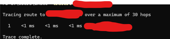

ifell Posted May 1 Author Posted May 1 Thanks for the suggestion, I understand why you’d want the direct-to-modem test done to fully rule out CGNAT. However, based on my current setup, the Netduma R3 is acting as the main router and is directly connected to the internet (no double NAT). and i'm getting 1 hop as it all is currently configured since it's my public static ipv4 i've covered it up of course It reports the same public IPv4 on the WAN as external checks and consistently shows a single hop, which strongly indicates there’s no CGNAT involved. As an additional note, I have a static public IPv4 assigned with my internet plan. I do have plans this weekend (running heists in Grand Theft Auto Online), and I also need to keep the internet running for other people in the household. Because of that, I won’t be able to disconnect everything and run the direct modem test immediately. I’m happy to carry that out as soon as I can after the weekend.

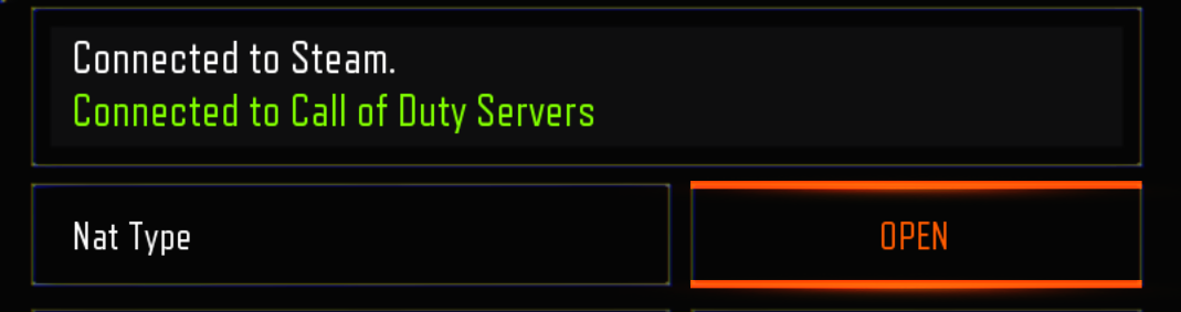

ifell Posted May 2 Author Posted May 2 I am currently troubleshooting NAT type issues. My setup is as follows: Rule 1: 3074 UDP Rule 2: 4380 UDP Rule 3: 3478–3480 TCP & UDP Rule 4: 3658 UDP Rule 5: 6672 UDP Rule 6: 27000–27036 TCP & UDP Rule 7: 443 TCP Rule 8: 80 TCP Additional information: My ISP is not blocking any ports There is no CGNAT and no double NAT (direct internet connection, single hop traceroute) UPnP is disabled for testing purposes and will be enabled after this post since the outcome didn't change All ports are manually forwarded as listed above Despite this configuration, NAT type remains Moderate for gta but black ops 2 and black ops 3 are open
Administrators Netduma Fraser Posted May 2 Administrators Posted May 2 Could you check if you're having the connectivity issues though still as it is possible its a misreading given the Open NAT on CoD.
