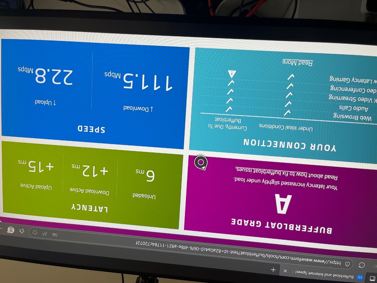

Mehmet Posted Sunday at 12:33 PM Posted Sunday at 12:33 PM 2 hours ago, Netduma Fraser said: What do you mean by no response exactly, speeds weren't reduced or bufferbloat values weren't changed? Are you testing using the same bufferbloat site? Previously, bufferbloat test values in waveform website were "0" latency download and upload. Currently, QoS is set manually and there is no spurious effect in "always on" mode.
DanologyUK Posted Sunday at 06:09 PM Posted Sunday at 06:09 PM 5 hours ago, Mehmet said: Previously, bufferbloat test values in waveform website were "0" latency download and upload. Currently, QoS is set manually and there is no spurious effect in "always on" mode. Well I can see your problem! Your monitor is upside down so the internet is falling out of the monitor. Turn it around the correct way and you wont have any internet leakage. DARKNESS 1
Administrators Netduma Fraser Posted Sunday at 06:12 PM Administrators Posted Sunday at 06:12 PM 5 hours ago, Mehmet said: Previously, bufferbloat test values in waveform website were "0" latency download and upload. Currently, QoS is set manually and there is no spurious effect in "always on" mode. Looks like you're testing on a console network browser is that right? I'm not sure how well that will test but what do you get when setting to 50% for example? What is the model of the modem/router the R3 is connected to and how have you set that to ensure all traffic flows to the R3? E.g R3 in its DMZ, modem/bridge mode Are ALL devices connected to the R3? What are the speeds you pay for/receive? Have you entered those speeds into the router? How have you setup Congestion Control? Is the platform you're testing on connected via ethernet or WiFi?
