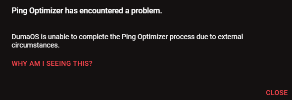

Wr3ck3r Posted 20 hours ago Posted 20 hours ago R3 ping optimizer and Speed Test are not working. I rebooted, restarted, etc. I cannot get it to work.
Wr3ck3r Posted 18 hours ago Author Posted 18 hours ago I had to factory reset the router. Seems to be working now. Not sure why this happened in the first place?
DARKNESS Posted 17 hours ago Posted 17 hours ago @Wr3ck3rIt's a known issue currently being addressed. It doesn't impact the router, and you can use speedtest.net as an alternative. Wr3ck3r 1
Wr3ck3r Posted 9 hours ago Author Posted 9 hours ago I had to roll back the firmware to get Speedtest and ping op to work. I’ll wait for the next update to test.
Krush Posted 9 hours ago Posted 9 hours ago C'est juste lié à la façon dont est connecté le R3 derrière votre FAI ... C'est connu... mais très facilement résoluble ! 😉 Wr3ck3r 1
Administrators Netduma Fraser Posted 5 hours ago Administrators Posted 5 hours ago As others mentioned we're aware it's not 100% accurate at the moment and the alternatives are: Speed Test - Enter your speeds manually / use speedtest.net and then enter speeds manually Ping Optimizer - Adjust Congestion Control manually (which is what PO does for you), start with 70% which is a good starting point and adjust from there if needed Wr3ck3r 1
