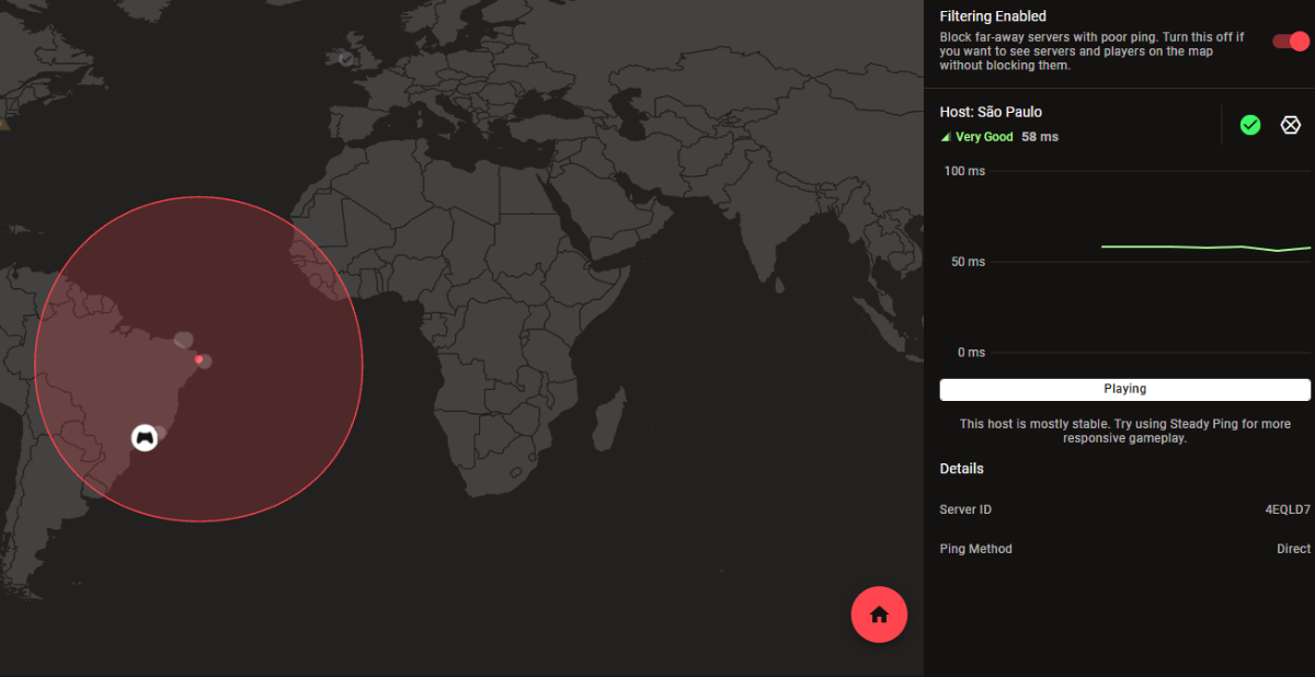

Iced Soul Posted October 6, 2025 Author Posted October 6, 2025 6 minutes ago, Netduma Fraser said: If you're referring to the one in Ireland that is an authentication server required for online play and will not negatively impact your connection - it's not the game server, just the one with the controller symbol No, I'm referring to the host, as in the image below. So, I did everything you recommended and I keep getting redirected to international servers. The issue isn't that I'm redirected there sometimes, it's that I'm redirected there every match. Every match! I confess I'm frustrated with this issue. Does Exitlag have any impact?
Administrators Netduma Fraser Posted October 6, 2025 Administrators Posted October 6, 2025 1 hour ago, Iced Soul said: No, I'm referring to the host, as in the image below. So, I did everything you recommended and I keep getting redirected to international servers. The issue isn't that I'm redirected there sometimes, it's that I'm redirected there every match. Every match! I confess I'm frustrated with this issue. Does Exitlag have any impact? I can't see that photo but I'm assuming it's the one off the coast of Africa which is what I'm asking, is it that one every single time or are you getting others in other countries outside your radius? Well yes it would, you're using another service that is manipulating your internet traffic, you're literally creating an encrypted tunnel between you and the VPN server that the router can't read as well as affecting the routing to servers. Is that what you're using?
