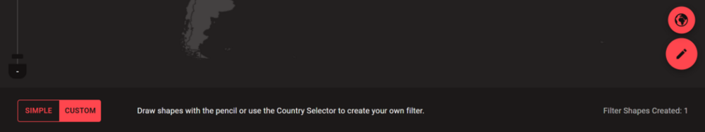

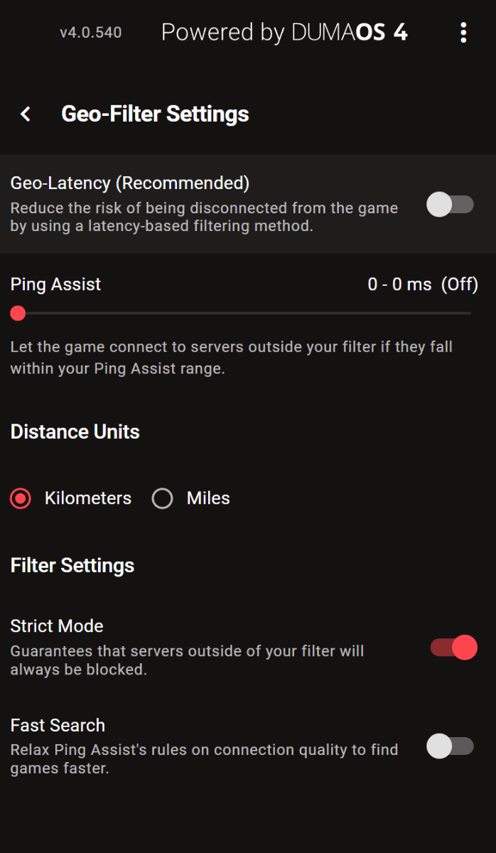

Administrators Netduma Fraser Posted October 5 Administrators Posted October 5 26 minutes ago, Iced Soul said: Ok, my friend. PPPoE worked for me. In two weeks, it disconnected a couple of times, forcing me to restart the router. However, the Geo-Filter never works. I even went to a server in Japan. That's absurd, in my opinion. I set my country as the country, and yet I'm constantly being redirected to international servers, forcing me to play with a 90-140ms ping. It's simply unplayable, with packet loss, overshooting, and everything else. One of the reasons I bought Duma R3 was to stop playing on international servers, and nothing has changed for me. How do I fix this? Another issue: the Ping Optimizer doesn't work. It pretends to find my real ping, increasing it by 15ms, and then claims to have optimized it to the value it actually is. How do I fix this? Thank you. We'll fix the PPPoE issue, thanks for letting us know. Disable Geo-Latency and Ping Assist, make sure you're enabling the Geo-Filter before you launch the game/client and if you change Geo-Filter settings while on the game then reboot the game and it should all stay within your radius. We're aware Ping Optimizer isn't 100% reliable currently but the ping at the start is your base ping - the ping you have before you do anything on the internet so it's established what that is to the server it is using (the ping won't be the same as wherever you may see your ping). It then simulates a heavily used network and re-tests the ping, this is where you'll see an increase in the ping. It then repeats the tests but adjusts the Congestion Control percentages to find the percentages that allow you to have a heavily used network with minimal difference in your ping. So what you described is the optimal outcome and exactly what you want it to be doing. Iced Soul 1
Iced Soul Posted October 6 Author Posted October 6 13 hours ago, Netduma Fraser said: We'll fix the PPPoE issue, thanks for letting us know. Disable Geo-Latency and Ping Assist, make sure you're enabling the Geo-Filter before you launch the game/client and if you change Geo-Filter settings while on the game then reboot the game and it should all stay within your radius. We're aware Ping Optimizer isn't 100% reliable currently but the ping at the start is your base ping - the ping you have before you do anything on the internet so it's established what that is to the server it is using (the ping won't be the same as wherever you may see your ping). It then simulates a heavily used network and re-tests the ping, this is where you'll see an increase in the ping. It then repeats the tests but adjusts the Congestion Control percentages to find the percentages that allow you to have a heavily used network with minimal difference in your ping. So what you described is the optimal outcome and exactly what you want it to be doing. I didn't find what you're telling me with the identical description. I took a screenshot and would like to ask you to please describe the route to me, as it's identified in DumaOS. Is there something wrong with my settings? An important thing to note is that on the Geo-Filter screen, when I click on the Host, it says I'm playing, even though the game isn't even open. What is the role of this host if it's different from my city? Another question. Under "Selected Game," it says "All Games." How do I put Call of Duty there?

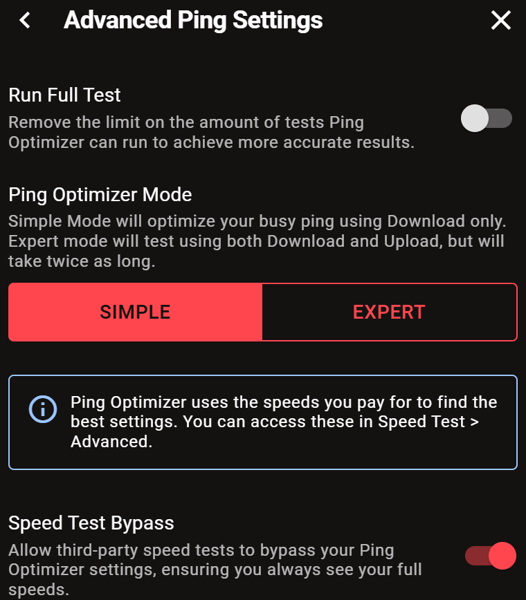

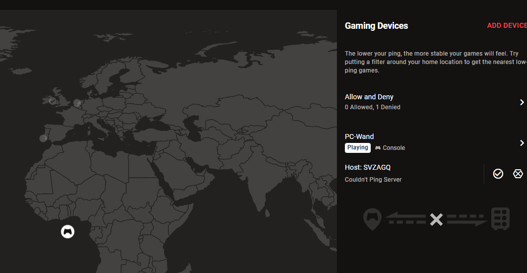

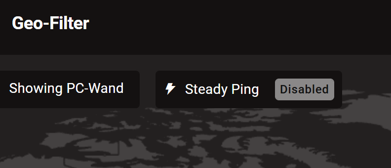

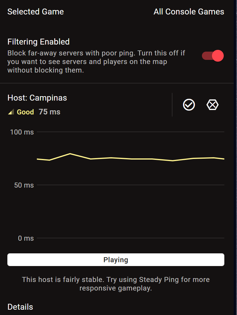

Administrators Netduma Fraser Posted October 6 Administrators Posted October 6 1 hour ago, Iced Soul said: I didn't find what you're telling me with the identical description. I took a screenshot and would like to ask you to please describe the route to me, as it's identified in DumaOS. Is there something wrong with my settings? An important thing to note is that on the Geo-Filter screen, when I click on the Host, it says I'm playing, even though the game isn't even open. What is the role of this host if it's different from my city? Another question. Under "Selected Game," it says "All Games." How do I put Call of Duty there? Geo-Latency/Ping Assist is in your first picture which you've disabled so that's good, just make sure to load in the way I mentioned. As your PC is set as a console in Device Manager (which I would recommend you keep so that the Geo-Filter does say All Games, having it selected for just CoD may reduce its effectiveness) it may pick up other things that are using ports above 1024 which is likely why you see a server there. I can't see what your Congestion Control settings are, you'd have to scroll down more on that window.
Iced Soul Posted October 6 Author Posted October 6 30 minutes ago, Netduma Fraser said: Geo-Latency/Ping Assist is in your first picture which you've disabled so that's good, just make sure to load in the way I mentioned. As your PC is set as a console in Device Manager (which I would recommend you keep so that the Geo-Filter does say All Games, having it selected for just CoD may reduce its effectiveness) it may pick up other things that are using ports above 1024 which is likely why you see a server there. I can't see what your Congestion Control settings are, you'd have to scroll down more on that window. This screen here? See, the host has now placed me in Africa.

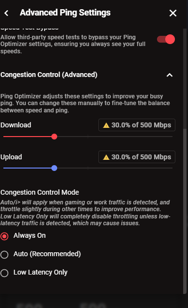

Administrators Netduma Fraser Posted October 6 Administrators Posted October 6 19 minutes ago, Iced Soul said: This screen here? See, the host has now placed me in Africa. That's right yes - 30% is super low, I'd be surprised if it needed to be that low, set it to 70% each for download & upload and see if that performs better. That's a mislocated server, should be Brazil by the looks of the ID. Was the game & game client (e.g. Steam etc) closed completely, including from the System Tray and then the Geo-Filter was enabled before you launched them?
Iced Soul Posted October 6 Author Posted October 6 3 minutes ago, Netduma Fraser said: That's right yes - 30% is super low, I'd be surprised if it needed to be that low, set it to 70% each for download & upload and see if that performs better. That's a mislocated server, should be Brazil by the looks of the ID. Was the game & game client (e.g. Steam etc) closed completely, including from the System Tray and then the Geo-Filter was enabled before you launched them? I didn't close the game client. I'm playing through Game Pass. I'll try 70%. Are all my other settings correct?
Administrators Netduma Fraser Posted October 6 Administrators Posted October 6 20 minutes ago, Iced Soul said: I didn't close the game client. I'm playing through Game Pass. I'll try 70%. Are all my other settings correct? Make sure to close that completely including from the system tray. Everything else looks fine
