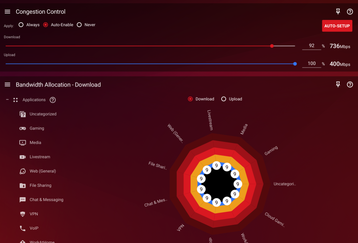

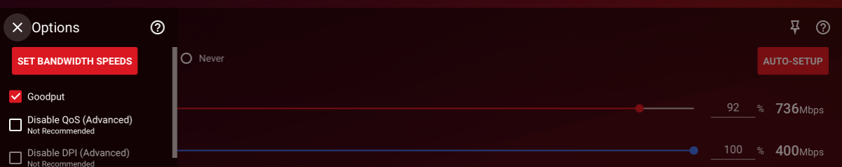

Administrators Netduma Fraser Posted July 25 Administrators Posted July 25 How have you set the box to ensure all traffic flows to the R2? E.g R2 in its DMZ, modem/bridge mode Are ALL devices connected to the R2? Have you entered your paid for/expected speeds into the router? How have you setup Congestion Control? Please provide a screenshot of the Device Manager table view
MetaPoivrot Posted July 28 Author Posted July 28 Hello Fraser, Yes, the box is only connected to the R2, all traffic goes through it. Yes all the devices are connected to the R2. Yes I entered the expected speed. Yes congestion control is active. Thx for your help!

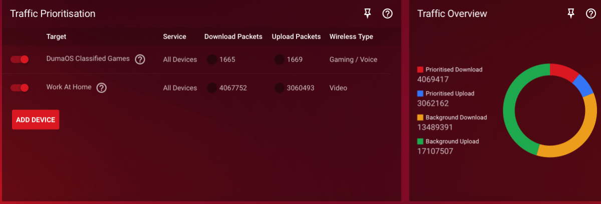

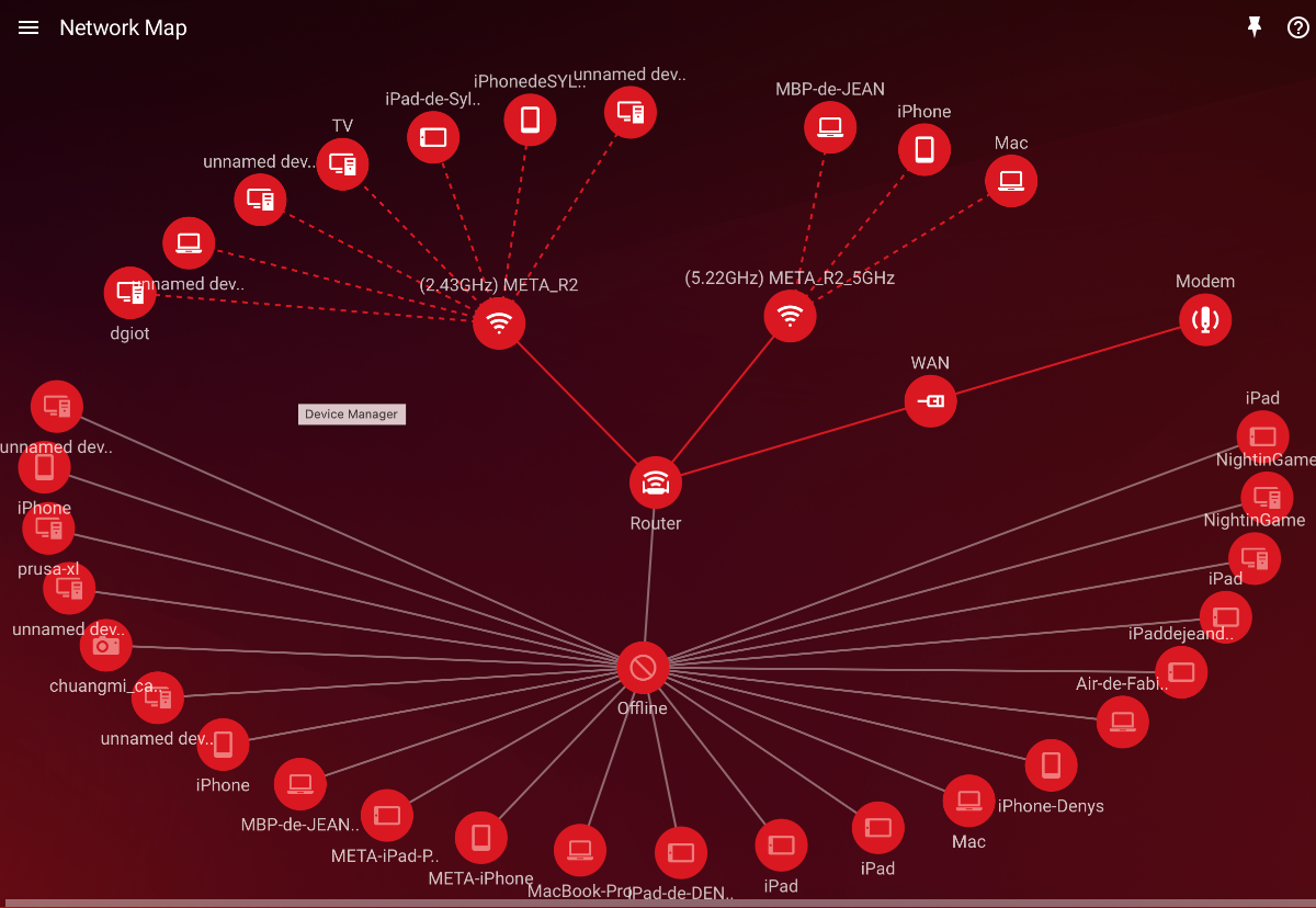

Administrators Netduma Fraser Posted July 28 Administrators Posted July 28 But have you set it in modem/bridge/DMZ if applicable? How have you set Congestion Control exactly? Click on Device Manager, switch to table view then provide a screenshot please.
MetaPoivrot Posted July 29 Author Posted July 29 Hello, I did not configure the DMZ on the modem. For reference, I always had very good speed without it. please find the screenshots.
Administrators Netduma Fraser Posted July 29 Administrators Posted July 29 4 hours ago, MetaPoivrot said: Hello, I did not configure the DMZ on the modem. For reference, I always had very good speed without it. please find the screenshots. I would definitely suggest you put the WAN IP of the R2 found on the System Information page into the DMZ on your modem. Click on Device Manager, switch to table view then provide a screenshot please.
