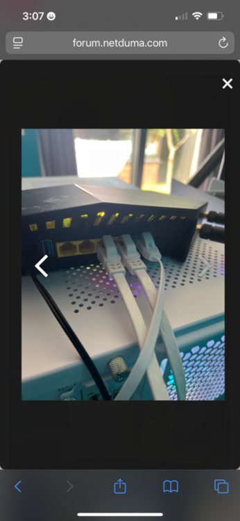

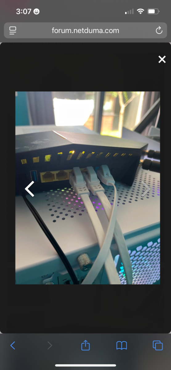

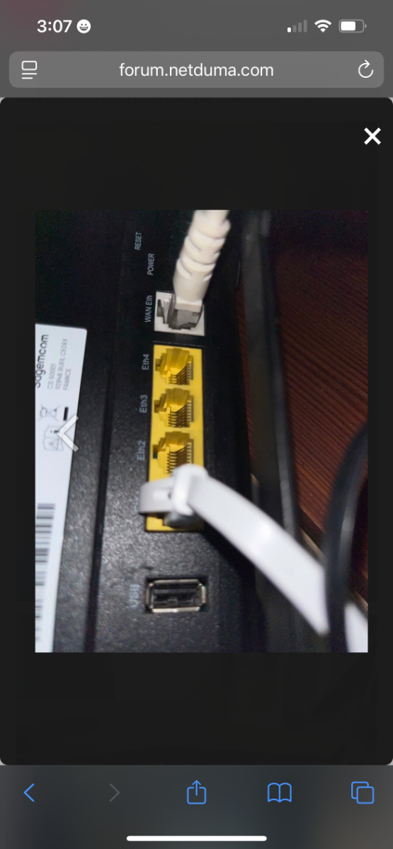

Krush Posted July 21, 2025 Posted July 21, 2025 ----------------- From the pictures I see, you just made a mistake in your wiring! You need to connect the R3 to your ISP modem/router... Modem/router - LAN Modem/router to WAN R3 - LAN R3 to your other devices!
Finkler Posted July 21, 2025 Author Posted July 21, 2025 Ok I can factory reset it and lyk but idk what those last things you said mean sorry.
Krush Posted July 21, 2025 Posted July 21, 2025 Test: Yellow RJ45 port of your ISP router to the Blue RJ45 port of the R3! (LAN FAI TO WAN R3)
Finkler Posted July 21, 2025 Author Posted July 21, 2025 Yep factory reset and it still doesn’t work.
Finkler Posted July 21, 2025 Author Posted July 21, 2025 Btw Krush I don’t understand what your saying as I already have it from lan to wan
Krush Posted July 21, 2025 Posted July 21, 2025 Have you made any changes to your Sagemcom ISP router upstream?
Krush Posted July 21, 2025 Posted July 21, 2025 Do your devices get a local IP (DHCP) behind your Sagemcom router/modem?

Krush Posted July 21, 2025 Posted July 21, 2025 I don't know! 😉 But maybe a video of your cabling from your internet source to the R3 could help!
Finkler Posted July 21, 2025 Author Posted July 21, 2025 It just a like across the floor I can show you pictures
Krush Posted July 21, 2025 Posted July 21, 2025 I agree with Fraser, if everything is wired correctly, it makes no sense.
Administrators Netduma Fraser Posted July 21, 2025 Administrators Posted July 21, 2025 You said in your other topic that you unplugged it and plugged it back in again, was it plugged back in in the exact same place with the same cable, no other differences etc?

RedBull2k Posted July 22, 2025 Posted July 22, 2025 If you plugged the ethernet from your hub straight to your console do you get Internet, take a pic of ur connection information taking note of lan ip etc.... just want to see what you get. Then we can change from dhcp to static using information we just previously found
RedBull2k Posted July 22, 2025 Posted July 22, 2025 Just to clarify I see your hub is getting its Internet connection via the ethernet wan, why not plug that cable into r3 wan and remove ur hub especially if you have an ont which im asuming you do
