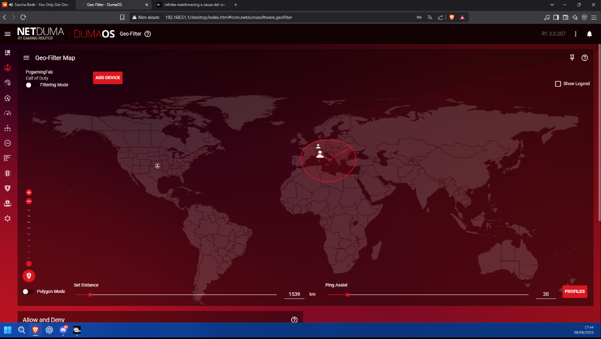

FabXi Posted June 9, 2025 Posted June 9, 2025 I double checked the R1 configuration and in this case it is configured with all the guidelines dictated by you! I tried to disable the filter and I had a friend host to find the game but it continues to say failed to connect! I attach screenshots where you can see the servers but it still does not connect.
Administrators Netduma Fraser Posted June 9, 2025 Administrators Posted June 9, 2025 58 minutes ago, FabXi said: I double checked the R1 configuration and in this case it is configured with all the guidelines dictated by you! I tried to disable the filter and I had a friend host to find the game but it continues to say failed to connect! I attach screenshots where you can see the servers but it still does not connect. Yeah the team will need to look into it, it doesn't make any sense really FabXi 1
