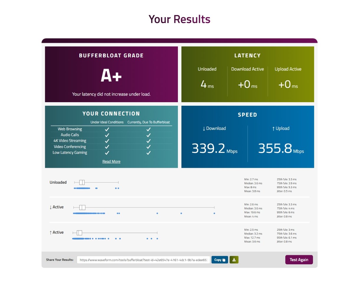

Popular Post satinghostrider Posted February 13, 2025 Popular Post Posted February 13, 2025 For anyone anyone that wants good hitreg on BO6, this is my setup based on 1Gbps fibre Internet. 1. I've set congestion control to 50.5% for both up and down which gives me the best bufferbloat results. When tuning for Bufferbloat, pay attention to Jitter. Try and get it under 10ms. I managed to get mine under 3ms as I have very good Internet here in my country. 2. Set Congestion Control to Auto or Recommended. I keep mine on Always On unless I have big downloads. 3. I only prioritised Call of Duty (Series) for Apps and my PC for device. You don't need to prioritise Call Of Duty (Content) as @YT_LowPingKinghas mentioned in his videos Call of Duty (Series) covers Call of Duty (Content) as well. Focus on getting your Jitter as low as possible. I've noticed tremendous consistency and crispy hitregs just by doing this. I've uploaded a video of my gameplay and its been very consistent from game to game. Do give it a try and hope this helps. Nothing complicated to setup as the router does everything properly with 540 firmware but Geofilter is kinda broken now as it doesn't indicate which server on the map its connecting to anymore. I hope this can be fixed in the next update. And do factory reset your router after upgrading to 540 firmware. I got away without doing factory reset last few updates but 540 firmware wasn't having it. Had ping spikes and weird issues until I factory reset and it was GOLDEN. Alex49H, MainLifeline, YT_LowPingKing and 3 others 3 3

satinghostrider Posted February 14, 2025 Posted February 14, 2025 7 hours ago, Nj12 said: I've noticed low jitter equals better hit registration. But the only firmware versions that maintain the low jitter after adjusting congestion control are .227 and .236. Every version since the jitter drifts upward after dialing it in. Yes mine drifts upwards slightly more on 540 at times to 5ms but generally I'm around 3ms or less. I also feel more often than not it's also the quality of your internet.
VeeDot Posted February 20, 2025 Posted February 20, 2025 yeah ive navigated my entire CC and i was getting 0 0 a+ on bufferbloat but now i cant even get anything less than a B and my jitter is through the roof lol
