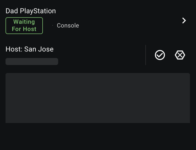

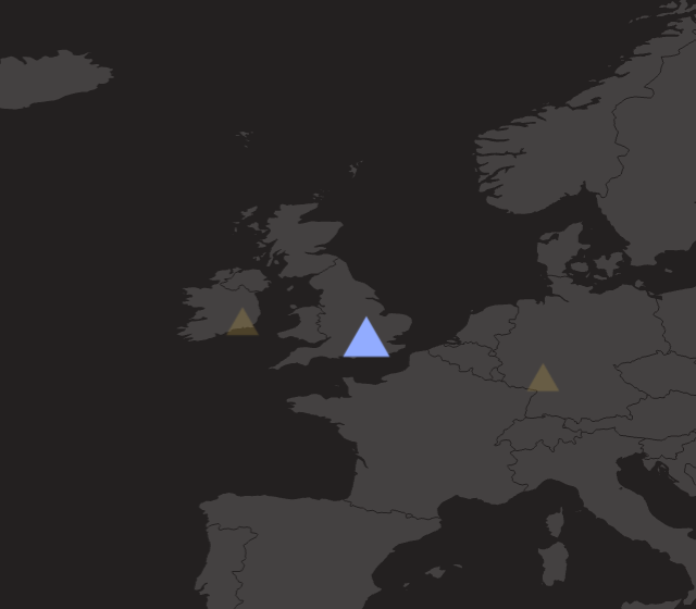

alex..devine Posted May 3 Posted May 3 Hi, It seems there are some issues. I want to connect to the UK server. When I place my device and location over the UK, it does not show the UK server. (Please do not tell me there are no UK servers, I have checked at 9am, 12pm, 3pm, 6pm, 9pm and 11pm). If I move my device to the USA, it then pings and shows the UK server, and I can fav the server location. I have done all the same troubleshooting, removing the device, adding it again, etc., etc. The first Screenshot shows the UK server when my device is set to the USA. The second screenshot shows the UK server active but always tries to connect to the Frankfurt server, this server is rubbish, that is why I have blacklisted it out the filter. I cannot find ANY games when I blacklist the Frankfurt server; it just acts as if I am going into a game, and does not start the map load, it just refreshes the Start search. What is going on?
Administrators Netduma Fraser Posted May 3 Administrators Posted May 3 Presumably you mean during the launch of the game, in which case it does happen where the servers inside your radius at the time don't appear but it doesn't mean you won't connect to them. The cause of your issue here is because the server in Ireland from your first screenshot should be whitelisted and its being blocked instead so there are new authentication servers we're not yet aware of. You'll need to allow any servers that appear there - it may take a few tries and then it should work normally. If you could then provide the IDs we can get them whitelisted.

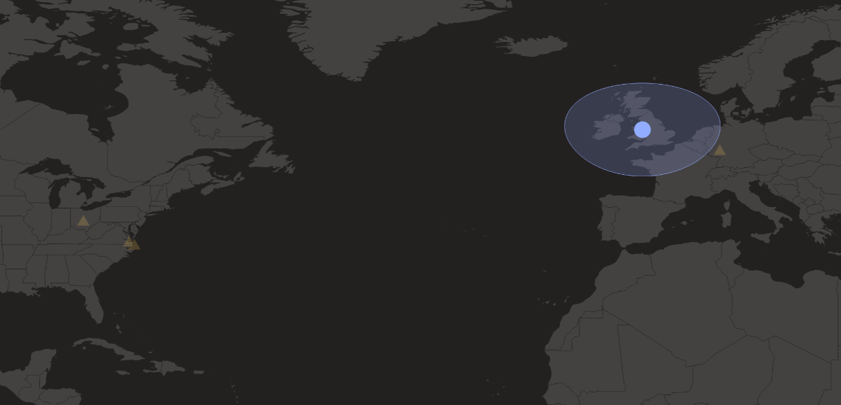

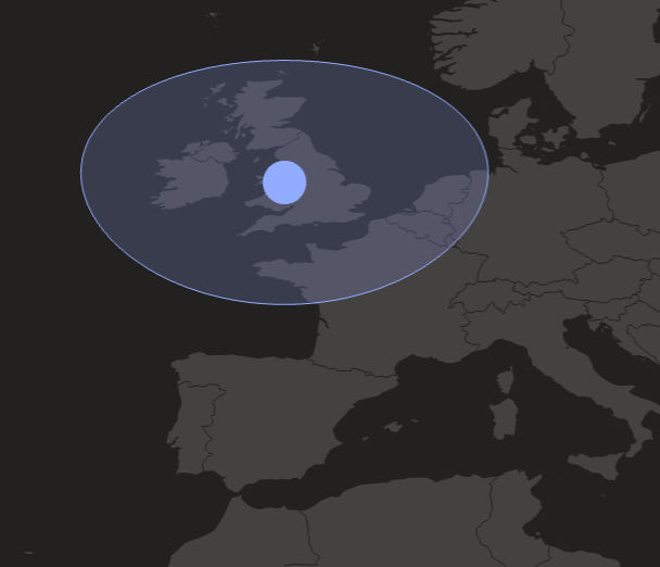

alex..devine Posted May 3 Author Posted May 3 Sorry that was the wrong photo, please see my attached. I have it over the the UK, see attached. It does not detect any servers when searching for a game, and it try to load me into a game and crashes back to the search button, BF6! There is something wrong, it is trying to connect me to San Jose and other far way servers!
alex..devine Posted May 3 Author Posted May 3 It is pinging all servers all over the world but not the UK.

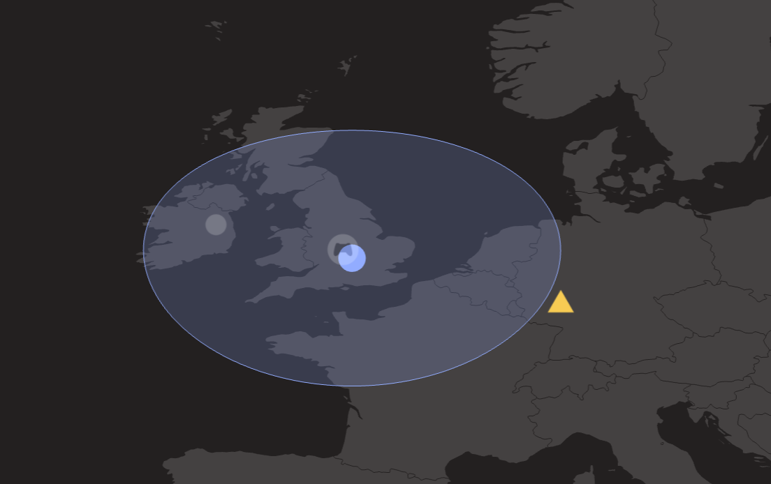

damir117 Posted May 4 Posted May 4 It doesn’t work for me either if I filter only the UK, then it tries to connect to servers around the world. If I filter only GE, then it always connects to GE. Latest firmware also. Something with UK servers is issue
Administrators Netduma Fraser Posted May 4 Administrators Posted May 4 It's essential the Geo-Filter is enabled before the game client or the game have been launched. If you change Geo-Filter settings when you're on the game then you will need to restart the game for those changes to take effect, otherwise it will use the previous Geo-Filter settings and appear not to be working.
