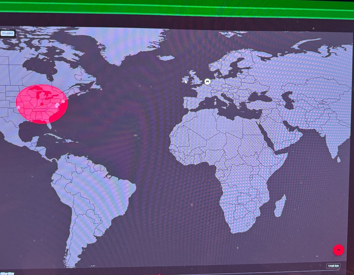

RichardB Posted 5 hours ago Posted 5 hours ago Hi, I just got a Netduma router and I’m trying to connect to US servers from Europe, but it just keeps searching and never connect me to a server. I’m targeting the closest US servers that I already know should work. I can actually see that the game detects the servers while searching, but it never connects to a lobby. Here are my settings: - Strict Mode: On - Geo-Latency: Off - Steady Ping: Off - I’ve set the filter around the areas where I know the US servers are Does anyone know what could be causing this or what I should change? Also, do I need to move my “home location” to the US for this to work?
Administrators Netduma Fraser Posted 4 hours ago Administrators Posted 4 hours ago Do keep in mind it's for getting your closest servers not ones further away and that the game may have their own restrictions making it more difficult given the ping you would have. What platform are you playing on?
RichardB Posted 3 hours ago Author Posted 3 hours ago I am on pc. I connect to these servers with exitlag many times and the ping is not to much so it should not be a problem but I maybe doing something wrong?
Administrators Netduma Fraser Posted 3 hours ago Administrators Posted 3 hours ago Do this: Quit the application/game/client completely - including the game client from the System Tray - important! Remove device from the Geo-Filter Give the PC the PlayStation Device Type in the Device Manager Resync from the Geo-Filter Map menu Re-add the device to the Geo-Filter Set up the Geo-Filter how you like Wait 2 minutes Boot up application/game/client It's essential the Geo-Filter is enabled before the game client/game have been launched. If you change Geo-Filter settings when you're on the game then you will need to restart the game for those changes to take effect, otherwise it will use the previous Geo-Filter settings and appear not to be working.
RichardB Posted 3 hours ago Author Posted 3 hours ago Okey, thanks! Will let you know if it works Netduma Fraser 1
