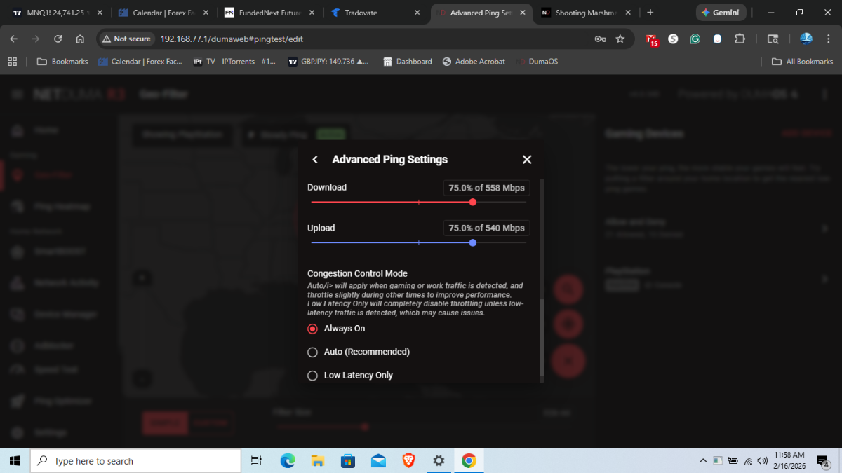

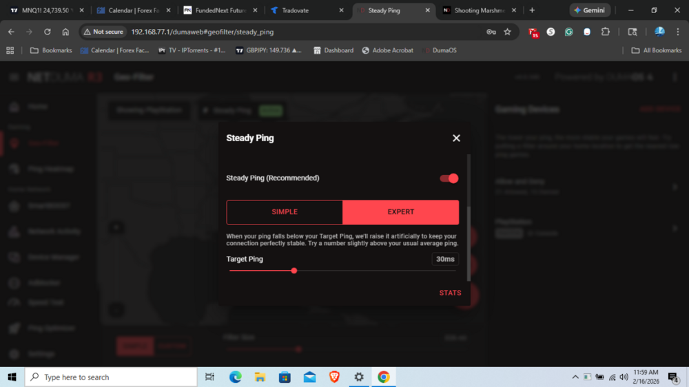

scbba Posted February 16 Posted February 16 No matter what setting I have on the r3 Im shooting marshmallows in all fps games. I have 500/500 down fiber by Live Oak with MoCA 2.5 because where I live atm, I can't run wired from the ONT. I gave the sliders at 70/70 steady ping at 32ms because I have one of my hops between 11ms and 7ms. My base ping to the servers is about 15ms to 19ms, depending on which server in Atlanta I connect to. We don't have a lot of activity its just me and 1 other person using the internet I use wired, and they use wireless. I have the 70/70 set to always. I've tried turning off steady ping and smart boost, and it's still the same results. Does anyone know what I'm missing? I forgot to mention I am on the last R3 firmware as I have only had it for 2 weeks.

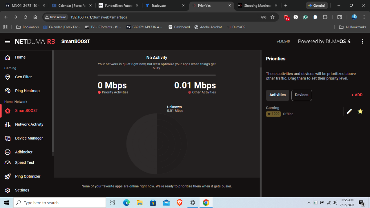

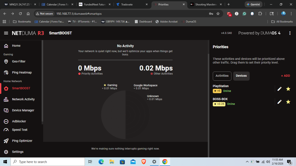

Administrators Netduma Fraser Posted February 16 Administrators Posted February 16 Have you adjusted from 70%? That is only a starting point so there may be a better percentage for you. By steady ping at 32ms does that mean you're using expert? If so switch to simple and try with that. Force a server slightly further away, even if it has a higher ping it may play better. How do you have SmartBOOST set?
scbba Posted February 16 Author Posted February 16 Ive tried from 60 to 100 on sliders and I have tried simple and expert with no change. I even went as far as buying a public ip to get away from cgnat

Rodolfo Lima Posted February 20 Posted February 20 On 16/02/2026 at 16:15, scbba said: Ok, vou reorganizar o filtro geográfico esta semana e volto com novidades no fim de semana. Vc recebe 500/ 500 vá em teste de velocidade do R3 configure 300/ 300 sem seguida vá e cc e ponha 65 de download e 70 para upload e vê se melhora, outra coisa não há necessidade de por PS5 no SmartBOOST ao meu ver.
