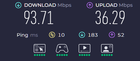

BigPapyto Posted December 13, 2025 Author Posted December 13, 2025 8 hours ago, Netduma Fraser said: Glad to hear it's working for the moment, do keep us posted Update, Day 2 The speeds have reverted to low speeds on both ethernet and wifi, I just tested them, and both came out to about 93mbps.

BigPapyto Posted December 13, 2025 Author Posted December 13, 2025 23 minutes ago, BigPapyto said: Update, Day 2 The speeds have reverted to low speeds on both ethernet and wifi, I just tested them, and both came out to about 93mbps. It seems that I have found that everytime I disconnect and reconnect my WAN cable to the R3 I find that the speeds revert back to normal speeds, I don't know how long they last but I will try downloading something to see if they do.
