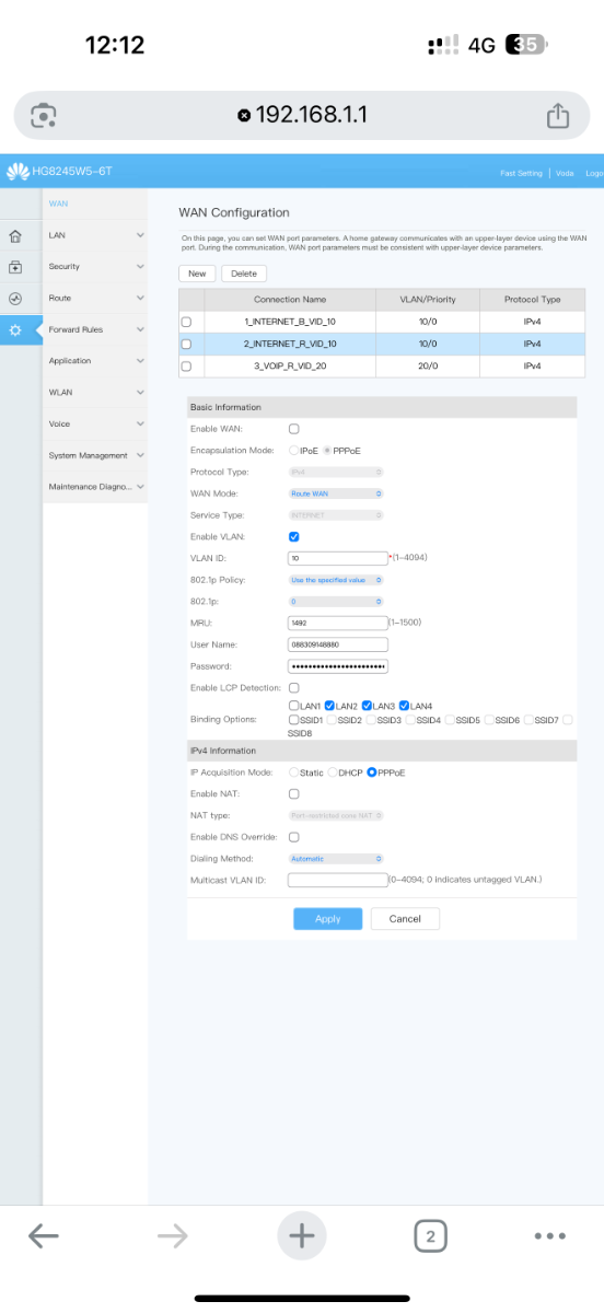

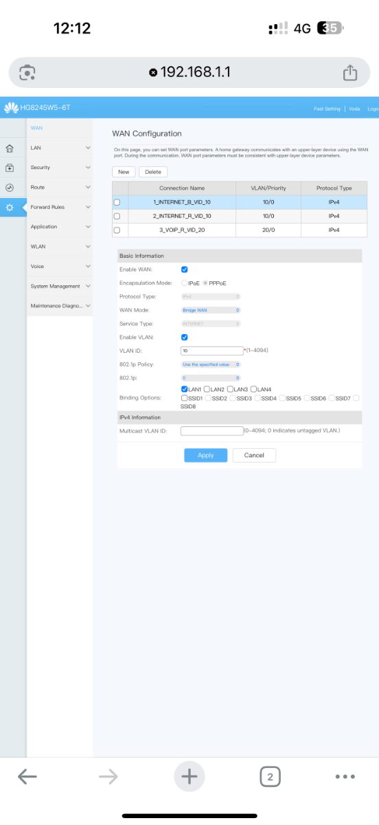

Mohamed87 Posted October 21, 2025 Posted October 21, 2025 I’m using Vodafone Fiber, and the ISP ONT requires VLAN 10. However, when I configure VLAN 10 on my R3, the internet disconnects completely. If I leave the VLAN field empty, the internet connects, but it randomly disconnects from time to time.
Administrators Netduma Fraser Posted October 21, 2025 Administrators Posted October 21, 2025 You're saying the ONT requires VLAN 10, does that mean the ONT is actually set to use 10 for VLAN? If so then you do not need to input this into the R3 as well. How often are you disconnecting? When it happens again please grab the logs from Settings prior to rebooting and we can take a look. Mohamed87 1
Mohamed87 Posted October 21, 2025 Author Posted October 21, 2025 Before I created the new Router WAN profile, the internet used to disconnect around 4–5 times per day. After setting up the new profile, it now only disconnects 1–2 times a day. When it happens again, I’ll send you the logs before rebooting the router.
Administrators Netduma Fraser Posted October 21, 2025 Administrators Posted October 21, 2025 You should delete the first profile and for the second then apply it to LAN1 as well and see if that fixes it. Mohamed87 1
Krush Posted October 21, 2025 Posted October 21, 2025 Ton FAI utilises PPPoE et Vlan ID pour contourner leur routeur ! As tu garder la configuration PPPoE sur le R3 ? - Soit tu utilises le R3 derrière l'ONT avec les informations Vlan 10 et PPPoE (Plus de VOIP) - Soit tu utilises ton routeur FAI derrière L'ONT et le R3 en DHCP @Netduma Fraser C'est le même cas de figue que Turk Telekom ... ----- Si tu nous donnes le nom de ton FAI et une photo de ta configuration (ONT-ROUTEUR-R3), je suis sûr que nous pouvons t'aider !😉----
Mohamed87 Posted October 21, 2025 Author Posted October 21, 2025 the first profile is The first profile is actually the bridge one. Previously, I had deleted the router and VoIP profiles, and the WAN was disconnecting about 4–5 times a day. After I restored those profiles and disabled the WAN on the router profile, it now disconnects only 1–2 times a day.

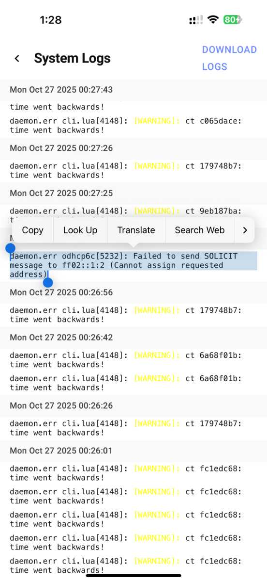

Mohamed87 Posted October 26, 2025 Author Posted October 26, 2025 Hello I’m using a Netduma R3 router and I’ve noticed two recurring issues in my system logs, even though IPv6 is fully disabled on both the ONT and the router, and the time is correctly synchronized on both devices. 1. Every few minutes, I see this log entry repeating: daemon.err odhcp6c[xxxx]: Failed to send SOLICIT message to ff02::1:2 (Cannot assign requested address) 2. I also keep getting time-related warnings such as: [WARNING]: time went backwards or system time jumps detected in log The router is currently running in bridge mode (ONT handles PPPoE) and i tried DMZ method also IPv6 is disabled on both sides. Despite that, these messages keep showing up every 4–5 minutes, and sometimes the internet briefly drops when they appear. Could you please confirm: - Why odhcp6c is still running even with IPv6 disabled? - Whether there’s a firmware fix or hidden setting to fully stop the IPv6 client or the time sync conflict? If possible, please enable SSH access temporarily on my device so I can collect diagnostic information for you. if this error may cause the drop in internet
Administrators Netduma Fraser Posted October 26, 2025 Administrators Posted October 26, 2025 35 minutes ago, Mohamed87 said: Hello I’m using a Netduma R3 router and I’ve noticed two recurring issues in my system logs, even though IPv6 is fully disabled on both the ONT and the router, and the time is correctly synchronized on both devices. 1. Every few minutes, I see this log entry repeating: daemon.err odhcp6c[xxxx]: Failed to send SOLICIT message to ff02::1:2 (Cannot assign requested address) 2. I also keep getting time-related warnings such as: [WARNING]: time went backwards or system time jumps detected in log The router is currently running in bridge mode (ONT handles PPPoE) and i tried DMZ method also IPv6 is disabled on both sides. Despite that, these messages keep showing up every 4–5 minutes, and sometimes the internet briefly drops when they appear. Could you please confirm: - Why odhcp6c is still running even with IPv6 disabled? - Whether there’s a firmware fix or hidden setting to fully stop the IPv6 client or the time sync conflict? If possible, please enable SSH access temporarily on my device so I can collect diagnostic information for you. if this error may cause the drop in internet You can ignore both of these, they're just log spam, they won't be causing you any issues. It's very likely a lease renewal happening for a device when the connection briefly drops. We don't allow SSH access. Mohamed87 1
