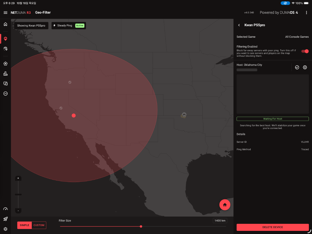

akuronoka0617 Posted October 16, 2025 Posted October 16, 2025 I’m experiencing another issue where matching is not working properly. Occasionally, it does match, but most of the time, it seems to fail. When I checked the geofilter settings, I had set the geofence to the U.S. West Coast region, but it says it matched with a server in Oklahoma, which is outside the geofence, and the matching still doesn’t work. Could you please suggest any solutions for this? One notable detail is that when matching works, it shows a server within the U.S. West Coast region set by the geofilter, but when it doesn’t work, it always indicates a connection to an Oklahoma city server. adro 1

Administrators Netduma Fraser Posted October 16, 2025 Administrators Posted October 16, 2025 There is a cloud update mid release currently that should help with this, you should have it by the end of the week

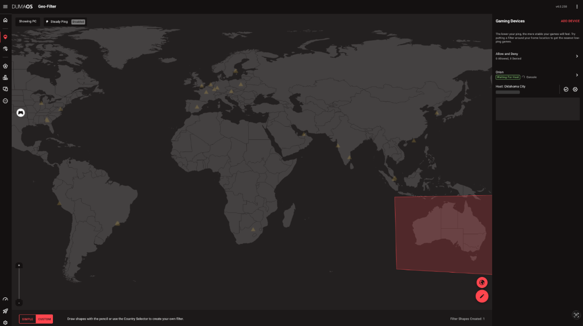

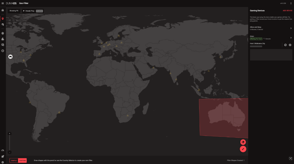

adro Posted October 22, 2025 Posted October 22, 2025 I have the same issue with the Oklahoma server in BF6! I selected Sydney server and it's not connecting me to it! The Oklahoma server keeps coming up and nothing happens when I search! I have tried removing and re adding and it's not working! When I selected the Middle East server it was working, but can't get the Sydney server to work. I believe it was the same problem in the BF6 beta and Netduma still hasn't fixed the issue. The Sydney server is also missing on the ping heat map, even though there is 100% a server there as I know Australian players with 3 ping.
