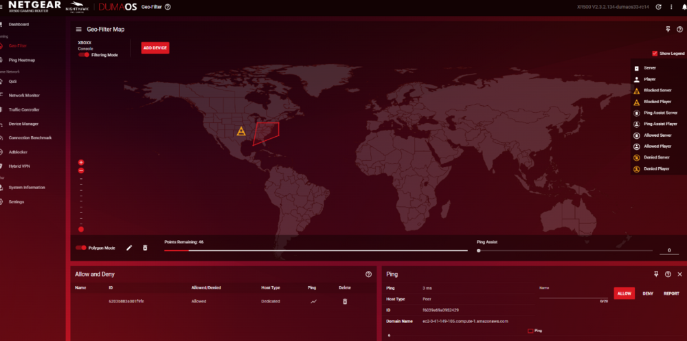

lefteris.lydios Posted October 12, 2025 Author Posted October 12, 2025 Here is a screenshot with the issue: I have Geofilter on UAE and SA servers , the Host says Oklahoma with a ridiculously low ping and my in game ping shows ~35 ms meaning I am somewhere within EU. Probably Amsterdam. My GeoLatency is off.
Administrators Netduma Fraser Posted October 12, 2025 Administrators Posted October 12, 2025 It's a German server so it's a mislocated server, I'll get the team to correct it. Make sure you follow the steps I mentioned again, as you're on a console actually shut it down (not in standby/instant on), make sure the Geo-Filter is enabled before you turn on the console and do not change Geo-Filter settings while on the game. Ping Assist should also be off and try just with the normal radius and moving your location to force the server you want or do the country selection instead.
