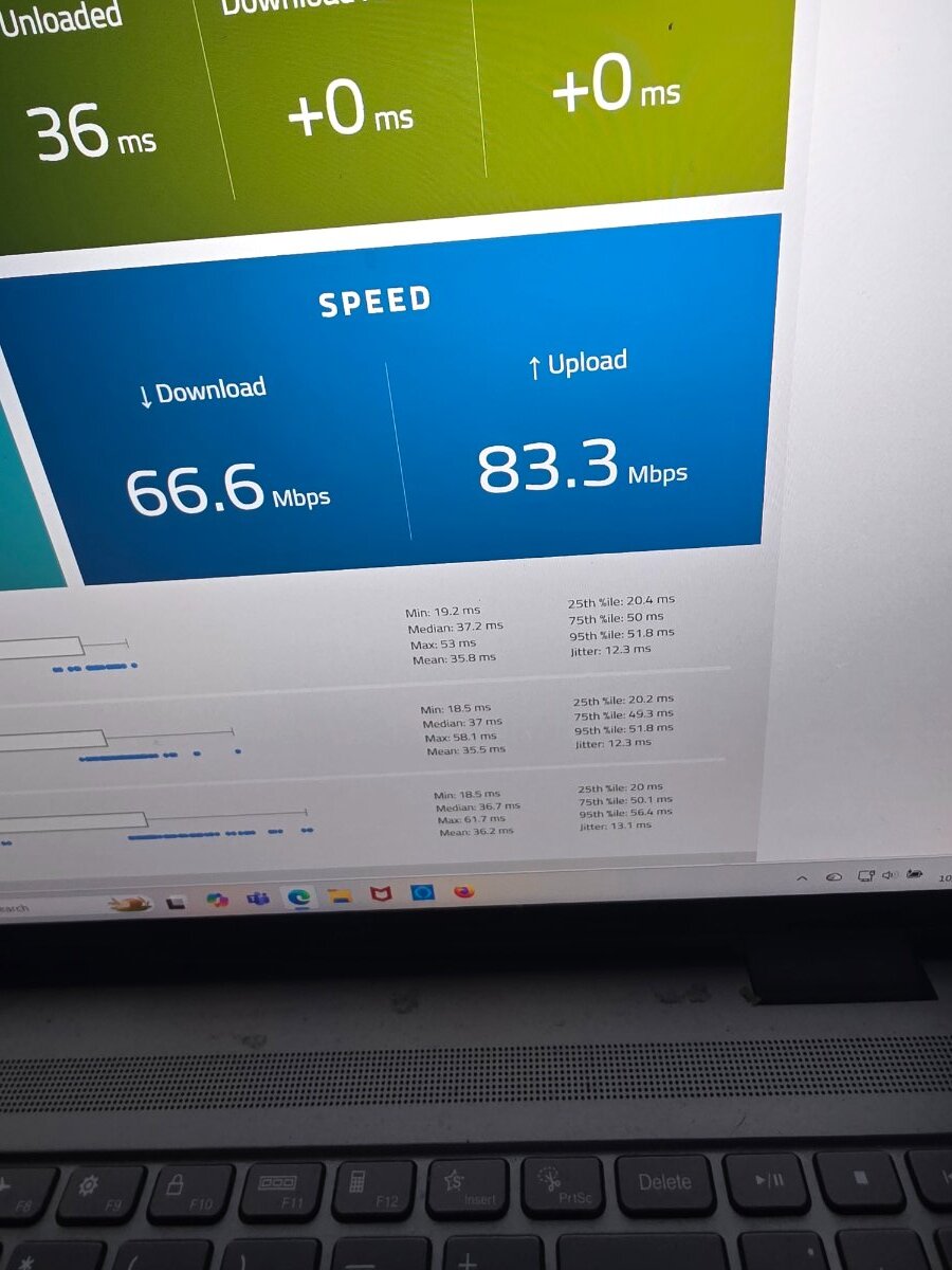

Reykc9510 Posted October 16, 2025 Author Posted October 16, 2025 1 hour ago, Netduma Fraser said: You can still use the radius but you should cover servers you know roughly what you will ping to (use Ping Heatmap) so you can select the next lowest ping servers. The further away the servers are the higher ping they'll have and the worse they'll play. So when im using the bufferbloat it just randomly selecting a server in my radius on geo filter? I thought buffer bloat jusr tests your network? This screenshot is right now see how it changed from this morning
Administrators Netduma Fraser Posted October 16, 2025 Administrators Posted October 16, 2025 1 hour ago, Reykc9510 said: Ok an that makes the jitter bad also? That's mainly what my issue has been. 8 minutes ago, Reykc9510 said: So when im using the bufferbloat it just randomly selecting a server in my radius on geo filter? I thought buffer bloat jusr tests your network? This screenshot is right now see how it changed from this morning Yes playing on a further away server is likely to worsen your jitter. No, the Geo-Filter and your bufferbloat test are not connected. The Geo-Filter shows game servers you connect to, it is highly unlikely to show the bufferbloat server you're using. The bufferbloat server could be anywhere, that's the point, doing the test at different times of the day could have you connecting to different servers and therefore getting different results. This is why I as well as Darkness said not to put too much emphasis on its results. Yes it is testing your network utilizing a server for the test. Here is an analogy for you. Your ping without bufferbloat is like driving your car on an empty road, you're going to a location and you know how long it will take you to get there, for example 20 minutes. This could be your baseline ping for example 20ms. Your ping with bufferbloat is like driving your car on a road with traffic, you're going to the same location and you know how long it should take you to get there (e.g. the 20 minutes), however due to the bad traffic it actually takes you 40 minutes to get to the same destination. Your ping here could be 40ms for example. In regards to the server the bufferbloat test is using, without a destination to test it against you can't get a ping value or a destination to drive to. Now imagine your place of work changed depending on the time of day and the time you start work changes as well therefore it could take you anywhere from 10 minutes to 1hr to get there. Would you be so confident to say that it takes you 10 minutes to commute to work everyday? Without knowing the server the bufferbloat test is using your results cannot be 100% trusted. That's why the pingplotter suggestion is better, you know the exact server you're using, you do a test to establish your baseline ping (ping without bufferbloat) and then apply traffic and your ping raises, just like road traffic extends your journey time and then you apply Congestion Control to limit the effect that traffic has on your ping. There really isn't anything else we can advise honestly: You've established it's an issue without the R3 - that automatically eliminates us personally from needing to troubleshoot with you We've advised you select the closest possible servers, this will help lower the ping and improve stability (jitter) We've advised you on how to effectively test and set your Congestion Control percentages to lower your ping and improve stability when bufferbloat would ordinarily apply Krush and DARKNESS 1 1
Reykc9510 Posted October 16, 2025 Author Posted October 16, 2025 23 minutes ago, Netduma Fraser said: Yes playing on a further away server is likely to worsen your jitter. No, the Geo-Filter and your bufferbloat test are not connected. The Geo-Filter shows game servers you connect to, it is highly unlikely to show the bufferbloat server you're using. The bufferbloat server could be anywhere, that's the point, doing the test at different times of the day could have you connecting to different servers and therefore getting different results. This is why I as well as Darkness said not to put too much emphasis on its results. Yes it is testing your network utilizing a server for the test. Here is an analogy for you. Your ping without bufferbloat is like driving your car on an empty road, you're going to a location and you know how long it will take you to get there, for example 20 minutes. This could be your baseline ping for example 20ms. Your ping with bufferbloat is like driving your car on a road with traffic, you're going to the same location and you know how long it should take you to get there (e.g. the 20 minutes), however due to the bad traffic it actually takes you 40 minutes to get to the same destination. Your ping here could be 40ms for example. In regards to the server the bufferbloat test is using, without a destination to test it against you can't get a ping value or a destination to drive to. Now imagine your place of work changed depending on the time of day and the time you start work changes as well therefore it could take you anywhere from 10 minutes to 1hr to get there. Would you be so confident to say that it takes you 10 minutes to commute to work everyday? Without knowing the server the bufferbloat test is using your results cannot be 100% trusted. That's why the pingplotter suggestion is better, you know the exact server you're using, you do a test to establish your baseline ping (ping without bufferbloat) and then apply traffic and your ping raises, just like road traffic extends your journey time and then you apply Congestion Control to limit the effect that traffic has on your ping. There really isn't anything else we can advise honestly: You've established it's an issue without the R3 - that automatically eliminates us personally from needing to troubleshoot with you We've advised you select the closest possible servers, this will help lower the ping and improve stability (jitter) We've advised you on how to effectively test and set your Congestion Control percentages to lower your ping and improve stability when bufferbloat would ordinarily apply Thank you I appreciate it Netduma Fraser 1
