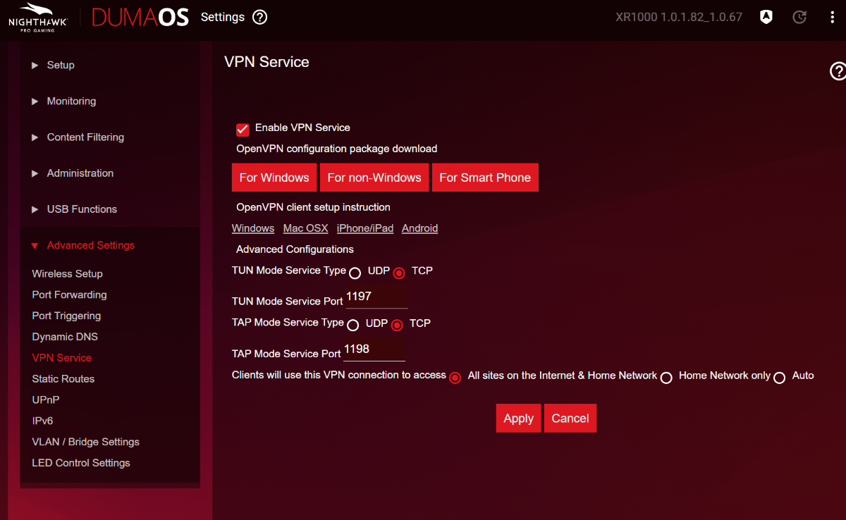

Just updated to XR1000 1.0.1.82_1.0.67 on my XR1000. When I enable the VPN service using UDP or TCP my router stops routing packets out to the internet. So anything on the internal lan fails to route out to the internet.
Once I disable the VPN service on the router  everything immediately starts working again.

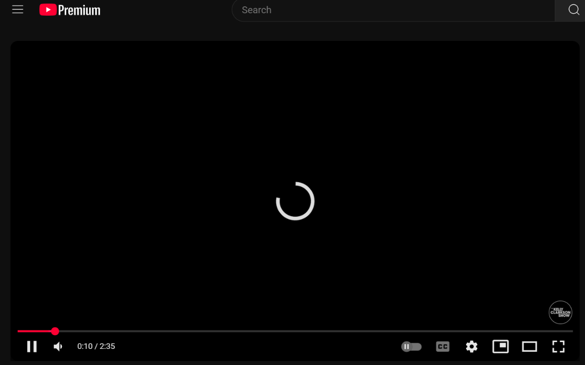

No go connecting to VPN remotely. It connects but nothing routes.
Attached are the iamges, once enabled it looses all internet or does not route packets out.
Immediately upon unchecking the check box and applying everything instantly works.
Took the router to a friends house stuck in place of his, same issue there as well.

Have you got any port forwarding rules that cover the same port shown on the VPN service page/do you have the DMZ enabled? If so disable then try again. Otherwise try another port instead anyway and see if the same occurs
Posted
No DMZ enable, one port forward for a plex server using port 32400 I think.
Im going to revert to 10174 and see what happens, since I was fine there. I must be the only one using OpenVPN settings ;-). Going to move to twingate I think for remote access.

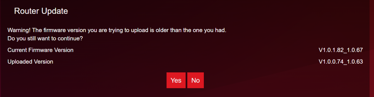

Posted
Odd Frazier that this screen never pops up when trying to update the latest beta fix firmware. Just thought of this, it just gets so far and reboots on my other XR1000. Just an FYI.
I know not related to this, but doing this triggered that ;-)..

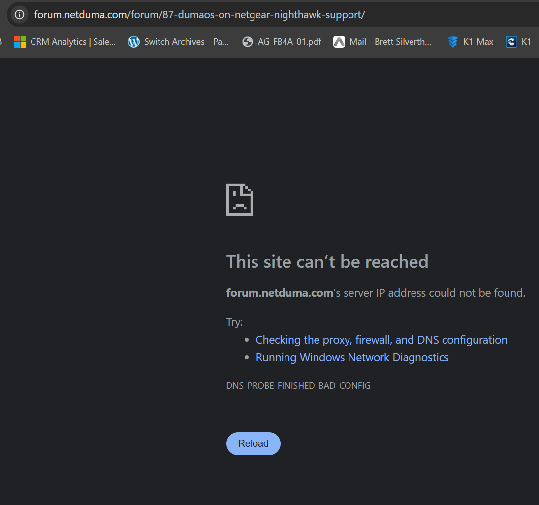

Posted
I was finally able to duplicate on a second XR1000.
  • The setup is as follows:
  • Enable DHCP
  • Enable ddns
  • Enable OpenVPN server
Those three enabled together and DNS fails to work. I can navigate the internet and FTP if I know the IP address of where I want to go. Disable DHCP, it works fine again. Disable OpenVPN Server on router it works fine again. If either of two are disabled then the router seems to resolve names.
Happening on both my XR1000s.
The moment I turn off DHCP and let my PiHole do DHCP for the network I can then my openvpn server running on the router just fine. If I put either of the routers with the above config, DNS appears to stop working. If I assign a DNS server to the NIC of any PC or MAC when this happens I am fine. So something with the three enabled, kills DNS.
Nothing in the logs, it looks pretty normal. Does not matter what subnet I move either of the routers too, just enable the 3 and instantly DNS fails. No port forwarding etc.. Just right off a factory reset, both XR's do the same thing. For now I just turned off the VPN and went to twingate, which is fine. My concern is I am wondering if this why on previous firmwares I would need to reboot so often, it was masked by something else. Unfortnately I still can not update one of the routers even to the new firmware. But they are a version apart, didnt make any difference anyway.
