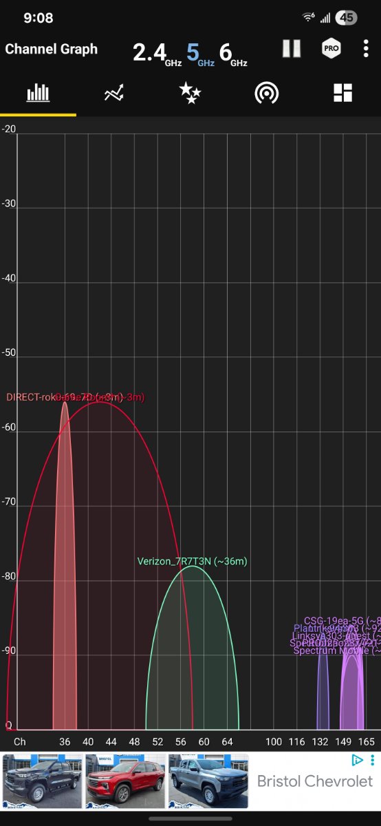

Heroxoot Posted Saturday at 01:14 PM Author Share Posted Saturday at 01:14 PM So this is basically what it looks like on the other side of the house. I'm still getting a strong signal. 2.4ghz is again, exclusive to smart devices as I mostly bought the router to handle a ton of wifi devices. my 5ghz is the fat red curve. Link to comment Share on other sites More sharing options...
