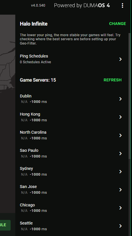

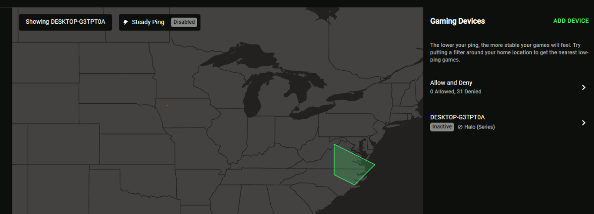

Tru ELiTE Posted June 23, 2025 Posted June 23, 2025 The Halo Infinite Geo Filter is still working? I'm constantly getting many servers that are out of my filter radius. I literally have 31 servers denied, and I'm still getting them. The Ping heat map for Halo servers shows 1000ms for every server on top of that. Please assist!
Administrators Netduma Fraser Posted June 23, 2025 Administrators Posted June 23, 2025 Do this: Quit the application/game/client completely Remove device from the Geo-Filter Give PC PlayStation Device Type in the Device Manager Resync from the Geo-Filter Map menu Re-add the device to the Geo-Filter Set up the Geo-Filter how you like Wait 2 minutes Boot up application/game/client See if it works then and in the meantime I'll let the team know that a Ping Heatmap update is needed for the game. Zippy 1
Tru ELiTE Posted June 23, 2025 Author Posted June 23, 2025 OK I just changed setting now, I will see. Netduma Fraser 1
Tru ELiTE Posted June 24, 2025 Author Posted June 24, 2025 na, it still happening. Does the Ping heatmap effect the geo filter?

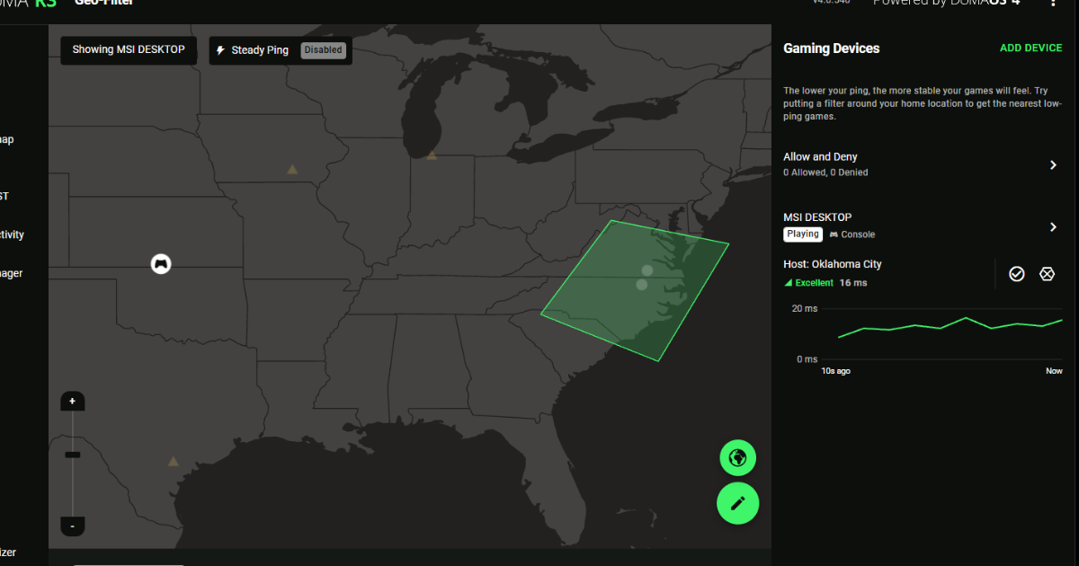

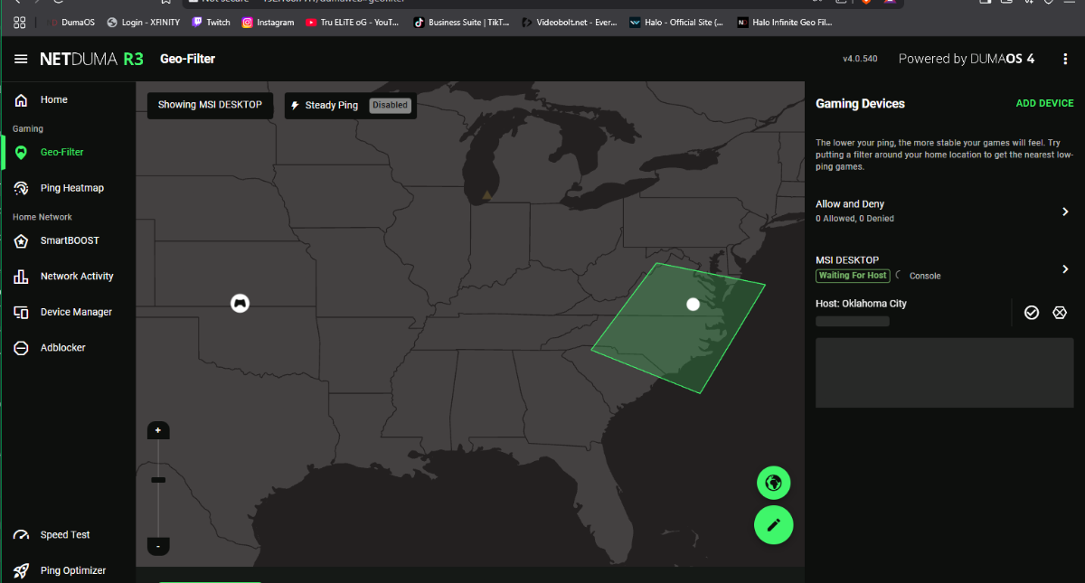

Administrators Netduma Fraser Posted June 24, 2025 Administrators Posted June 24, 2025 13 hours ago, Tru ELiTE said: na, it still happening. Does the Ping heatmap effect the geo filter? Can you provide a screenshot of the Geo-Filter page showing what you see when you get a game outside your radius please? No the heatmap doesn't affect the Geo-Filter 12 hours ago, ORAMAS said: The same thing happened here with The Finals. It connects to Madrid and Omaha, but not to any servers in the East. Strict Mode and Geo-latency are active or not—it makes no difference. Still happening. Maybe a bug with the game. Actual firmware .645 ScreenRecording_06-23-2025 20-46-30_1.mp4 Your video isn't loading, I'd suggest making a new topic for your issue, if you could also include a screenshot of what you see on the Geo-Filter in that topic please

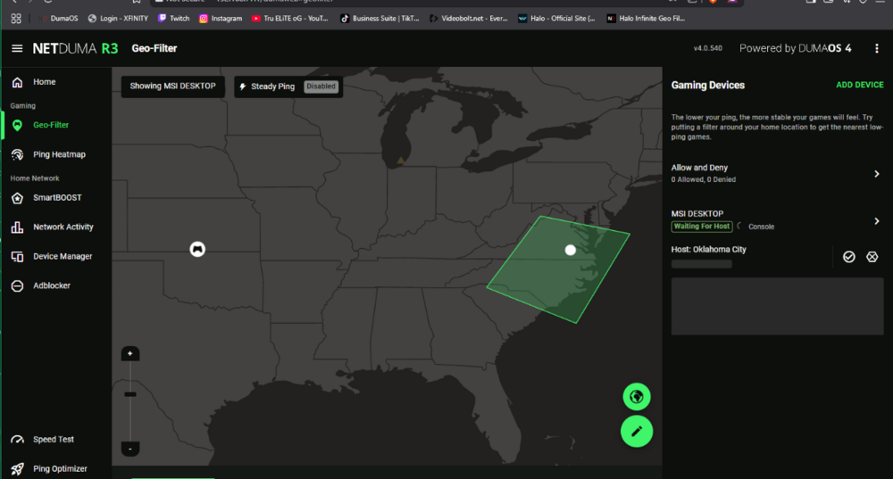

Administrators Netduma Fraser Posted June 24, 2025 Administrators Posted June 24, 2025 Does it always seem to be in Oklahoma? We have seen a lot there that may be incorrectly whitelisted
Tru ELiTE Posted June 24, 2025 Author Posted June 24, 2025 it goes to Oklahoma then chicago also texas.
Tru ELiTE Posted June 24, 2025 Author Posted June 24, 2025 i have nothing allowed nor denied. i had about 35 servers blocked. then i started to get time out because it would choose the blocked servers
Administrators Netduma Fraser Posted June 26, 2025 Administrators Posted June 26, 2025 It would be on the global whitelist, not on your side, I'll pass it onto the team to have a look

Tru ELiTE Posted June 28, 2025 Author Posted June 28, 2025 when will the halo ping heat map get fixed?
Administrators Netduma Fraser Posted June 28, 2025 Administrators Posted June 28, 2025 20 minutes ago, Tru ELiTE said: when will the halo ping heat map get fixed? Don't have an ETA for you, it's only been 1 workday so far so unlikely they've been able to look into it yet Tru ELiTE 1
