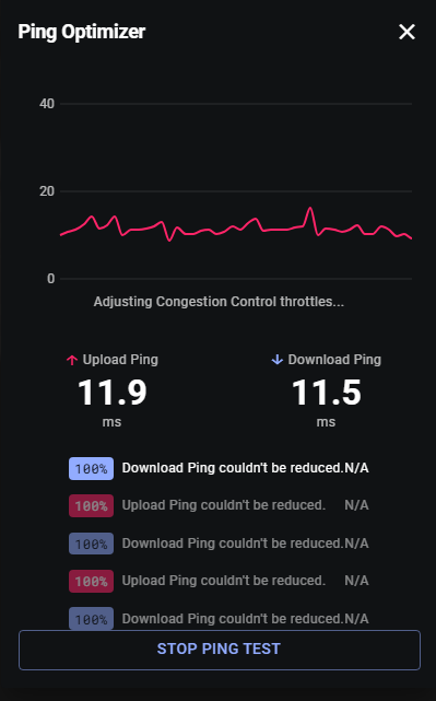

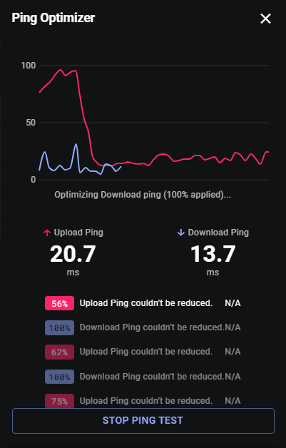

TallTales Posted June 12, 2025 Posted June 12, 2025 Need help, ping optimizer couldn't reduce my upload and download ping. How to troubleshoot?
Administrators Netduma Fraser Posted June 12, 2025 Administrators Posted June 12, 2025 We're aware the test isn't 100% reliable at the moment, use a bufferbloat test and adjust the Congestion Control percentages manually to achieve the same effect TallTales 1
TallTales Posted June 12, 2025 Author Posted June 12, 2025 6 minutes ago, Netduma Fraser said: We're aware the test isn't 100% reliable at the moment, use a bufferbloat test and adjust the Congestion Control percentages manually to achieve the same effect How to? for the layman. Thanks lol
Administrators Netduma Fraser Posted June 12, 2025 Administrators Posted June 12, 2025 Follow this guide https://support.netduma.com/frequently-asked-questions/legacyfaqs/test-your-ping/ while downloading & start with 95% for Congestion Control (set to Always), check results, decrease by 10%, check, decrease by 10% etc, until you get to a value that is pretty good & then try 5% either side of that value to see if it can be improved. Download & Upload on Congestion Control don't have to be the same value & you may have a better experience with differing values. TallTales 1
