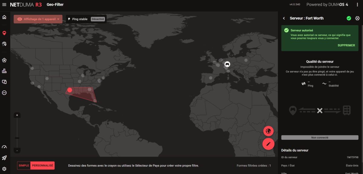

Jeremih13 Posted April 16, 2025 Posted April 16, 2025 Bonjour, J'ai reçu le Netduma hier. Pourquoi lorsque je positionne le Geofence dans dans quelques régions de s Etats-Unis (pour Call of Duty), je me retrouve encore localisé en France Allemagne, et Ireland ? Je vous remercie

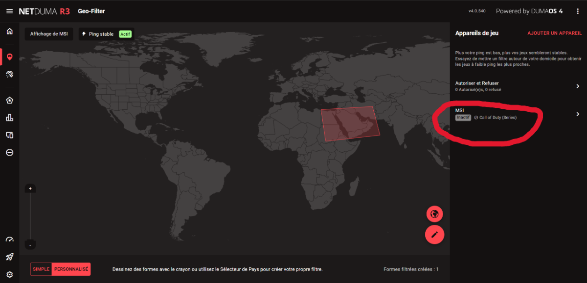

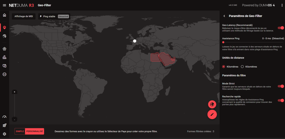

Jeremih13 Posted April 17, 2025 Author Posted April 17, 2025 Bonjour, J'ai effectué toutes les manipulations, avant d'allumer Call of Duty, Je me suis localisé en Arabie Saoudite et en Egypte et voici ce qu'il se passe en capture d'écran. Pourquoi ? Merci.
Administrators Netduma Fraser Posted April 17, 2025 Administrators Posted April 17, 2025 You have Geo-Latency enabled, this needs to be disabled, you also have fast search on which needs to be disabled. Can you show how you've added the device as well please?

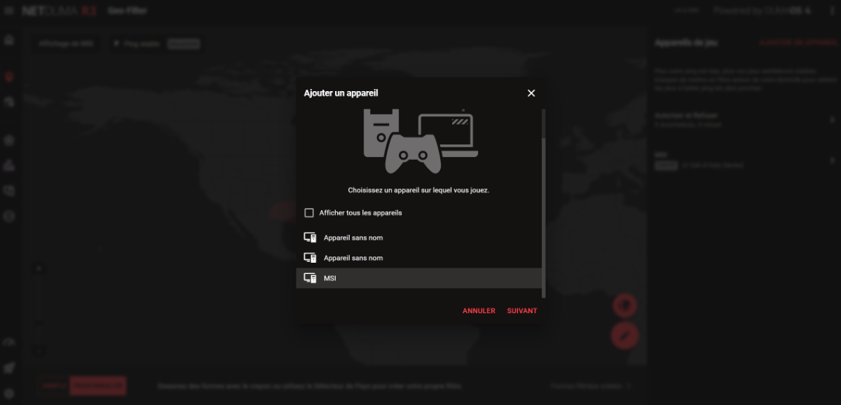

Jeremih13 Posted April 17, 2025 Author Posted April 17, 2025 Ok merci pour les conseils. Est-ce que ces capture d'écran correspondent à votre question ?
Administrators Netduma Fraser Posted April 17, 2025 Administrators Posted April 17, 2025 Yes that's good thank you, do this: Quit the application/game/client completely Remove device from the Geo-Filter Give PC PlayStation Device Type in the Device Manager Resync from the Geo-Filter Map menu Re-add the device to the Geo-Filter Set up the Geo-Filter how you like Wait 2 minutes Boot up application/game/client Then see if it works better please.

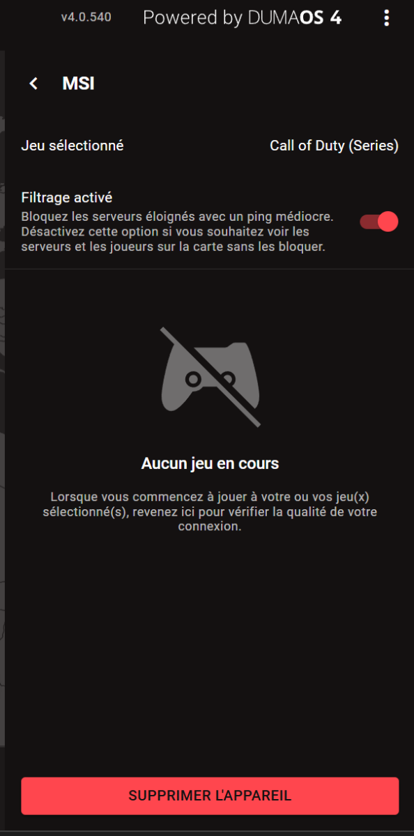

Jeremih13 Posted April 18, 2025 Author Posted April 18, 2025 J'ai effectué toutes manipulation, j'ai lancé le jeu depuis plusieurs minutes, le Geofence mentionne que mon PC (MSI) est inactif... .
Administrators Netduma Fraser Posted April 18, 2025 Administrators Posted April 18, 2025 It doesn't appear you've done the process above as it still shows Call of Duty series, double check you've done the above steps. If you have then delete it from the Geo-Filter and re-add it again and select the recommended option.
Jeremih13 Posted April 18, 2025 Author Posted April 18, 2025 En remettant l'appareil, j'ai sélectionné Call of duty, il ne faut pas ? (à l'étape 5)
Administrators Netduma Fraser Posted April 18, 2025 Administrators Posted April 18, 2025 No, if you've changed your PC to a PlayStation then when you add it to the Geo-Filter you should select the device and the only thing you can do is click finish. In some cases if will give you the option recommended or manual, if you do get that option then choose recommended.
