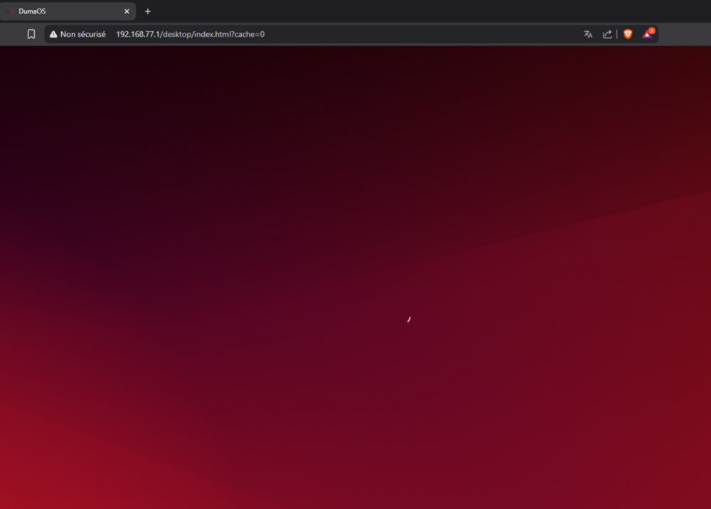

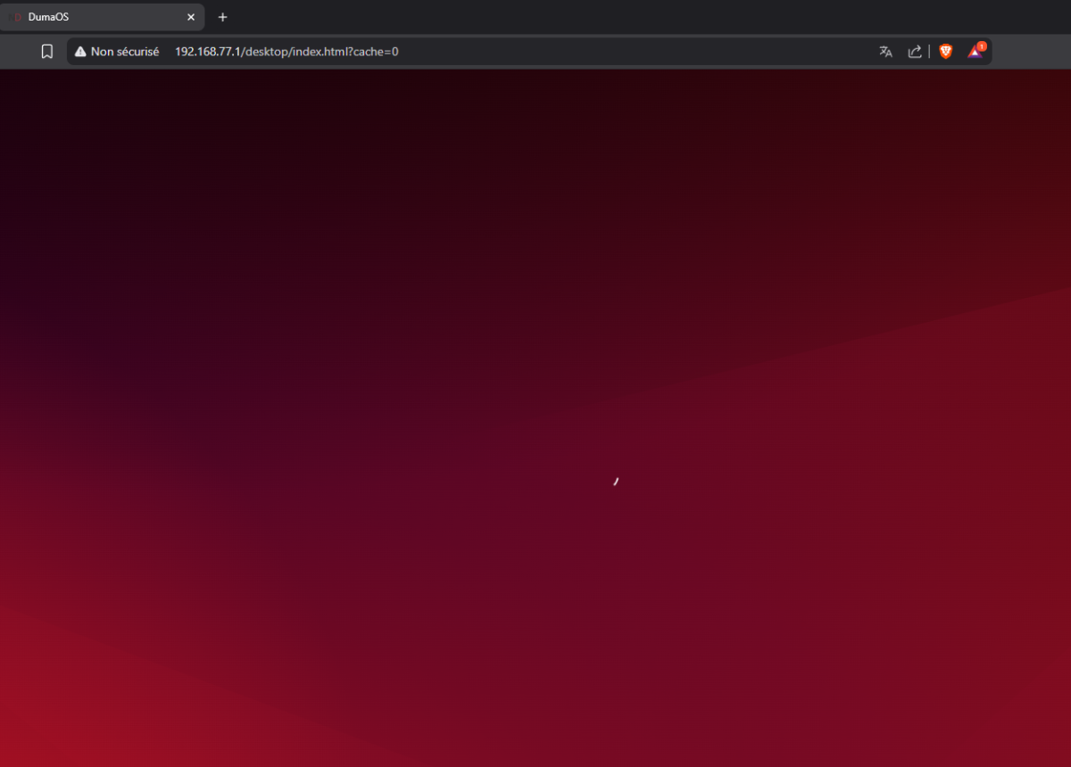

Thechamp220 Posted April 19 Author Posted April 19 Par contre j'ai mis dumaOS 3.3 et j'atterris sur l'interface web mobile, ça me propose l'interface pc quand je clique sur ok, ça charge puis fais crash le routeur, je ne peux donc plus rien flasher, j'ai déjà cold reboot et j'ai déjà clique sur le bouton reset du netduma, qu'est-ce que je peux faire ?
Administrators Netduma Fraser Posted April 19 Administrators Posted April 19 45 minutes ago, Thechamp220 said: Par contre j'ai mis dumaOS 3.3 et j'atterris sur l'interface web mobile, ça me propose l'interface pc quand je clique sur ok, ça charge puis fais crash le routeur, je ne peux donc plus rien flasher, j'ai déjà cold reboot et j'ai déjà clique sur le bouton reset du netduma, qu'est-ce que je peux faire ? It changes to a different URL which may be why, use http://dumaos instead and see if that works
Administrators Netduma Fraser Posted April 19 Administrators Posted April 19 Are you connected to the R2 via WiFi or ethernet in that scenario?

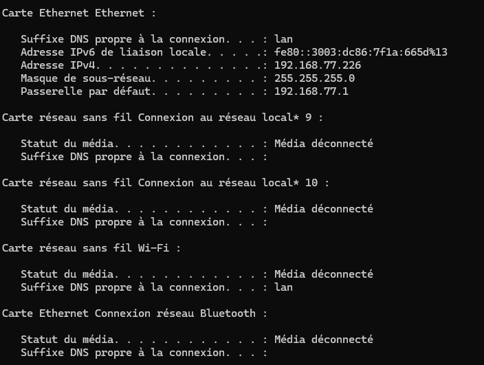

Administrators Netduma Fraser Posted April 21 Administrators Posted April 21 When it happens again and while connected to the router via a wired Windows PC, open command prompt, type ipconfig press enter and then post a screenshot of the results here please.
Administrators Netduma Fraser Posted October 21 Administrators Posted October 21 Could you disable the Brave adblocker for the page, refresh and see if it loads then please?
Thechamp220 Posted November 4 Author Posted November 4 I've just tried with default firefox and still same thing
Administrators Netduma Fraser Posted November 4 Administrators Posted November 4 On the Firefox settings go to: Click the menu button and select Settings. Select Privacy & Security from the left menu. Scroll down to HTTPS-Only Mode. Use the radio button to select Don't enable HTTPS-Only Mode Are you able to access the interface after reloading the browser then?
Administrators Netduma Fraser Posted 20 hours ago Administrators Posted 20 hours ago Can you access using the web browser on your phone?
