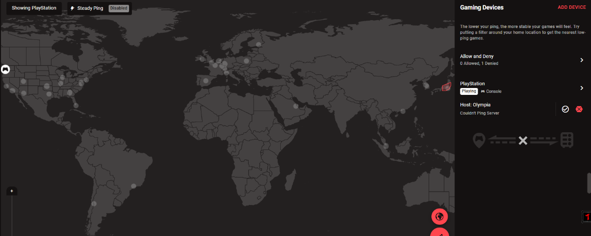

Jiachen Dai Posted April 27 Share Posted April 27 Hi, I am new user for Netduma R3, I got it on 25th, April. When I use it I update to newest. And it works really good on Friday, I can use map to choose jPN then I can play it, but in next day I can't do that anymore, even if I use map Geo-Filter to choose JPN or Korean, when I open my COD BO6 on PS5, it still choose far me in USA servers and its 86 ping. I can do nothing, so I need help! and this is problem one. Problem two is: I test my router is download on 746.3 so It should be around 84.625 MB/S, but in the steam or other game or on my PS5 only speed have 1/4, so I don't know why? Problem 3 is also on Friday I can use map Geo-Fliter at the same time I can also use gaming vpn on my PS5, in Saturday when I use Geo-Fliter to choose JPN(it not work) and also I use gaming vpn to choose JPN, and in bo6 my ping is above 235 ping. That's wired, the reason is when I conncet to JPN directly, it should be 105-115 ping. So I don't know its vpn's problem or Geo-Fliter problem, and also I can't open my VPN menu to choose which servers,until I use my another router then it works. So I need help on these 3 Pronlem. And this map I don't know why its not full, because we can see the Korean but there is no JPN servers, only when I can see JPN is when I get my R3 in first day. Link to comment Share on other sites More sharing options...
Administrators Netduma Fraser Posted April 27 Administrators Share Posted April 27 4 hours ago, Jiachen Dai said: Hi, I am new user for Netduma R3, I got it on 25th, April. When I use it I update to newest. And it works really good on Friday, I can use map to choose jPN then I can play it, but in next day I can't do that anymore, even if I use map Geo-Filter to choose JPN or Korean, when I open my COD BO6 on PS5, it still choose far me in USA servers and its 86 ping. I can do nothing, so I need help! and this is problem one. Problem two is: I test my router is download on 746.3 so It should be around 84.625 MB/S, but in the steam or other game or on my PS5 only speed have 1/4, so I don't know why? Problem 3 is also on Friday I can use map Geo-Fliter at the same time I can also use gaming vpn on my PS5, in Saturday when I use Geo-Fliter to choose JPN(it not work) and also I use gaming vpn to choose JPN, and in bo6 my ping is above 235 ping. That's wired, the reason is when I conncet to JPN directly, it should be 105-115 ping. So I don't know its vpn's problem or Geo-Fliter problem, and also I can't open my VPN menu to choose which servers,until I use my another router then it works. So I need help on these 3 Pronlem. And this map I don't know why its not full, because we can see the Korean but there is no JPN servers, only when I can see JPN is when I get my R3 in first day. Disable Geo-Latency and keep Ping Assist at 0, that should keep servers within your radius only. Don't change Geo-Filter settings while on the game and make sure it is enabled before you launch the game. What do you get on speedtest.net via a wired PC? When using a VPN you will get a higher ping, especially if you are choosing a far away router. I don't know what VPN menu to choose server means exactly Link to comment Share on other sites More sharing options...
Jiachen Dai Posted April 27 Share Posted April 27 9 minutes ago, Netduma Fraser said: Disable Geo-Latency and keep Ping Assist at 0, that should keep servers within your radius only. Don't change Geo-Filter settings while on the game and make sure it is enabled before you launch the game. What do you get on speedtest.net via a wired PC? When using a VPN you will get a higher ping, especially if you are choosing a far away router. I don't know what VPN menu to choose server means exactly I got full speed on speedtest.net when I use wired pc. and I will try you said dlasble Geo-Latency and Ping Assist, and the three is I can direct use vpn start but I can't choose vpn servers such as I want to choose JPN-001 because this one might be low ping than others, but when I use Netduma I can't do this. But I will try you said on 1, then I will give you the reply. Thank you. Link to comment Share on other sites More sharing options...
Administrators Netduma Fraser Posted April 27 Administrators Share Posted April 27 41 minutes ago, Jiachen Dai said: I got full speed on speedtest.net when I use wired pc. and I will try you said dlasble Geo-Latency and Ping Assist, and the three is I can direct use vpn start but I can't choose vpn servers such as I want to choose JPN-001 because this one might be low ping than others, but when I use Netduma I can't do this. But I will try you said on 1, then I will give you the reply. Thank you. As long as you're getting expected speeds that way then the router won't be limiting you, you can ignore the inbuilt speed test and enter your speeds manually. Oh I see, on HybridVPN as you need to use a configuration file so that it can be compatible with multiple VPNs we couldn't provide an option to select the server. You'll need to download the new config for the other server you want to connect to then enter it into the router. Link to comment Share on other sites More sharing options...
Jiachen Dai Posted April 27 Share Posted April 27 2 minutes ago, Netduma Fraser said: 只要您通过这种方式获得预期速度,路由器就不会限制您的速度,您可以忽略内置速度测试并手动输入速度。哦,我明白了,在 HybridVPN 上,由于您需要使用配置文件才能兼容多个 VPN,所以我们无法提供选择服务器的选项。您需要下载要连接的其他服务器的新配置,然后将其输入路由器。 No I am not use Hybrid vpn, I use the software to control it and then share to my PS5, I will try Disable Geo-Latency and keep Ping Assist at 0 and then tomorrow I will give you reply Netduma Fraser 1 Link to comment Share on other sites More sharing options...
Administrators Netduma Fraser Posted April 27 Administrators Share Posted April 27 53 minutes ago, Jiachen Dai said: No I am not use Hybrid vpn, I use the software to control it and then share to my PS5, I will try Disable Geo-Latency and keep Ping Assist at 0 and then tomorrow I will give you reply Oh okay, then your Geo-Filter settings are probably blocking the other servers Link to comment Share on other sites More sharing options...
Jiachen Dai Posted April 28 Share Posted April 28 21 hours ago, Netduma Fraser said: Oh okay, then your Geo-Filter settings are probably blocking the other servers Hi, I try your said on 1. but my map that I circle JPN, it still connect to my country servers. Even if I disable it, I disable the ping assist and steady ping already and I already restart my ps5 , but still like this. I don't know why it always connect I disable servers. So what can I do? May I try the early access? I test the speed on speedtest.net its lower than router and also its lower than my other router to test both. Link to comment Share on other sites More sharing options...
Administrators Netduma Fraser Posted April 28 Administrators Share Posted April 28 17 minutes ago, Jiachen Dai said: Hi, I try your said on 1. but my map that I circle JPN, it still connect to my country servers. Even if I disable it, I disable the ping assist and steady ping already and I already restart my ps5 , but still like this. I don't know why it always connect I disable servers. So what can I do? May I try the early access? I test the speed on speedtest.net its lower than router and also its lower than my other router to test both. Geo-Latency needs to be disabled, the Geo-Filter should be enabled before launching the game and don't change Geo-Filter settings when you're on the game already. Enter your expected speeds in manually and try again - ignore the built in speed test. I've given you access https://forum.netduma.com/forum/151-netduma-r3-early-access/ Link to comment Share on other sites More sharing options...
Jiachen Dai Posted April 28 Share Posted April 28 6 minutes ago, Netduma Fraser said: Geo-Latency needs to be disabled, the Geo-Filter should be enabled before launching the game and don't change Geo-Filter settings when you're on the game already. Enter your expected speeds in manually and try again - ignore the built in speed test. I've given you access https://forum.netduma.com/forum/151-netduma-r3-early-access/ I did like you said"Geo-Latency needs to be disabled, the Geo-Filter should be enabled before launching the game and didn't change Geo-Fliter" Even if I do change I will restart my PS5 and the game. Link to comment Share on other sites More sharing options...
Administrators Netduma Fraser Posted April 28 Administrators Share Posted April 28 45 minutes ago, Jiachen Dai said: I did like you said"Geo-Latency needs to be disabled, the Geo-Filter should be enabled before launching the game and didn't change Geo-Fliter" Even if I do change I will restart my PS5 and the game. And it's still allowing everything outside? Have you made a traffic rule to allow ALL traffic to the console? Link to comment Share on other sites More sharing options...
Jiachen Dai Posted April 28 Share Posted April 28 27 minutes ago, Netduma Fraser said: And it's still allowing everything outside? Have you made a traffic rule to allow ALL traffic to the console? Yes, its still like this and I don't do anything on traffic rule, just like the factory setting, because the first day I got the router, everything is fine. Link to comment Share on other sites More sharing options...
Administrators Netduma Fraser Posted April 28 Administrators Share Posted April 28 22 minutes ago, Jiachen Dai said: Yes, its still like this and I don't do anything on traffic rule, just like the factory setting, because the first day I got the router, everything is fine. If you click on the console on the Geo-Filter, is filtering actually toggled on? Link to comment Share on other sites More sharing options...

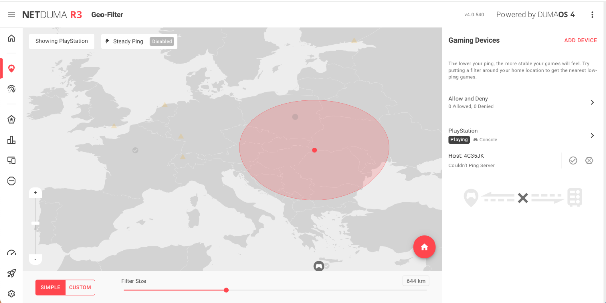

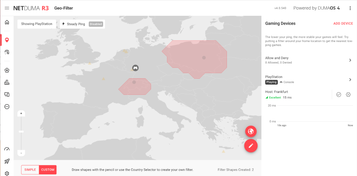

razvanth21 Posted April 29 Share Posted April 29 Hi. I set up my R3 router today and wanted to give a try to the GeoFiltering feature. However, I've set some custom filtering (see the screenshot), but the game will still connect to servers outside the filtered area. Disabling geo-latency will then fail to establish the connection to the server (i.e. the game kicks me after finding opponent). The game is EAFC25. DumaOS sees the Zurich server as the best. Also, the internet speed via speedtest is lower than what I was getting with my old router (from 1Gbps to 500Mbps both download and upload). Can you advise here? More, the ping from the DumaOS is much lower than the one I get in game. Thanks! Edit: I've tweaked with the settings and I ended with some unrecognized server in Greece (don't think there is an actual one there). Geo-Latency was off this time with strict mode OFF. edit2: Seems like I was doing it wrongly, while having the game open. Geofiltering works, but speed test is still showing lower speeds than usual. Link to comment Share on other sites More sharing options...
Administrators Netduma Fraser Posted April 29 Administrators Share Posted April 29 2 hours ago, razvanth21 said: Hi. I set up my R3 router today and wanted to give a try to the GeoFiltering feature. However, I've set some custom filtering (see the screenshot), but the game will still connect to servers outside the filtered area. Disabling geo-latency will then fail to establish the connection to the server (i.e. the game kicks me after finding opponent). The game is EAFC25. DumaOS sees the Zurich server as the best. Also, the internet speed via speedtest is lower than what I was getting with my old router (from 1Gbps to 500Mbps both download and upload). Can you advise here? More, the ping from the DumaOS is much lower than the one I get in game. Thanks! Edit: I've tweaked with the settings and I ended with some unrecognized server in Greece (don't think there is an actual one there). Geo-Latency was off this time with strict mode OFF. edit2: Seems like I was doing it wrongly, while having the game open. Geofiltering works, but speed test is still showing lower speeds than usual. Glad you were able to sort out your Geo-Filter issue. For speeds, ignore the inbuilt speed test and manually input your expected/paid for speeds. What is the model of the modem/router the R3 is connected to and how have you set that to ensure all traffic flows to the R3? E.g R3 in its DMZ, modem/bridge mode Do you have ALL devices connected to the R3 or some still connected to the ISP modem/router? Link to comment Share on other sites More sharing options...
razvanth21 Posted April 29 Share Posted April 29 1 hour ago, Netduma Fraser said: Glad you were able to sort out your Geo-Filter issue. For speeds, ignore the inbuilt speed test and manually input your expected/paid for speeds. What is the model of the modem/router the R3 is connected to and how have you set that to ensure all traffic flows to the R3? E.g R3 in its DMZ, modem/bridge mode Do you have ALL devices connected to the R3 or some still connected to the ISP modem/router? Thanks for the reply. The ISP provided a ZTE F6605R modem which is capable of 2.5Gb. My internet plan is aswell 2.3Gbit. The modem is already in a bridge-mode configuration, so no more devices are connected to it. Only one MacBook is connected to the R3 router, an additional ASUS AX82U via Ethernet (currently set in AP mode) and my PS5 via Ethernet. The test I did was not the inbuilt one, but an external one and the latest results I got were 500Mbps DL and 800Mbps UP. Link to comment Share on other sites More sharing options...
Administrators Netduma Fraser Posted April 29 Administrators Share Posted April 29 1 hour ago, razvanth21 said: Thanks for the reply. The ISP provided a ZTE F6605R modem which is capable of 2.5Gb. My internet plan is aswell 2.3Gbit. The modem is already in a bridge-mode configuration, so no more devices are connected to it. Only one MacBook is connected to the R3 router, an additional ASUS AX82U via Ethernet (currently set in AP mode) and my PS5 via Ethernet. The test I did was not the inbuilt one, but an external one and the latest results I got were 500Mbps DL and 800Mbps UP. You've set the speeds on the R3 to 1000/1000 presumably? Did you do the speed test via WiFi or via ethernet connected to the Asus? Link to comment Share on other sites More sharing options...
