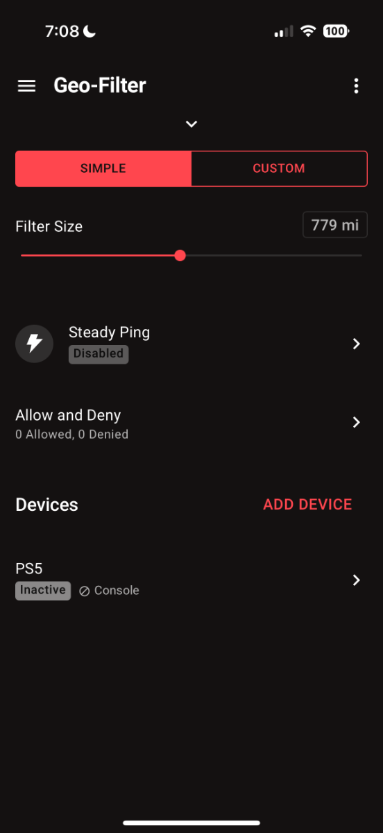

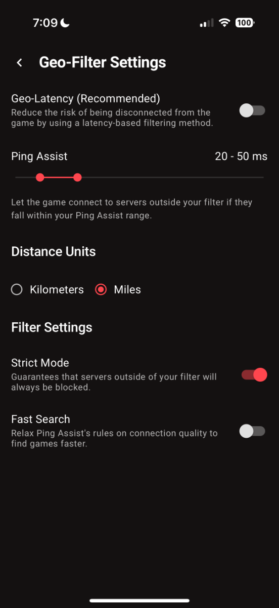

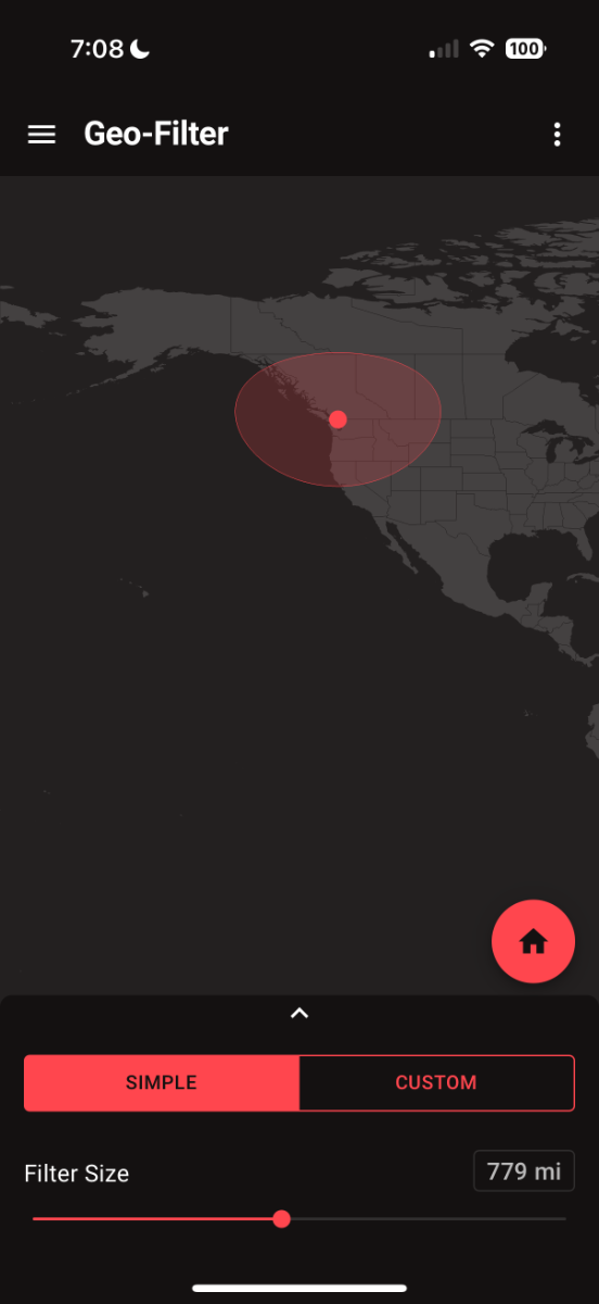

Kevin.pal Posted June 13 Posted June 13 Have been experiencing some glitches with R3 Smartboost not saving or maybe not working properly Call of duty geo filter not working getting ping increases in game 40-200ms my connection is stable and my geo filter setting are where it should be paying for something that doesn’t really perform that well for me is very disappointing. I have used netduma for a very long time. I'm frustrated here ScreenRecording_06-13-2025 07-02-51_1.mov
Administrators Netduma Fraser Posted June 13 Administrators Posted June 13 9 hours ago, Dean.L said: can i ask what the two big features are ? We've breifly mentioned Adaptive Congestion Control and the other one I don't think we've mentioned so I won't be able to say just yet 15 minutes ago, Kevin.pal said: Have been experiencing some glitches with R3 Smartboost not saving or maybe not working properly Call of duty geo filter not working getting ping increases in game 40-200ms my connection is stable and my geo filter setting are where it should be paying for something that doesn’t really perform that well for me is very disappointing. I have used netduma for a very long time. I'm frustrated here On SmartBOOST you've removing the priorities and then switching screens way too fast, remove them, wait for the undo popups to disappear, then switch pages and back again and you'll see it has saved. Disable Ping Assist, that's why you're getting those higher pings.
