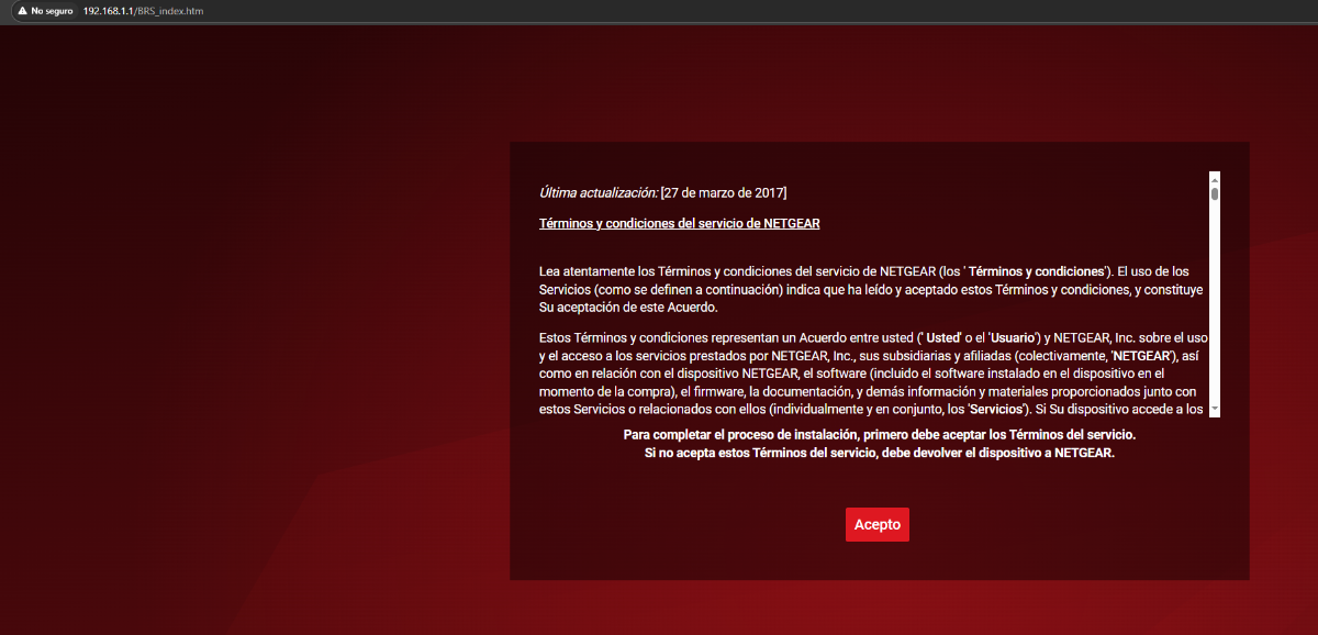

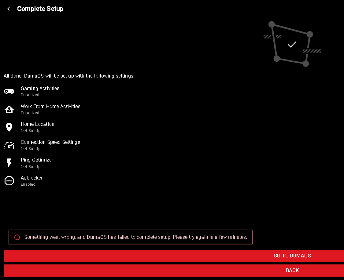

Administrators Netduma Fraser Posted June 28, 2025 Administrators Posted June 28, 2025 21 minutes ago, IITazII said: no How are you doing it, via the interface or the big physical button? I suspect it's losing power in that case if you're not unplugging it or factory resetting it from the pin or interface. Is it connected to an extender or direct to an outlet?
IITazII Posted June 28, 2025 Posted June 28, 2025 10 minutes ago, Netduma Fraser said: How are you doing it, via the interface or the big physical button? I suspect it's losing power in that case if you're not unplugging it or factory resetting it from the pin or interface. Is it connected to an extender or direct to an outlet? I tried both ways but it keeps resetting to factory settings. The problem is that it doesn't save the settings after starting the router.
Administrators Netduma Fraser Posted June 28, 2025 Administrators Posted June 28, 2025 1 hour ago, IITazII said: I tried both ways but it keeps resetting to factory settings. The problem is that it doesn't save the settings after starting the router. It must be losing power then during the reboot, I don't see any other reason why that would be happening, do you have it connected to an extender or direct to an outlet? Do you have another power adapter with similar voltage you can use to test?
