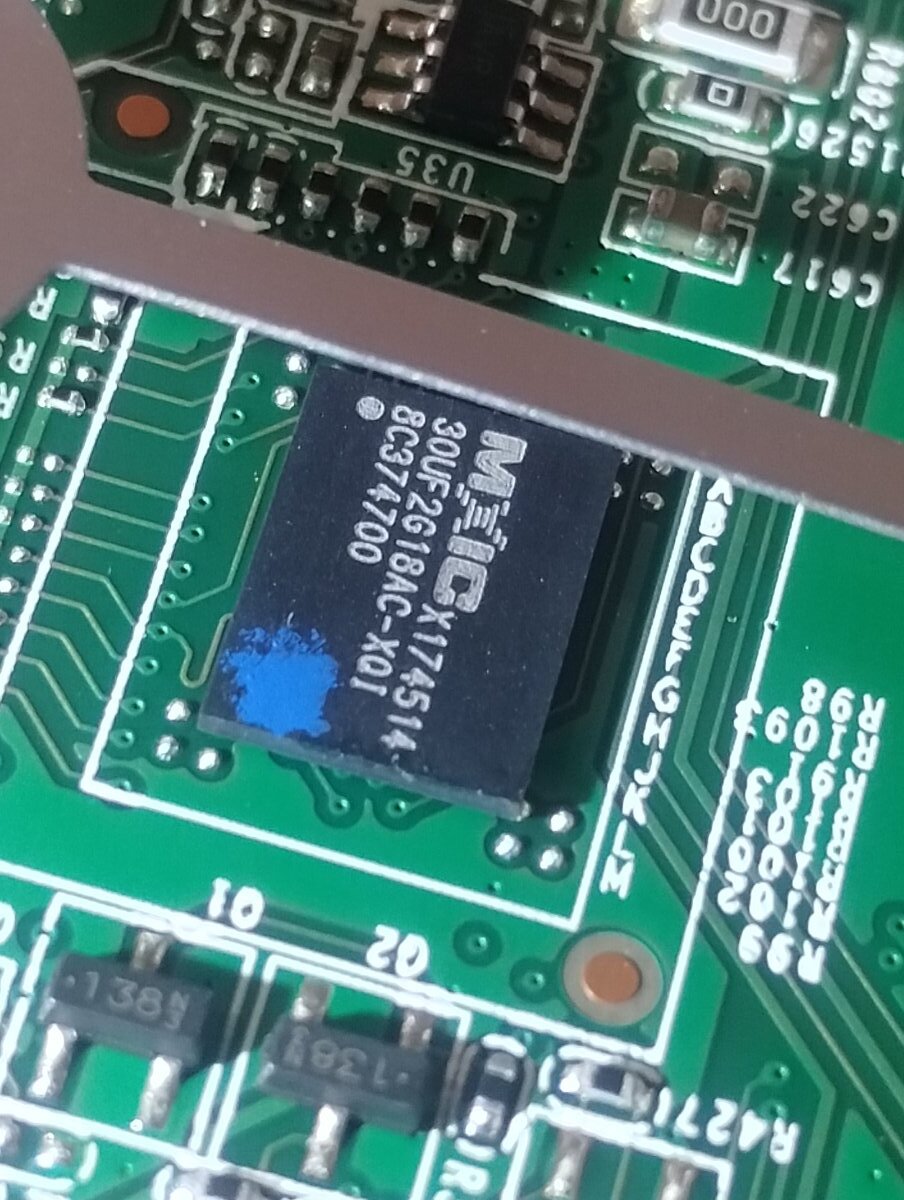

PurpleHaze Posted June 24 Posted June 24 I decided to factory reset it and give it one more go, I done it from the GUI (I assume this was my mistake) it did nothing for agers but flashed lights so tried to do it from the reset button again did nothing. After around what felt like an hour powered down the router and powered it back up but now I only get a USB light and if the eth cable is in the eth light. Think I bricked it? Can't flash with tftpd, opened it up to get at the j1 pins and I have no serial output either so I assume it's not even attempting a boot because the interrupted factory reset? I'm assuming the USB light means nothing not that it wants a usb connection or firmware on USB?
Administrators Netduma Fraser Posted June 24 Administrators Posted June 24 41 minutes ago, PurpleHaze said: I decided to factory reset it and give it one more go, I done it from the GUI (I assume this was my mistake) it did nothing for agers but flashed lights so tried to do it from the reset button again did nothing. After around what felt like an hour powered down the router and powered it back up but now I only get a USB light and if the eth cable is in the eth light. Think I bricked it? Can't flash with tftpd, opened it up to get at the j1 pins and I have no serial output either so I assume it's not even attempting a boot because the interrupted factory reset? I'm assuming the USB light means nothing not that it wants a usb connection or firmware on USB? That does sound in brick teritory, no the USB port has no functional benefit in this situation, TFTP will be your only hope here, don't give up with it, the timing for it is tricky and can take a few attempts PurpleHaze 1
PurpleHaze Posted June 24 Posted June 24 59 minutes ago, Netduma Fraser said: That does sound in brick teritory, no the USB port has no functional benefit in this situation, TFTP will be your only hope here, don't give up with it, the timing for it is tricky and can take a few attempts Yeah I tried a lot, pretty disappointed in myself as I feel like as tho the reset was hanging I did interrupt it or do something wrong. I tried with ftpd64 and the nmrpflash but the no URAT (to me anyway) suggest that the uboot is corrupted and I don't think tftpd will be a an option at this stage as it's not getting to the sage where it can take it. I messaged a couple repair shops that do spi flashing and hopefully one can just reflash the right chip. I got a soic 8 clip from another project but I don't think it will be much help? Your not able to provide info on the chip that stores the uboot that would need a reflash are you? Cause it would probably be cheaper for me if I can tell them/ point then in the right direction of what chip needs to be done. Hopefully they don't need to pull one from an another XR500 cause I would then need to pay to source it. They still fetch $200+ here 150+ second hand with postage was hoping illd find a cheap one to save the hassle of sending it off.
Administrators Netduma Fraser Posted June 24 Administrators Posted June 24 27 minutes ago, PurpleHaze said: Yeah I tried a lot, pretty disappointed in myself as I feel like as tho the reset was hanging I did interrupt it or do something wrong. I tried with ftpd64 and the nmrpflash but the no URAT (to me anyway) suggest that the uboot is corrupted and I don't think tftpd will be a an option at this stage as it's not getting to the sage where it can take it. I messaged a couple repair shops that do spi flashing and hopefully one can just reflash the right chip. I got a soic 8 clip from another project but I don't think it will be much help? Your not able to provide info on the chip that stores the uboot that would need a reflash are you? Cause it would probably be cheaper for me if I can tell them/ point then in the right direction of what chip needs to be done. Hopefully they don't need to pull one from an another XR500 cause I would then need to pay to source it. They still fetch $200+ here 150+ second hand with postage was hoping illd find a cheap one to save the hassle of sending it off. Unfortunately can't provide that information even if I had it, NG sorted the hardware so we didn't have any input, like you said the R7800 is similar so perhaps that part which I'm sure can be found cheaper might be an option, no idea if it would work though honestly, no one has ever gone to that much trouble to repair one as far as I'm aware or if they have they've never mentioned it PurpleHaze 1
PurpleHaze Posted June 25 Posted June 25 7 hours ago, Netduma Fraser said: Unfortunately can't provide that information even if I had it, NG sorted the hardware so we didn't have any input, like you said the R7800 is similar so perhaps that part which I'm sure can be found cheaper might be an option, no idea if it would work though honestly, no one has ever gone to that much trouble to repair one as far as I'm aware or if they have they've never mentioned it Good idea thanks for that. Might be worth a shot. Netduma Fraser 1
PurpleHaze Posted June 25 Posted June 25 The chip is if anyone wants to know, at least on mine is a MXICx174514 30uf2618AC-XOI 8C374700 Its under the big heat sync on the bottom held in place by dimples, can be tricky to open. This requires a nand flash not SPI, so support may be limited, unfortunately you can (I don't think) get a flash clip onto it. Will require desoldering and flashing best done by a professional experienced micro solder.

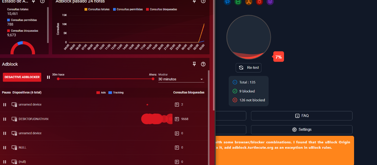

IITazII Posted June 26 Posted June 26 I have noticed that currently adblock does not work. and the battlefield is not detected by the QOS
Administrators Netduma Fraser Posted June 26 Administrators Posted June 26 6 hours ago, IITazII said: I have noticed that currently adblock does not work. and the battlefield is not detected by the QOS No working for all devices, specific pages etc? As in DumaOS Classified Games isn't activating when playing or after having added it manually?
IITazII Posted June 26 Posted June 26 5 hours ago, Netduma Fraser said: No working for all devices, specific pages etc? As in DumaOS Classified Games isn't activating when playing or after having added it manually? In the adblocker interface, it shows that it's blocking, and when I test it on a page, it doesn't block ads. The odd thing is that it works fine on mobile. NO, even though I added the game, it doesn't detect it.
Administrators Netduma Fraser Posted June 26 Administrators Posted June 26 20 minutes ago, IITazII said: In the adblocker interface, it shows that it's blocking, and when I test it on a page, it doesn't block ads. The odd thing is that it works fine on mobile. NO, even though I added the game, it doesn't detect it. If you've disabled it recently, went to the site and then re-enabled it then it can cache and still show the ads. Check in an incognito window and see if it blocks, if it does you'll need to clear cache/cookies in your browser. Otherwise, add the page you're trying to block and check it manually then. Will let the team know the game needs updating via DPI. If you select Games Console as the service it will prioritize it in the meantime.
IITazII Posted June 26 Posted June 26 I did it and nothing, I even tried with more browsers and it doesn't work, I tried with another phone and it does work there
Administrators Netduma Fraser Posted June 26 Administrators Posted June 26 1 hour ago, IITazII said: I did it and nothing, I even tried with more browsers and it doesn't work, I tried with another phone and it does work there Can you provide a screenshot of your Adblocker page please? It does sound more like a cache issue if another device works
IITazII Posted June 27 Posted June 27 5 hours ago, Netduma Fraser said: Can you provide a screenshot of your Adblocker page please? It does sound more like a cache issue if another device works I fixed it. I went back to a previous firmware and updated to the latest one, and it worked.
IITazII Posted June 27 Posted June 27 3 hours ago, IITazII said: I fixed it. I went back to a previous firmware and updated to the latest one, and it worked. The error returned when I synced with the cloud.
Administrators Netduma Fraser Posted June 27 Administrators Posted June 27 6 hours ago, IITazII said: The error returned when I synced with the cloud. Are you just seeing it not working on that Adblocker test or also on websites where ads were previously blocked but now aren't?
IITazII Posted June 27 Posted June 27 4 hours ago, Netduma Fraser said: Are you just seeing it not working on that Adblocker test or also on websites where ads were previously blocked but now aren't? It doesn't work. I've tried it elsewhere. But, again, it doesn't work on PCs. On phones, it works perfectly. This happened when updating the cloud. In the router's web interface, it appears to be blocked, but it doesn't block ads, as you can see in the screenshot. I tried other browsers when reinstalling the firmware and it worked, but when syncing with the cloud, it stopped working.
