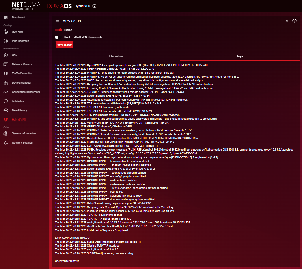

zaibkhan Posted March 30, 2023 Posted March 30, 2023 i have two vpn subscriptions express vpn is working fine only issue is with my 2nd vpn name: fastest vpn . fastest vpn was working fine on previous netduma r2 firmware . can't connect it fails it was working fine before updating to latest firmware untitled.bmp
Administrators Netduma Fraser Posted March 30, 2023 Administrators Posted March 30, 2023 16 minutes ago, zaibkhan said: i have two vpn subscriptions express vpn is working fine only issue is with my 2nd vpn name: fastest vpn . fastest vpn was working fine on previous netduma r2 firmware . can't connect it fails it was working fine before updating to latest firmware untitled.bmp 2.69 MB · 2 downloads Always best to start a new topic so we can focus on you exclusively. Can you provide the config you're using please? Did you factory reset after the upgrade as there were fixes for VPN included.

Administrators Netduma Fraser Posted March 30, 2023 Administrators Posted March 30, 2023 58 minutes ago, zaibkhan said: tcp and udp ovpn files 45 regions config files i have tested all the previous working config files on previous firmware. now its not working on current firmware Did you factory reset after the latest? Does it say failed when you try to connect? Can you provide the log from the VPN page please?
zaibkhan Posted March 30, 2023 Posted March 30, 2023 untitled.bmpyes i have factory reset after upgrade and sharing image of log

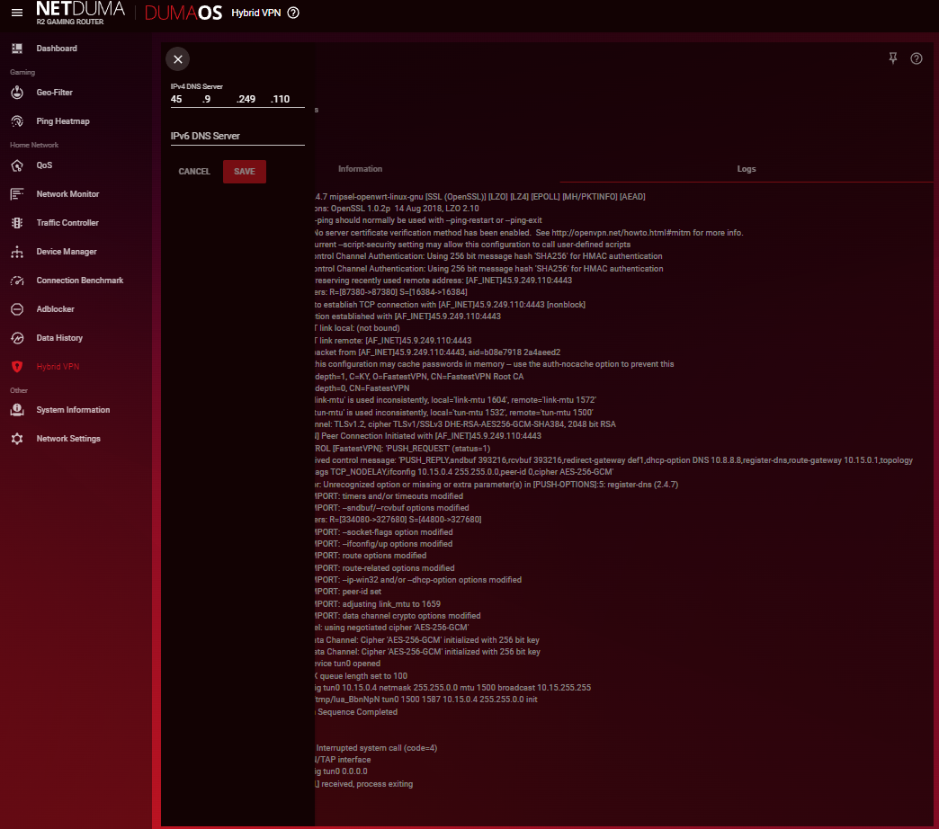

Administrators Netduma Fraser Posted March 30, 2023 Administrators Posted March 30, 2023 Could you enter the VPN IP address in the DNS on HybridVPN then try connecting again please?

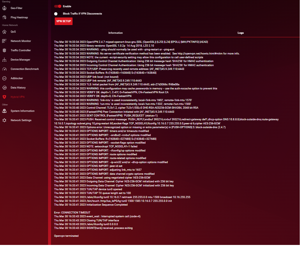

zaibkhan Posted March 30, 2023 Posted March 30, 2023 still failed shared two images, double checked even after reboot , vpn is working fine when i connect through vpn software installed on my windows 3untitled.bmp untitled.bmp
