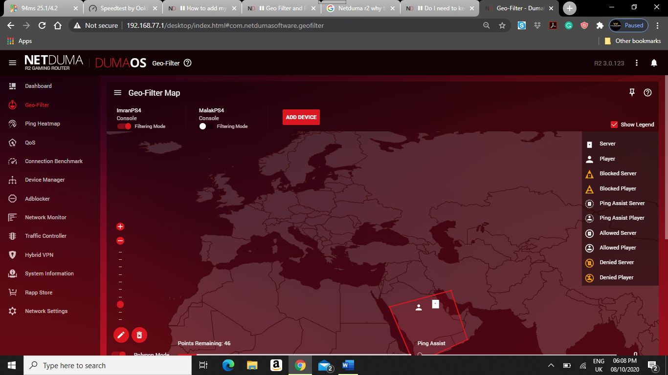

Posted
Dear I live in Bahrain next to Saudi Arabia. Polygon around entire Saudi Arabia and Bahrain. The server you are looking at in below picture is located in Saudi Arabia. I believe this is miss located server.

Where as in following image GEO-Filter is showing server in Saudi Arabia with 5ms to 7ms ping only. (most probably this is miss located server).
UY-3CYcReov5BT-birYUk9n0uTXmH4qu8BiKHsiCFLubvKCuEhlqhP_5UU7RHZWNDuch5OyMndQJ7ZpMAxGAWmFkbf6JiIB_J9A5ZM0dNbGy8YDNq0kOdyxpWTWjxcwRnW_yXoFg
All above information has been captured with STRICT mode ON and AUTO PING OFF.
